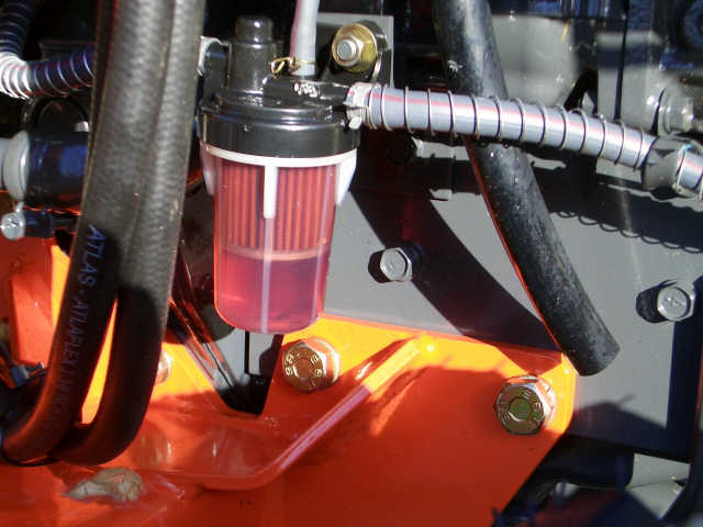

Started clearing a pathway thru the woods yesterday. When I came in and hosed off, I noticed fuel leaking from the fuel filter housing. After a bit of fussing, I determined the housing bowl was not seated correctly. Whether it was cross-threaded originally, or I bumped it working in the woods (it does seem vulnerable enough to need a shield) I have no idea. But in an attempt to stop the diesel slick from spreading, I quickly searched for a fuel shutoff upstream of the filter housing - and never did find one. I ended up pulling the inlet hose and plugging it with a nail punch while I reseated the housing bowl. Aside from the ignition selenoid, is there a manual fuel shutoff on the B7610? If yes, pardon my ignorance, where exactly is it? If no, think I'll add one ahead of the filter somewhere.

I think on my B2910 there is no shutoff, but when you take the plastic cover off there is some kind of shutoff inside, so the fues flow stops until you screw it back on...
I don't know what the mechanism is, but that is what I did when I changed my fuel filter and I did not lose much if any fuel in the process...

B7510 does not have fuel shutoff, has some kind of check valve that is supposed to stop the fuel flow when you take the bowl off, but you have to have less than 1/2 tank of fuel or an overflow hose will siphon fuel back down through the filter.
I don't know if B7610 is the same, but probably is.
Look under Fuel Filter in the Operator's Manual.

Thanks, you guys were right about the check valve. Works with 1/2 tank or less which explains why mine was gushing... I had about 3/4 full. I can't see any harm in adding an inline petcock ahead of the filter, along with a filter shield of sorts.

I'm putting up a pic of the fuel filter housing too. Any reason not to use the gray frame bolts for shield attachment points? Don't want to use the FEL bracket bolts.

There is another method to use. KD tools
Just pull the spring back on the fuel line and clamp the fuel line with these or something simular and you have an instant shutoff valve.
