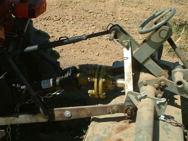

The old Yanmar RS1200 rototiller (48" wide) that I bought to use with my Kubota B7510HST had nothing-no SC, no shear bolt(s). So I had to adapt an SC from TSC.
The pto shaft that came with the tiller was shot, so I got one from TSC and cut it to fit. I had to use the longer lower 3pt arms from my MF135 tractor (36" long vs 26" for the 7510) to fit the SC and an adapter on the tiller gear box to position the SC so it didn't rub on the tiller sheet metal.
