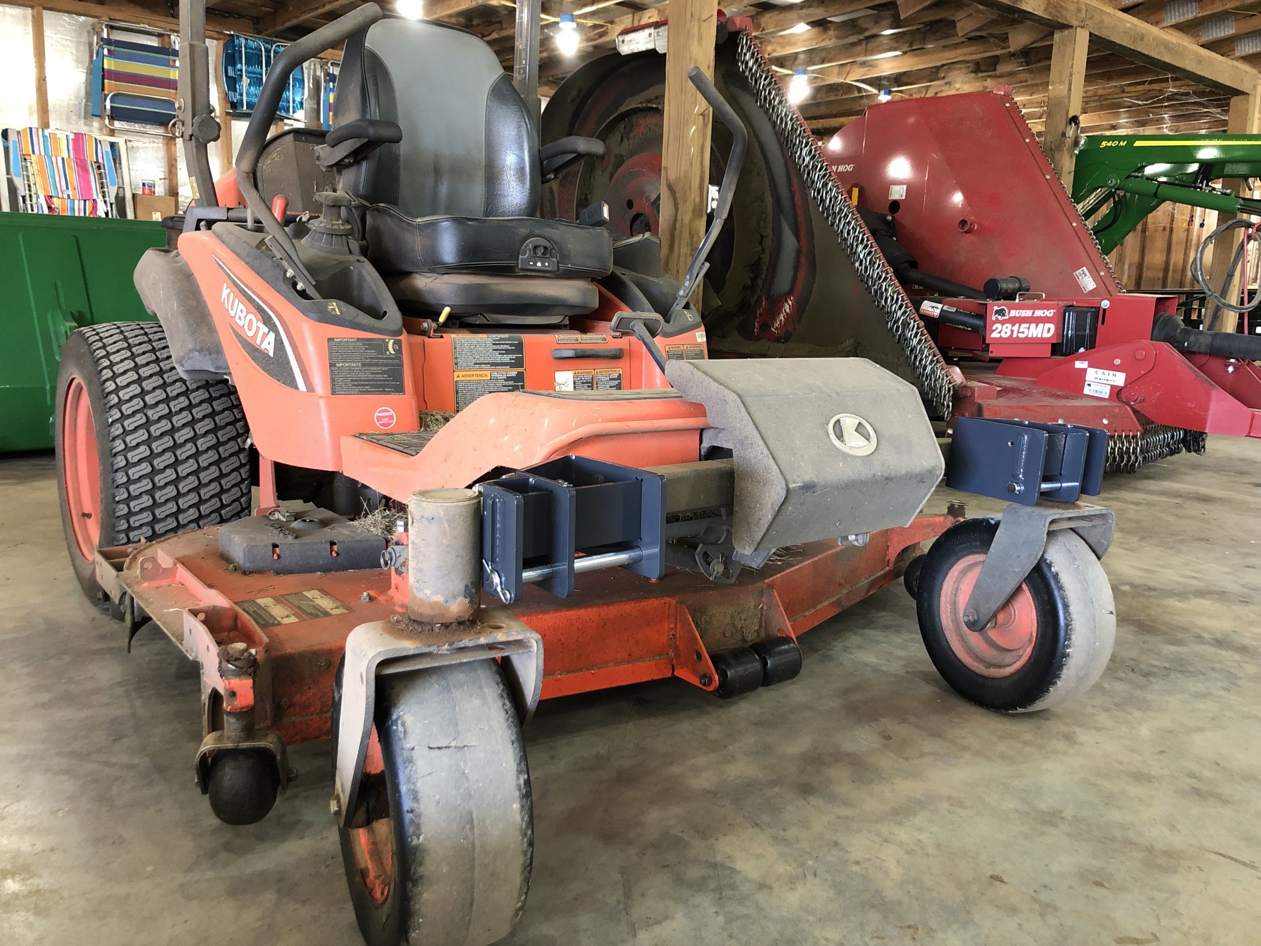

I borrowed this pic from internet.
These looks homemade ?
I can slide my seat all the way forward & hang my boots out over front axle & it makes a Huge Difference climbing my steep banks here on the farm.

Anybody out there fabbed up some front axle weights ?

   / Does Kubota offer front weights for ZD12/11 / ZD1511 ?
Front weight bracket for one side of front axle.

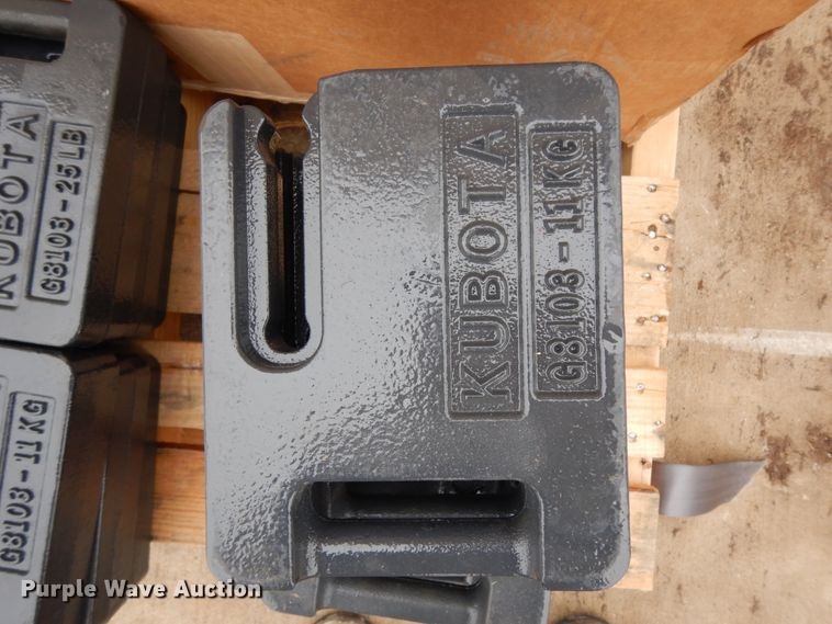

#9
G8103 25lb Suitcase Weight
Pic borrowed from InnerWeb
I’ll get an assembled pic next week when weights comes in.
I’m not running a rear grass catcher.
I need to keep front wheels on the ground mowing up really steep banks around my farm.
This isn’t subdivision lots lol
I got front axle weight brackets installed & still waiting on suitcase weights
I hadn’t had time to wash the mower yet lol
