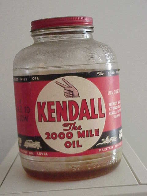

Does that mean that this quart of oil that I just poured into my engine is out of date?? /forums/images/graemlins/confused.gif /forums/images/graemlins/grin.gif /forums/images/graemlins/confused.gif /forums/images/graemlins/grin.gif
