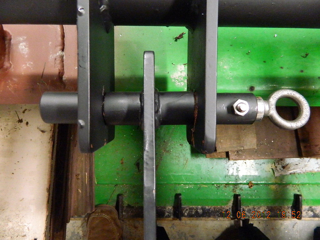

Does this blade look bent?

What do you think?
/ Does this blade look bent? #2
Not to me it doesn't.
The square tubing in the front is hanging down on the left side.

/ Does this blade look bent? #5
Looks okay from this angle.
Stand pipe should have oohhh about 3"x 3" weld on
/ Does this blade look bent? #6
Doesn't look bent, just Right side hitch is hanging lower because of normal free-play in both pivots and jackstand is off center to left.
/ Does this blade look bent? #7
Could be an illusion too, hard to tell for sure unless you really measure it. If you're looking to buy it and took the picture from the guy, it looks pretty nice and un-used to me either way. There will always be some movement at joints to allow it to move, keep that in mind with its kickstand on that one side.

Roger,
Can you lift up the side that is sagging down? Looking at the picture it appears to have more list than I would expect to see on the jack stand, I have similar jack stands on a couple of rear blades and rakes and have very little sag or play in the hitches.
/ Does this blade look bent? #9
Does it angle & tilt? It looks like a fairly beefy blade - maybe the tilt's just not adjusted square?
/ Does this blade look bent? #10
As others have mentioned, the stand is off center. There are at least a couple of points between the stand and the blade that have enough "slop" to cause the apparent offset.
Try putting a 4X4 post in the exact center of the 3PH "A" frame - maybe even under the bolt. Then see how it looks. There may be enough "slop" in that bolt to be able to very slightly rotate the "A" frame when it is supported under the bolt. It would also make hooking it up much easier.
If it were mine I'd cut off the stand and re-weld the bracket in the exact center.

Thanks for the replies. It is my blade, it is not bent. It has a little play in the tilt pin and the park stand is making it look like that. I just wanted to see what you guys thought. I have it on craigslist and it is not getting much attention. I thought people may think it is bent by the pictures.
