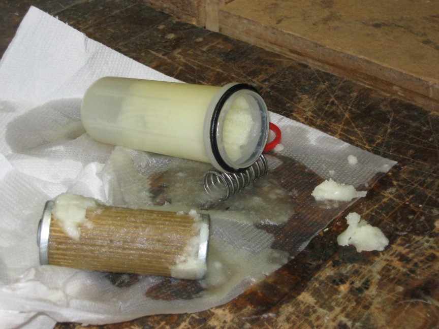

When mine did that it must had had water in the fuel. After changing the filter,adding 911 to the already power serve treated fuel. I found the metal 90 degree fitting where fuel comes out of the tank had a ice chunk. I tried to drain the fuel out of the tractor and none would come out. Be very careful about applying heat as my tank was plastic and fuel lines were rubber. Hit it for 2 seconde and try to start it. When it dies hit it again for 2 sec and try to restart. keep doing until it cleans up and runs.

Yep, I had water/ice problems with my F935...ever since then I make a habit of running a small dose of Power Service 911 in the fall before freezing weather. Regular power service is a great anti-gel, but it doesnt remove water.
Back on topic....while it could be parrafin in your filter (I change fuel filters every 100 hrs) one thing it COULD be is algae in the fuel.... Cure is the same...treat fuel, change filter, clean strainer.....if it is Algae, buy 2/3 filters as you'll need em :cool:....

I know what the problem is. We fixed a 5205 two weeks ago exhibiting the same symptoms. Turns out, poor design by Deere. You have a little water in your fuel. It is freezing in your return line. This creates back pressure on the injection pump. The tractor will start and run a few seconds until the pressure from the return line won't let the pump function properly anymore.
Relocate the return fuel line to the top of the tank.

Great to know, makes perfect sense......BUT if I had an affected machine I wouldnt be performing this fix...IMO its just a band aid...not the cure.
The true FIX for the issue is keeping water out of your fuel...regardless of return location, tractor brand, tube size, etc... you should NOT have water in your fuel. Water in the fuel could lead to many more expensive problems (smoked fuel pumps, etc)...

Some one say paraffin...
I had to clean the filter twice, the second time I opened up the fuel line and let the fuel run into a container before installing the filter again. This happened on a Sunday so I cleaned the filter and all with dry gas (TWICE) :rolleyes:.
