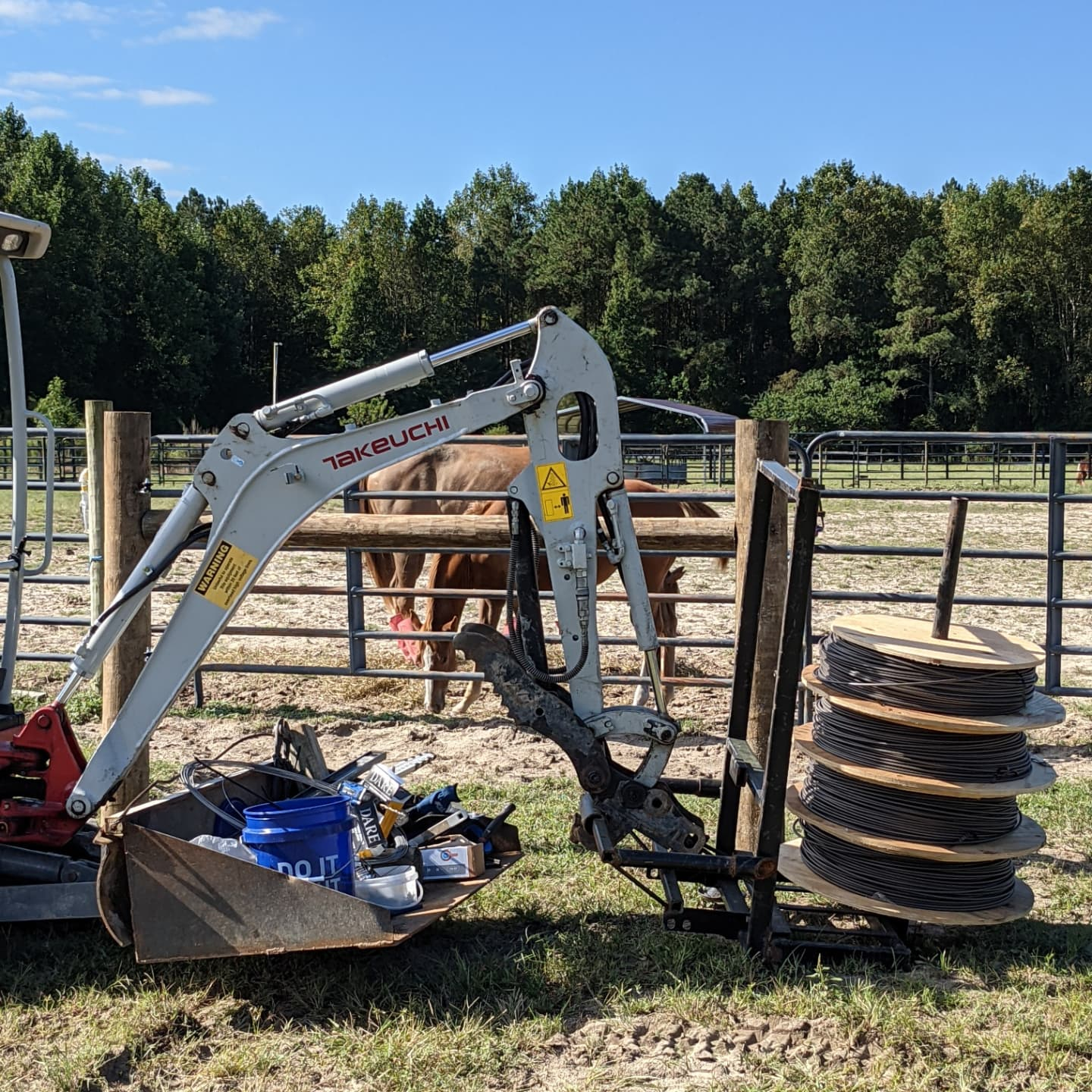

I can recommend Premier1 electric fencing; we use it to reduce pressure on the perimeter barb wire fences and to subdivide pastures, though not so far as daily pastures. They offer goat specific netting. I have a pair of reels with wire rope on them that make quick work out of a new fence line for subdividing a pasture.
I have watched the horses check that the wires are live with their muzzle hairs or herd the cows toward it to check. (Naughty horses!)
