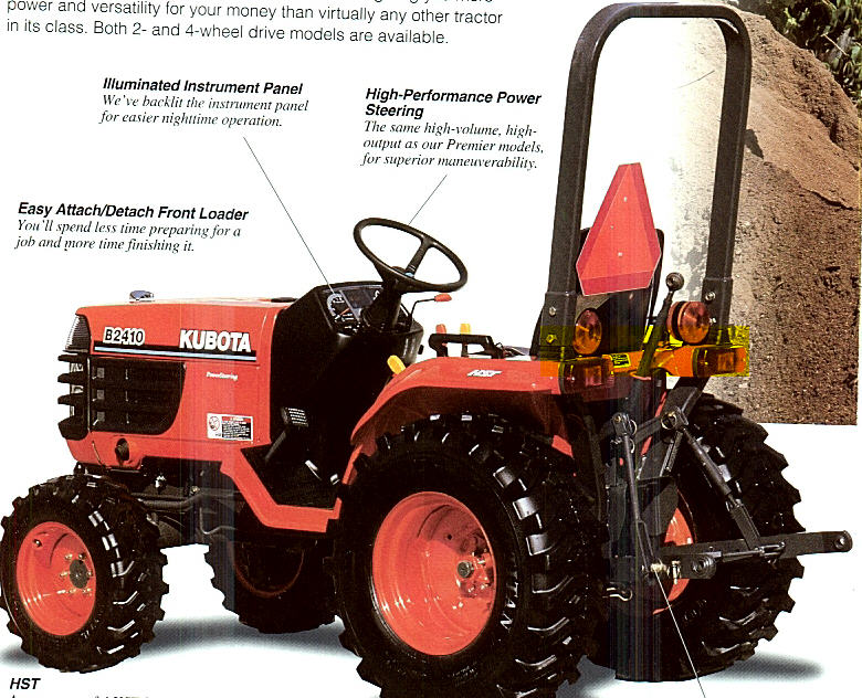

I noticed by looking at the brochure that the b2410 has a piece of sheet metal that spans the right and left rear fenders between the ROPS. Attached to it is a hook to hold the top link.
After looking at my 7500 it looks like it was designed to have this same piece but mine does not. I was thinking that my dealer left it off when he assembled my tractor.
Does your B7500 have this piece of sheet metal?

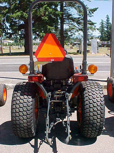

I don't have a 7500, but here is a picture of one I found on the net.

   / Does your B7500 have one of these? #3
Mine ain't got one. There was a thread about a top link holder. When mine ain't in use it's either in the garage or my front or sometimes back pocket.
   / Does your B7500 have one of these? #4
No the 7500 does not have that feature. That is the rear closeout panel I refered to in one of my examples of why I bought the 2410 vs the 7500. This panel gives the tractor a more finished look and does have the hook for the top link to stow in. You might be able to purchase this metal closeout and install it yourself. I like the way it looks and I like the ability to stow the top link there but other than that it is certainly not a big deal, just one of the little differences (and this is a little difference) that separates the 7500 Standard tractor from the 2410 Deluxe tractor. Yeah, I am pretty sure you could install that piece if it was terribly important to you. Good luck.
