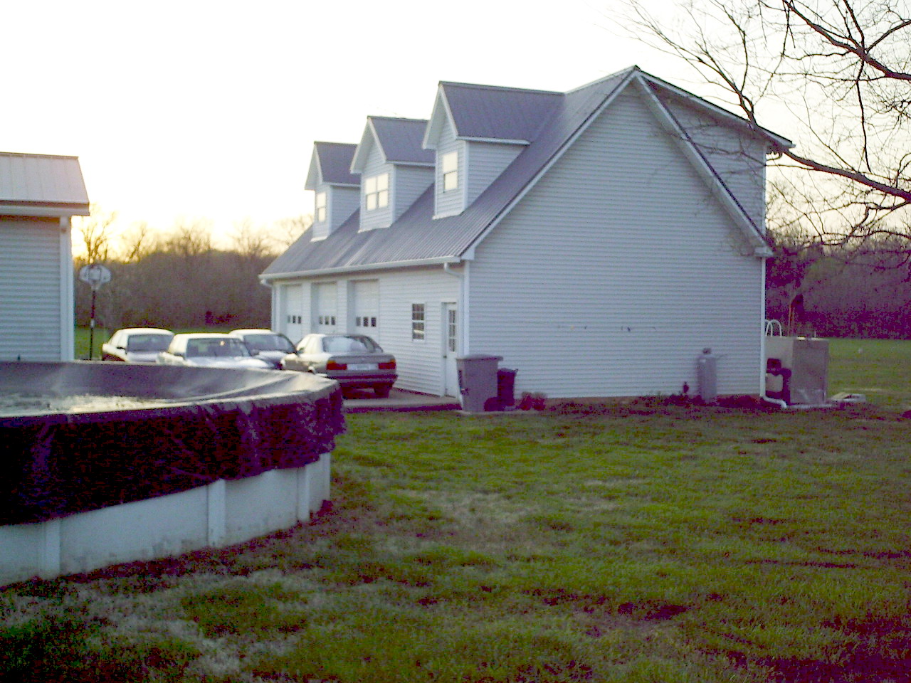

One of the main reasons we purchased this property was the
50' by 25' garage, and since I run a HVAC business,
it came in real handy for working and storing my tools,
not to mention the vehicles we'd soon have with
4 kids and all the other stuff from my mother-in-law that now lives with us.
It already had a septic tank, but still it doesn't have toliet/shower/sink, but
in my spare time, which isn't much, I've managed to install heat & air and water, which goes to the hardy wood furnace out back, that heats both
garage and house, as long as there is a fire, if not, then either heat pump,
LP or electric take over.
My neighbor, who has 2-8N's and 1-MF, liked it so much,
he built one almost just like it, tools and cars down, storage and
maybe someday, rooms upstairs.
