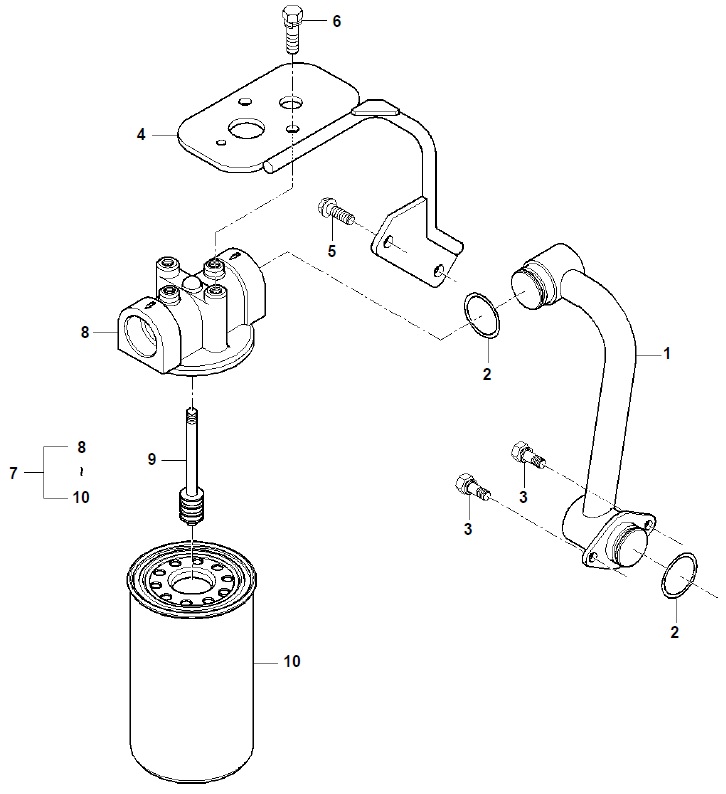

You are correct, the EX series is not available in the US, but the DKse models are of the same platform, I have the workshop manual for the EX and use it for my DK and one would think they were the same tractor at first glance. But their are differences. So my hope is that the housing for my filter, has a threaded hole inside that will accept the magnet assembly like we see in that diagram. I'm also not above purchasing the housing from the EX should I not find a threaded hole in mine, as the hard pipe connections are the same. Or if the casting of the housing allows, I may drill and tap. :devil:

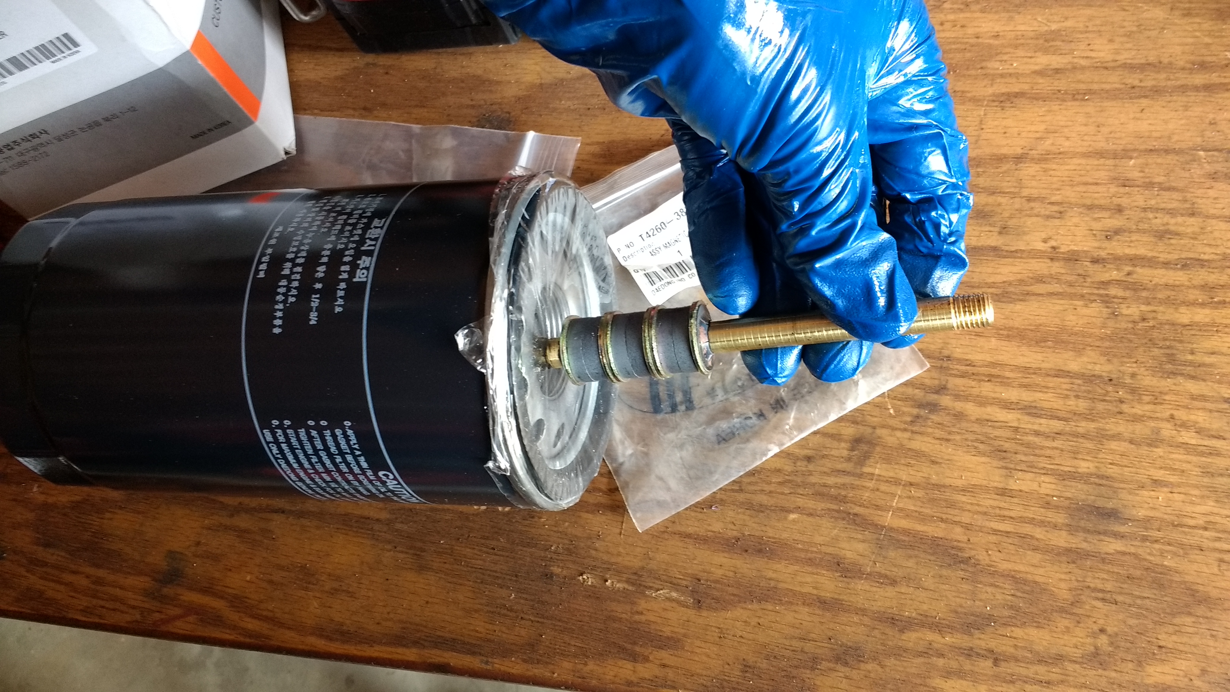

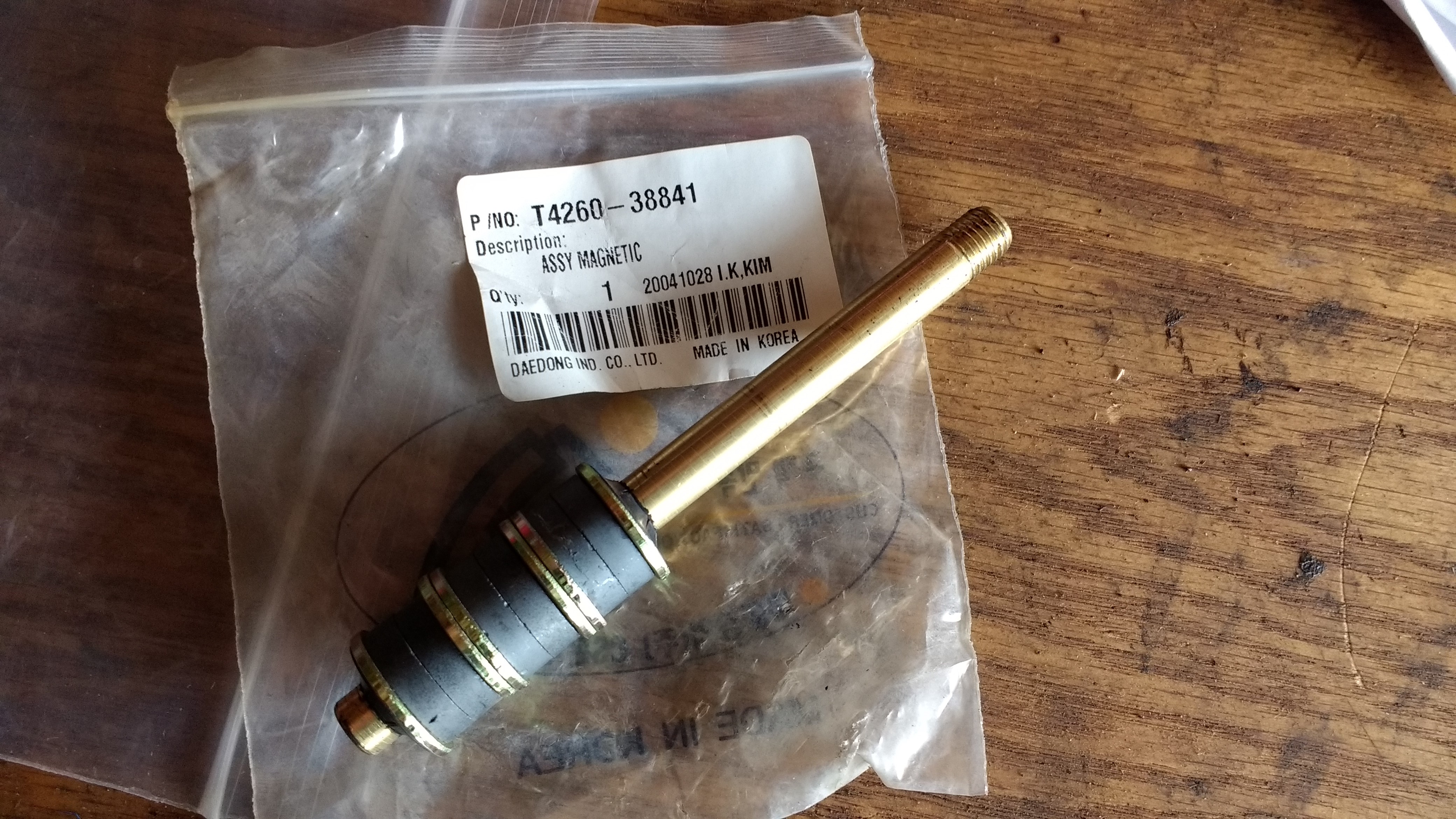

So I ordered that magnet Assembly part #T4260-38841 from Messicks. Came to $35.32 after shipping. Not only is this for the EX tractors which are very similar to the DKse series, but also the Cub cadet tractors 8354, 8404, and 8454, which look to be the same platform as the old DK tractors.
Reguardless, the point of this was to see if the DKse tractors could use this same magnet assembly, which is factory spec for the EX, foreign kioti.

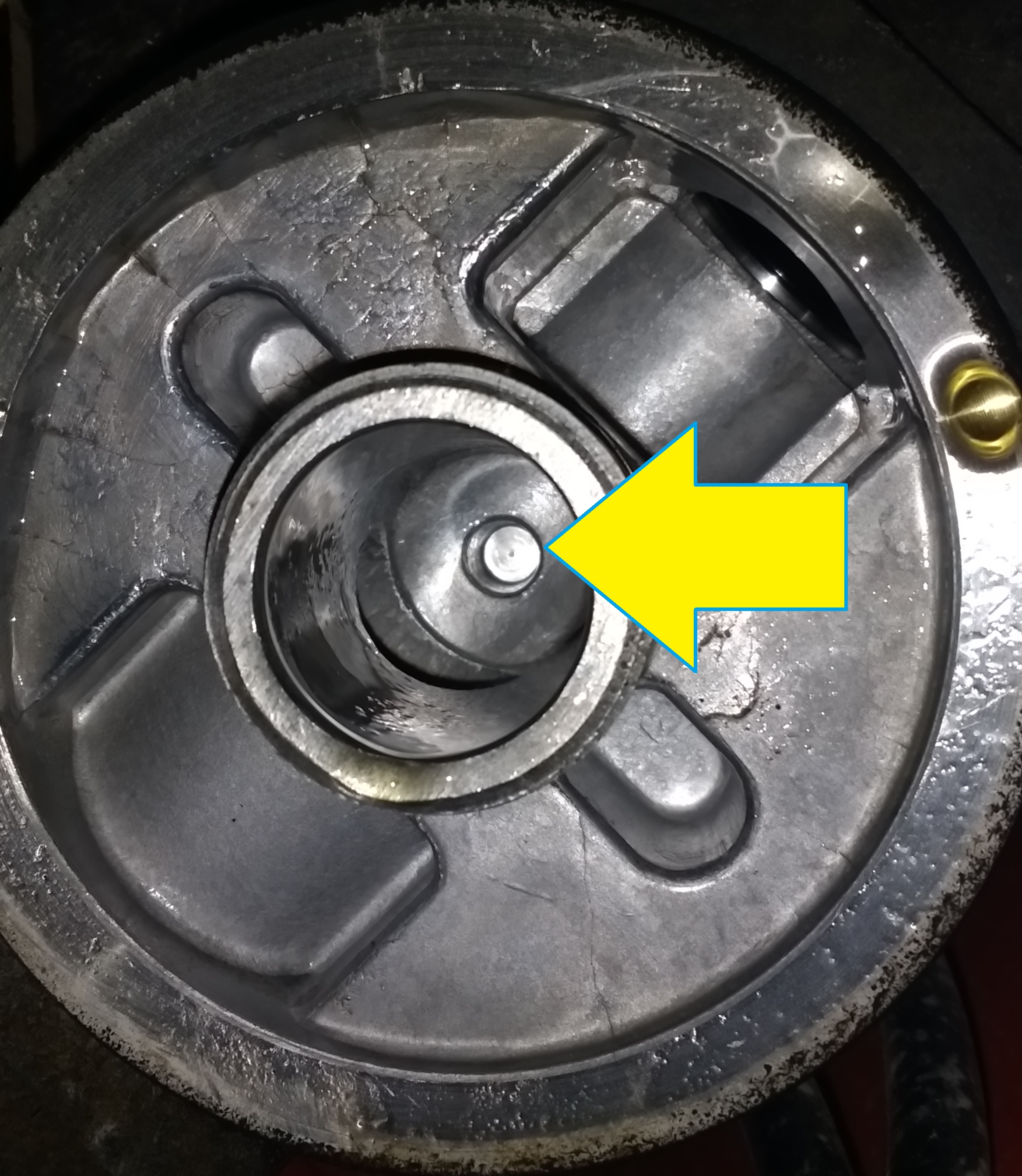

After removing my hydraulic filter I found an 8.5mm hole that is 16mm deep already drilled, but without threads. The magnet assembly threads are M10x1.25, so I used that size starter tap. Went very smoothly and cut great threads. I used blue locktite and screwed the magnet in.
Diagram from the EX tractor that started me thinking about my DKse
Magnet arrived from Messicks
Magnet compared to filter
You can see the 8.5mm x 16mm hole here, looking up at my DKse filter housing

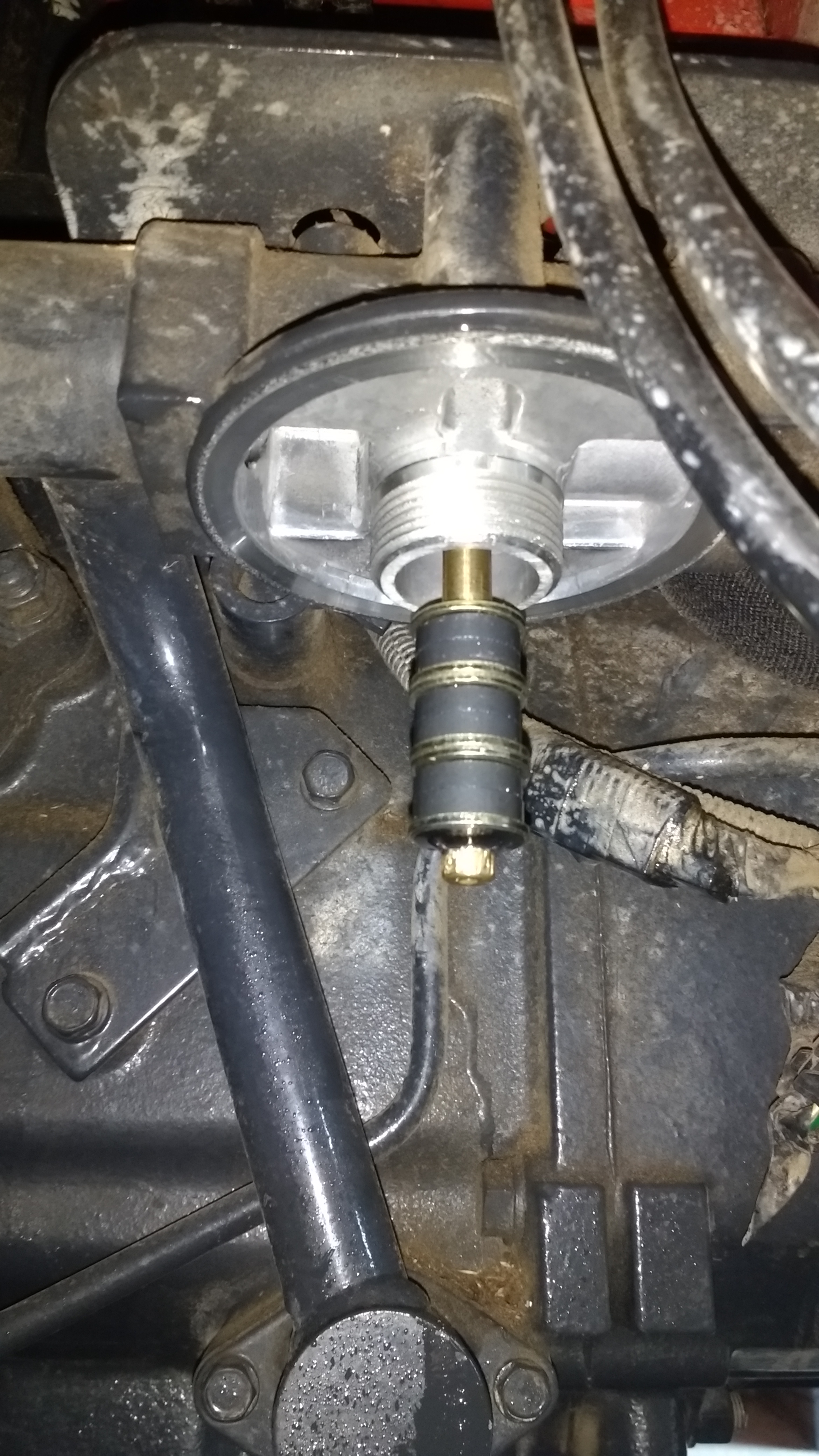

After I tapped the M10 x 1.25 hole and installed the magnet. Clearance and room for flow does not seem like it will be an issue.
After operating the tractor for some hours after the install I have noticed no differences in operational speeds or sound. All said and done, I'm out $35 and about 20 minutes of install time.
