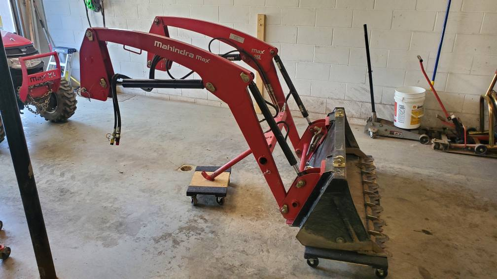

Barnboy, good looking job. I also like flushers engine hoist lift idea. Anyone "stacking" implements in the off season? Be interested in how we are saving space.

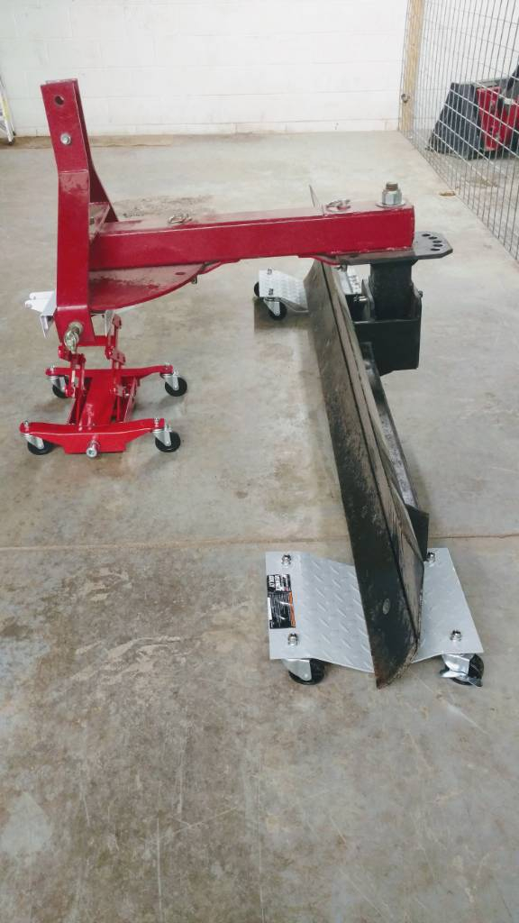

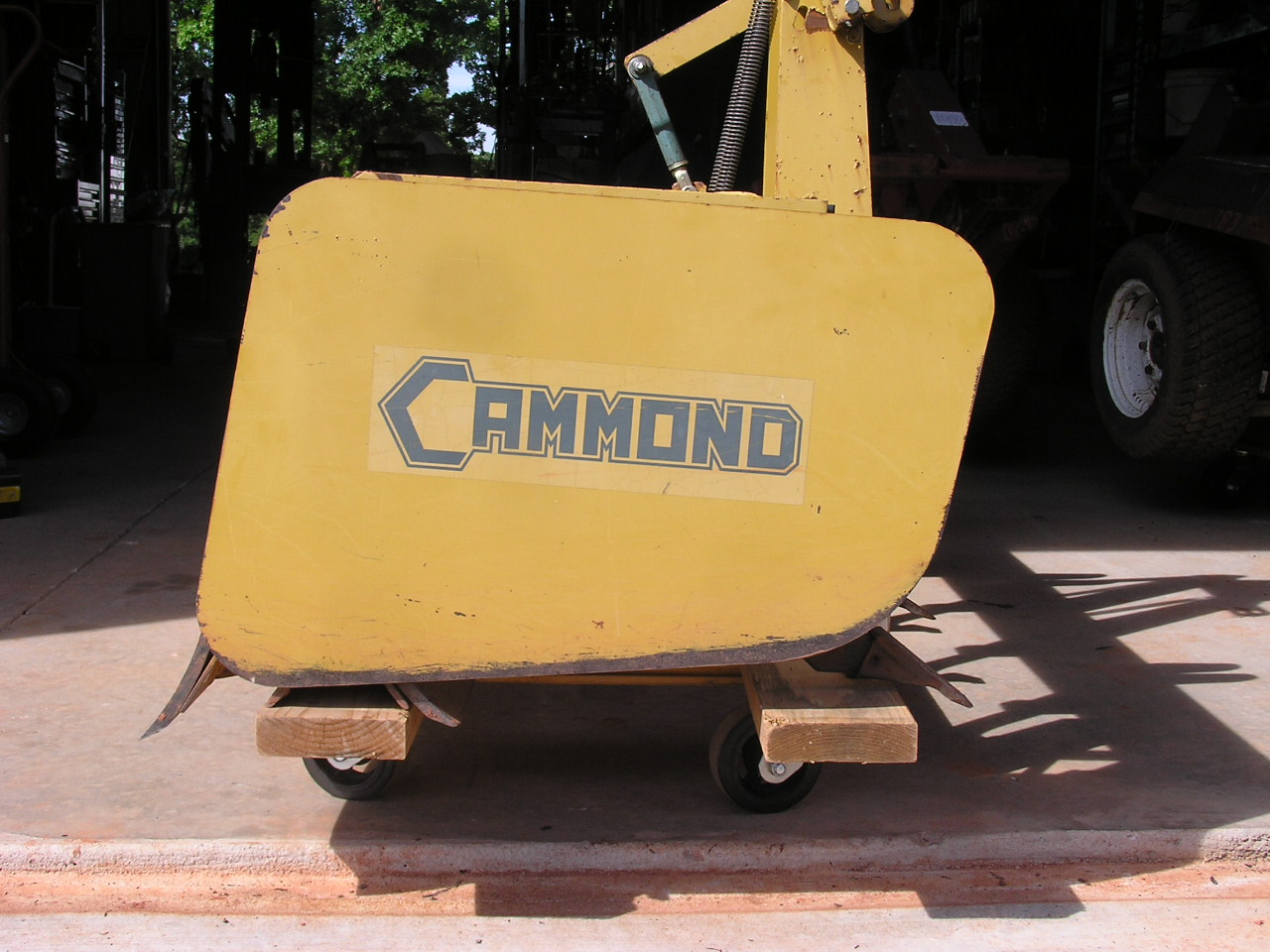

I do. I lift my rear blade off its dolly with the electric hoist up in the trusses. The rb dolly is set aside and the rough cutter is rolled beneath on its dolly. The hoist then sets the rb onto the back of the rough cutter. When the rc is rolled against the wall, the carry all, which has its own mini casters bolted to the legs, is rolled beneath the blades of the rc, with only the vertical posts upright at the end. Then the rb dolly and mmm dolly are stacked atop the rb.

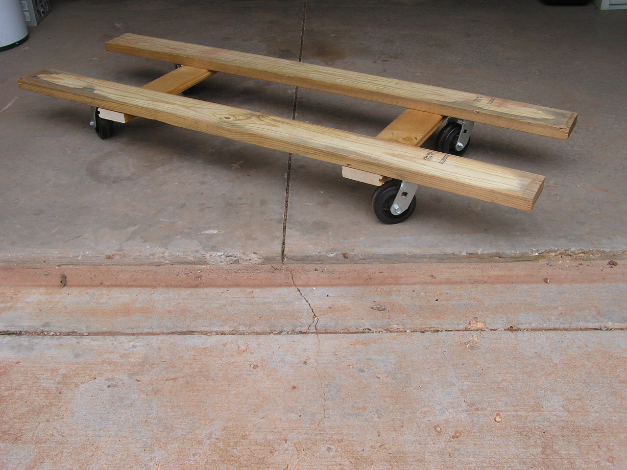

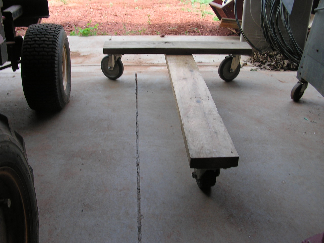

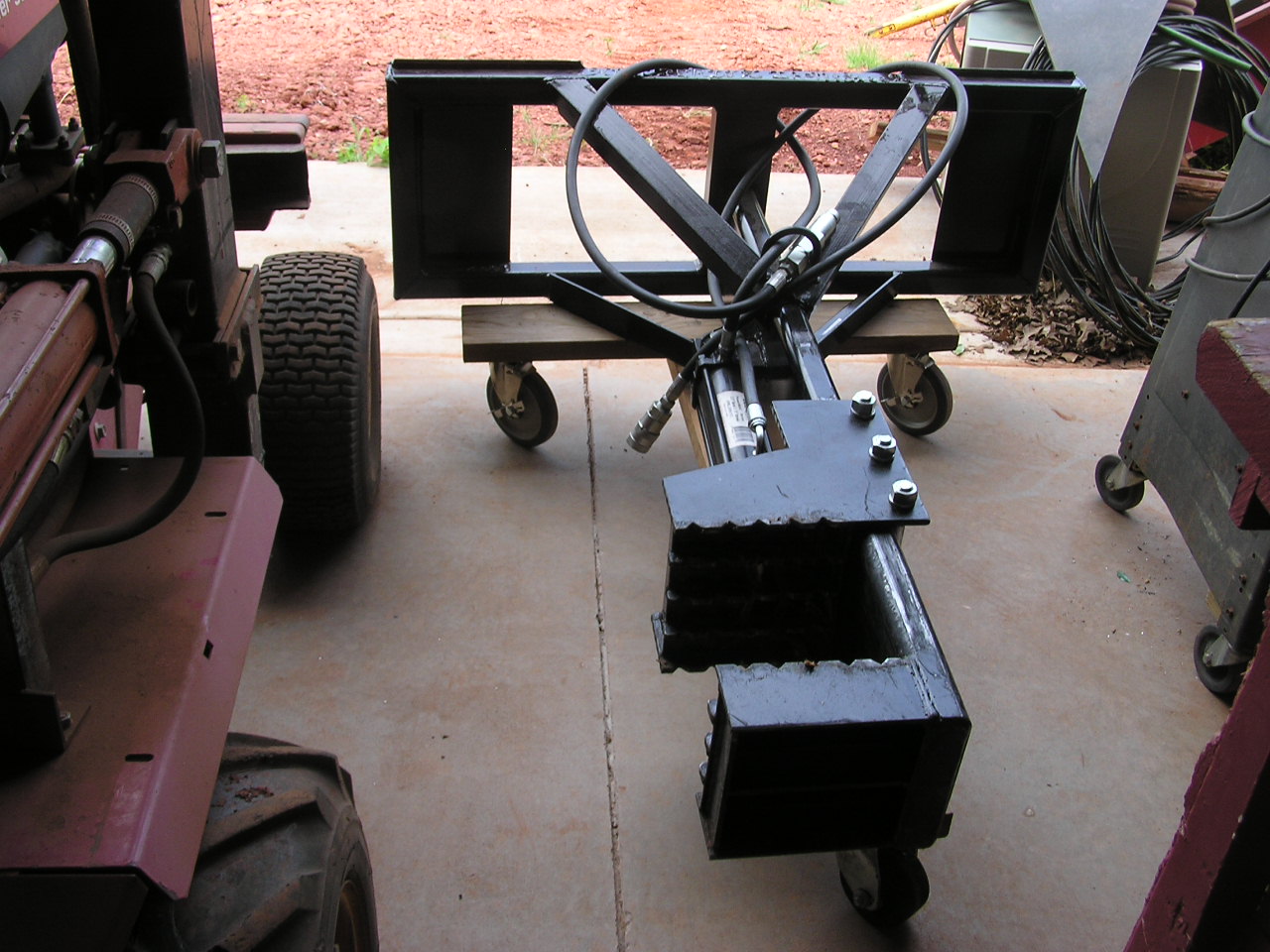

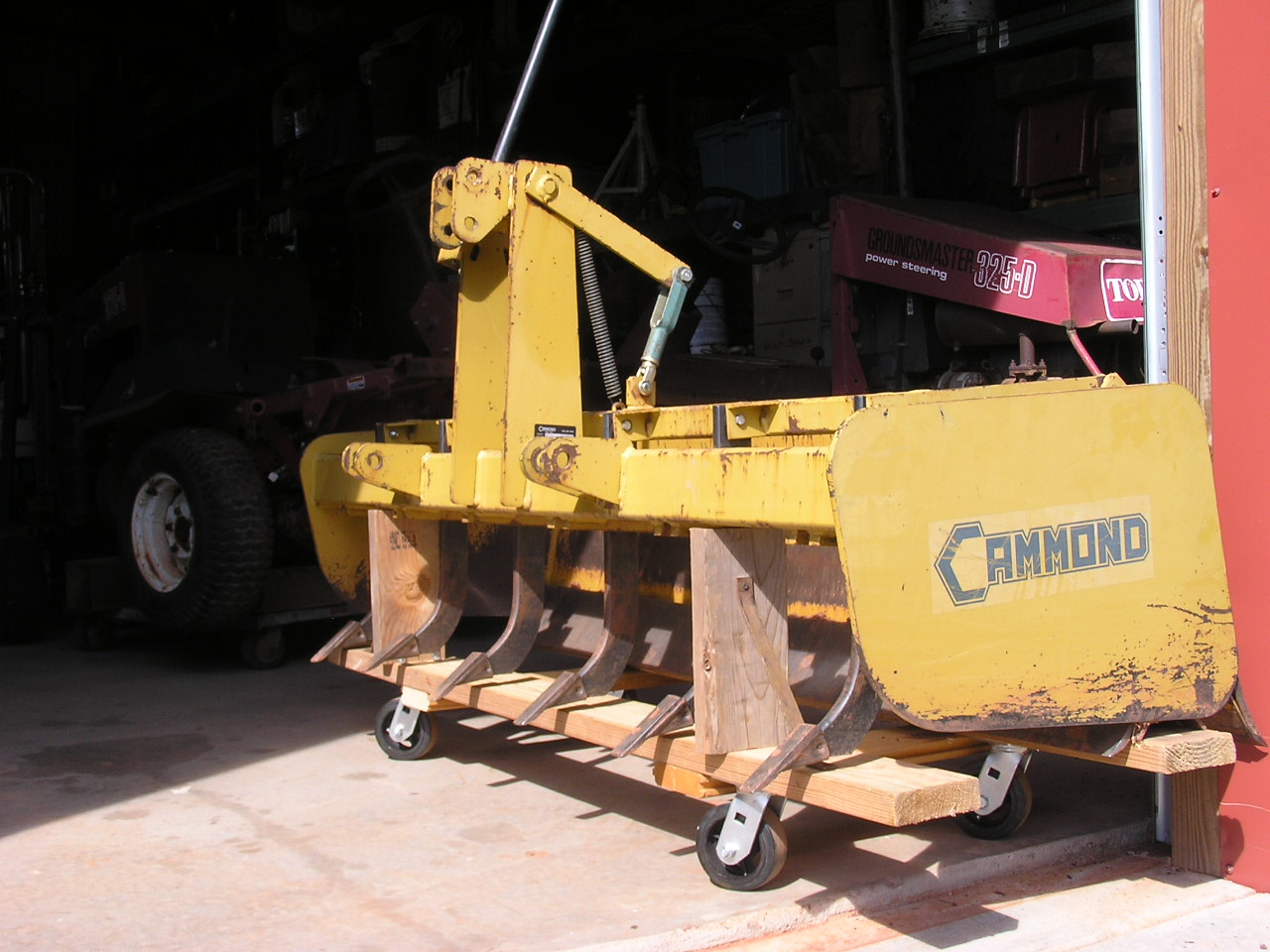

Since this old thread got revived for new eyes, here is one I made from 2x6s:
And a three wheeler for the tree puller:

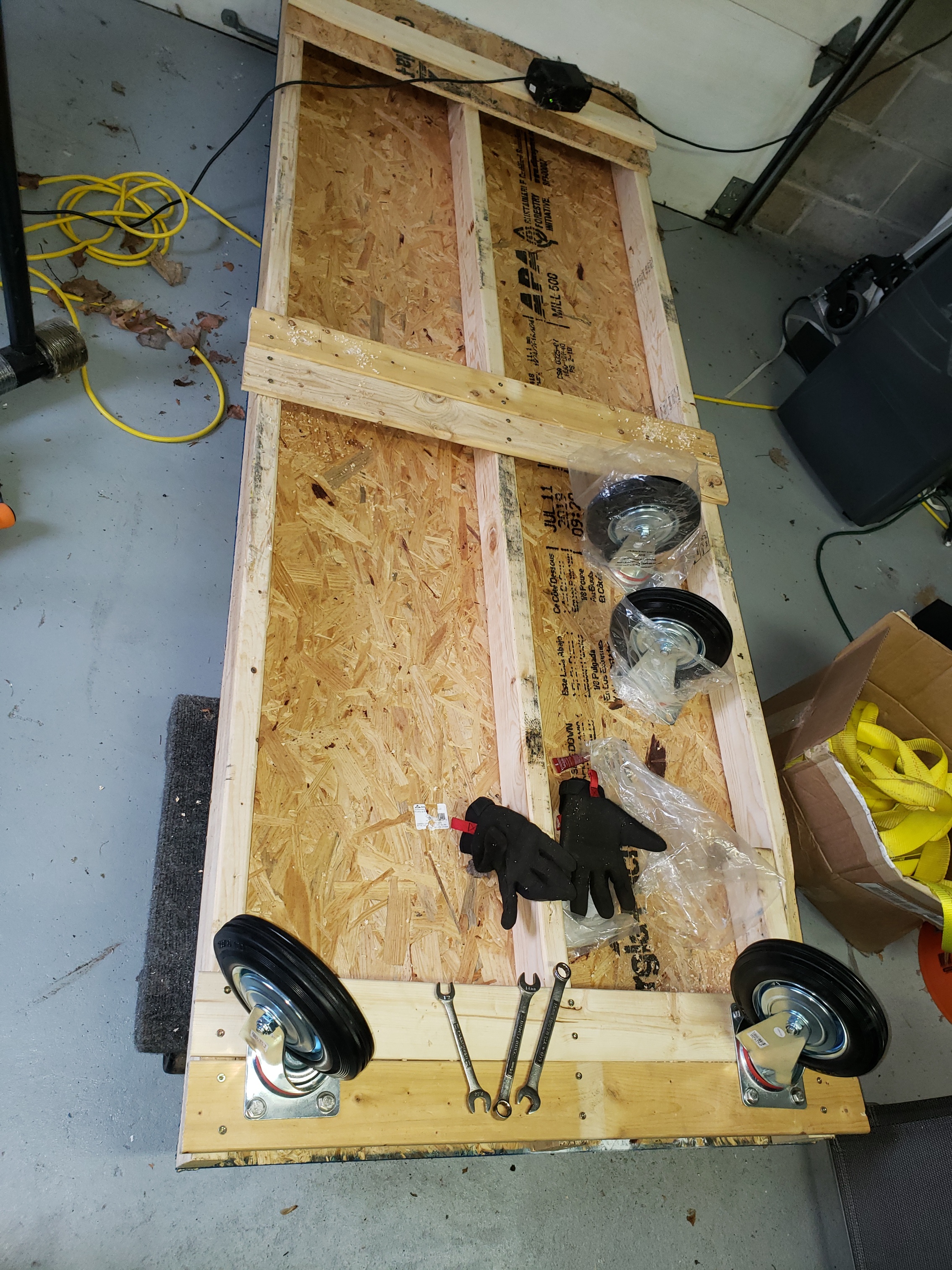

palletroller_resized.jpgMade this (complete now) to move a 600 pound bar across my yard. May repurpose for my backhoe once the bar is in place.

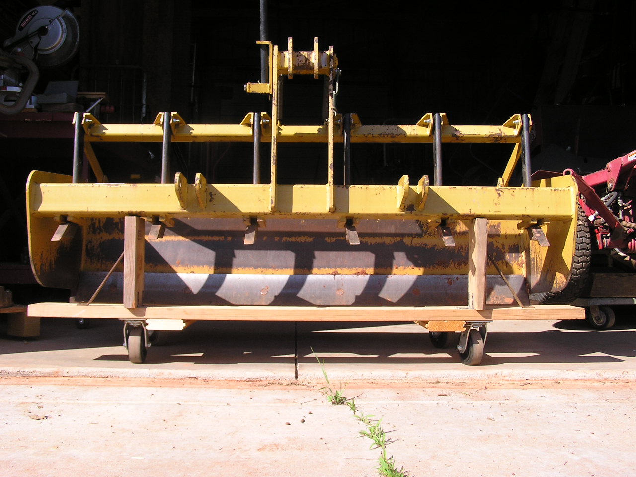

View attachment 649661 View attachment 649662
XMan, I read a TBN article a month ago that had a pic of your 2x6 dolly and a link to one of your threads and have been looking for it again. I have my casters and will build a 2x6 dolly for my 72" Kubota bucket with Ratchet Rake. Thanks for reposting
   / Dollies For Moving Implements #20
You are welcome.
Found this article while doing research on fork dollies for another thread. It may be the one that you saw: The Best Home-Built Tractor Add-Ons of 218, Ranked - TractorByNet
Thank you XMan, this is the article - it has several upgrades I plan to make. Saw your wood storage dolly and want one of those also. Its always an educational tutorial when I read your posts. Thanks for taking the time to share your knowledge.
