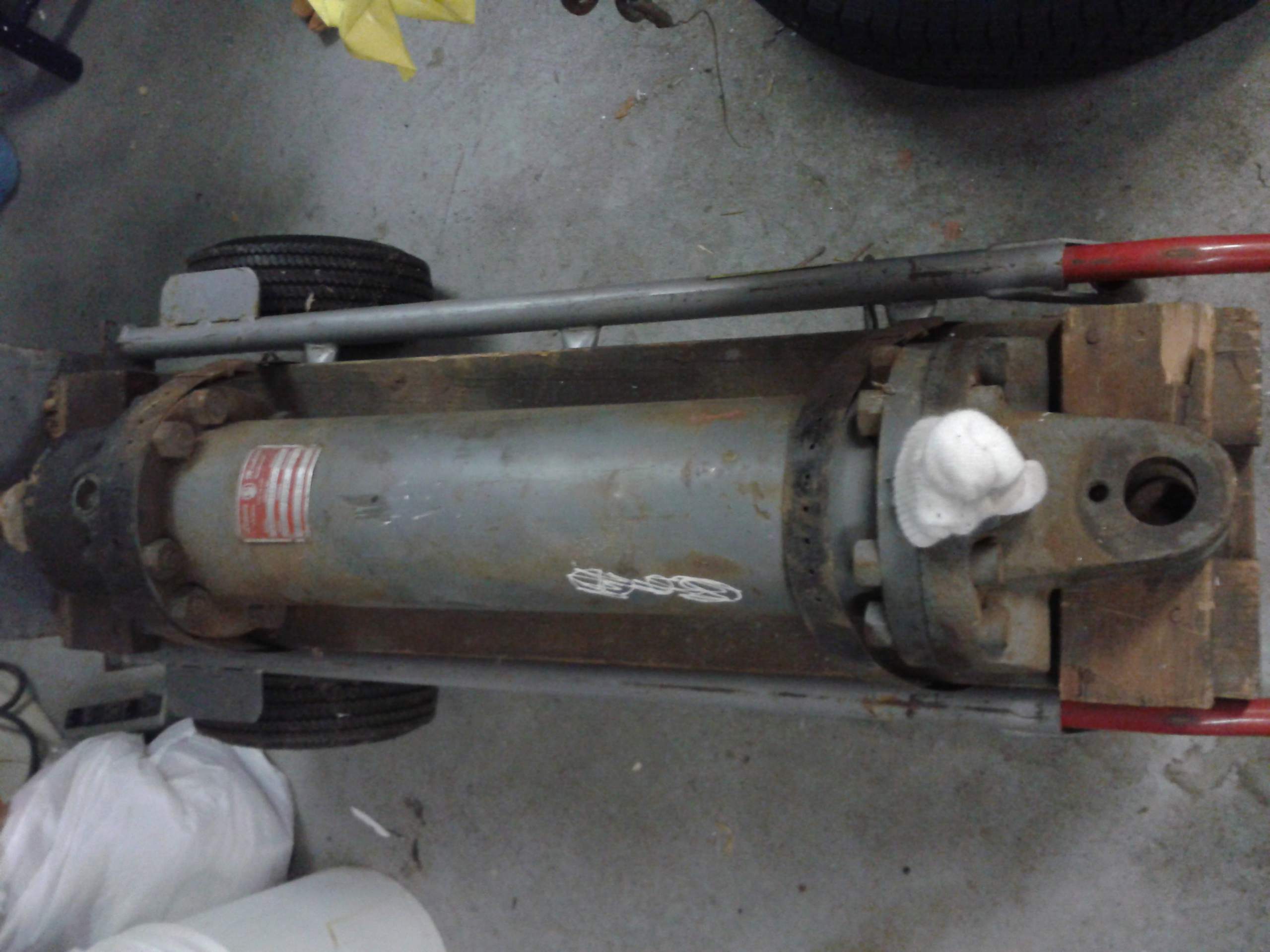

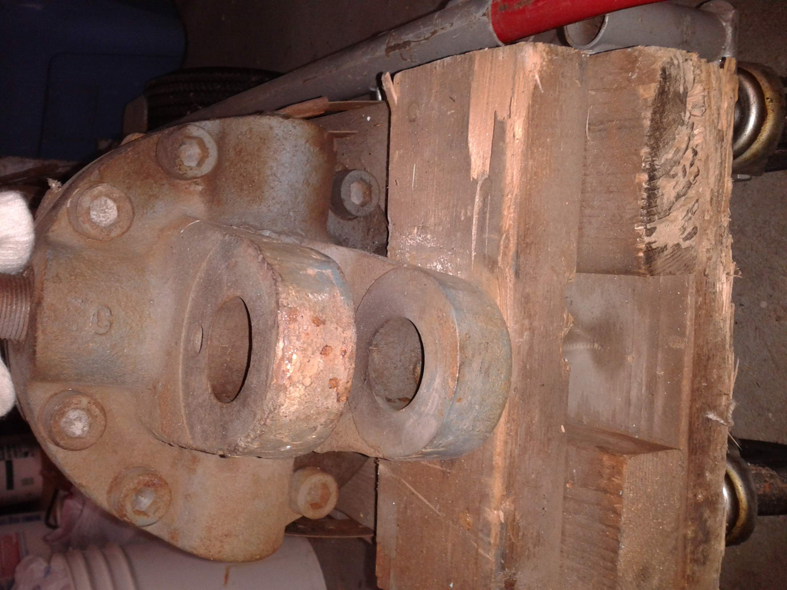

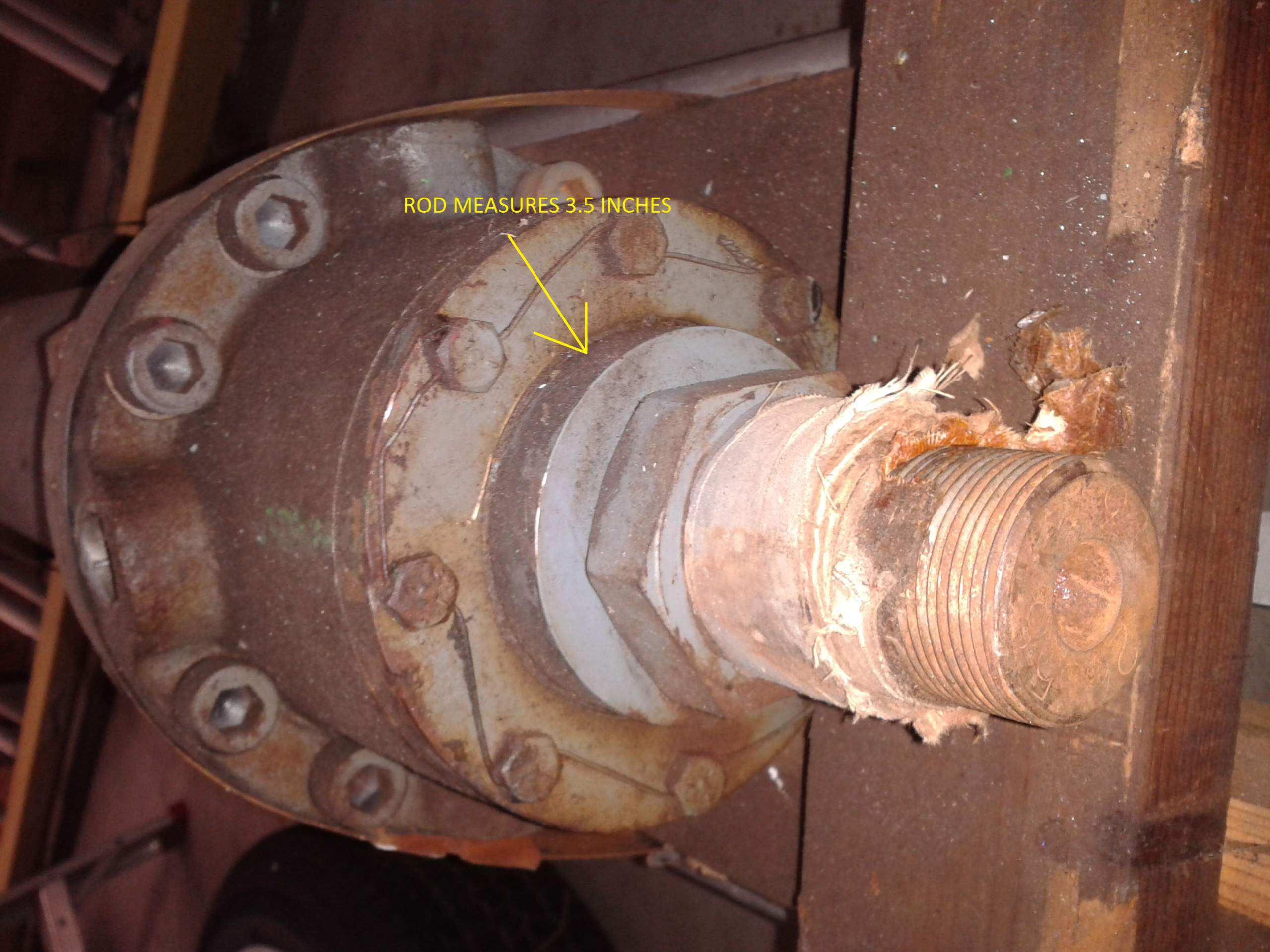

Ok so I have a cylinder that was donated for the Log Splitter project. This thing is BIG and HEAVY. It says it is a 5 inch bore and I'm measuring the rod to be 3.5 inches diameter with a 20.5 in stroke. All in all I think this would be perfect but..... There are a few concerns I have and would like opinions on it.
My concerns are :
1. Not sure if it works or not and since I don't yet have the splitter hydraulics built I have no good way to test it.
2. Cant find any real info on it on the web so if it doesn't work can I get a kit to rebuild it
3. For the massive size, the tag says its rated for 1500 psi ????. Could this be right given its mass ? With this rating should I even bother ? And did I mention that this thing is freaking heavy.

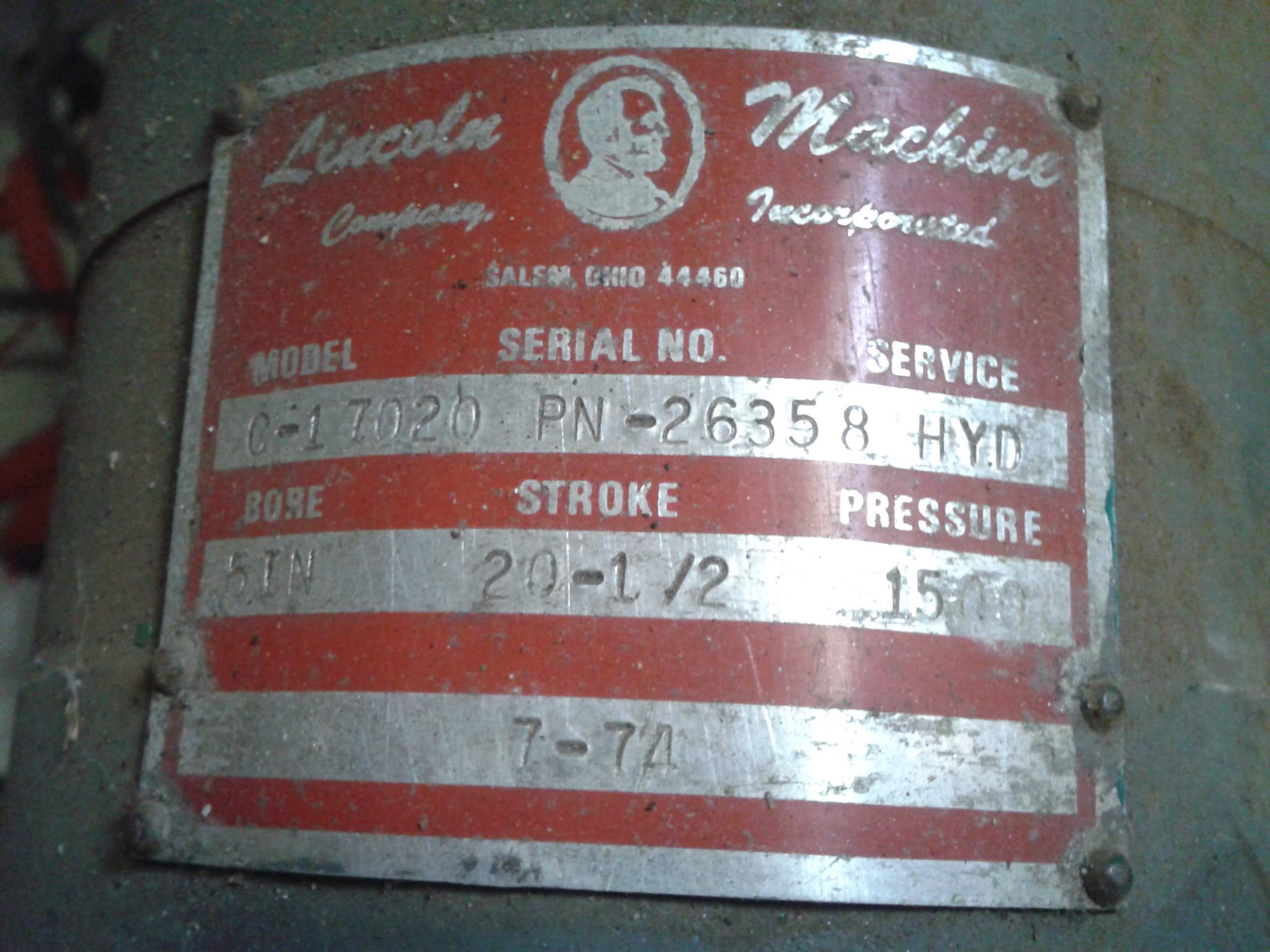

Here is the tag info:
Lincoln Machine Company Incorporated
Model: C-17020
Bore: 5 inches
Stroke: 20.5 inches
Pressure: 1500
Anybody know anything about these cylinders ???
Take a look at the pictures and let me know your thoughts.
Splitter_cylinder_01.jpgsplitter_cylinder_02.jpgsplitter_cylinder_03.jpgsplitter_cylinder_04.jpg

1500 psi is fine, standard for CUT's
the issue i would have is its going to take a metric butt ton of hydraulic flow to have any decent cycle time.
if i did my math right you need to push something like 1.8 gal of fluid into that cylinder. it should generate something in the
neighborhood of 14-15 ton
you can operate it on compressed air for trial cycles.

I agree with JJ buy a cylinder. If you ever need to repair that old one you will need to take out a loan. Most cut systems run at 2000 to 2500psi also. CJ
   / Donated Hydraulic Cylinder for Log Splitter #8
I agree to get a cylinder.
And if it is clearly stamped 1500psi (and it is), dont second guess that. They give them the pressure rating for a reason. While you "may" never have an issue, since there is no shock loads, what if you do? and worse yet, what if you sell it and someone else has issues??
