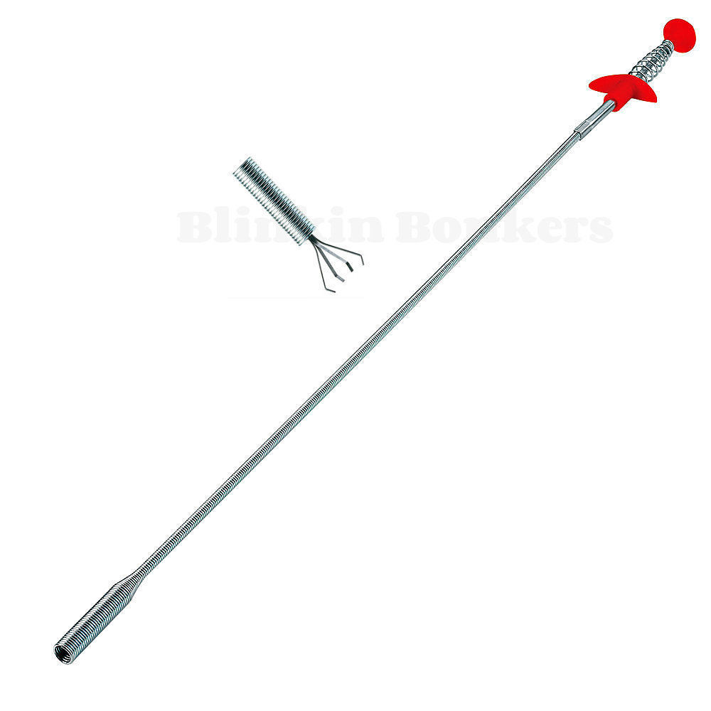

I also have a Deere LX280 - and when adding transmission oil accidentally dropped the foam filter (under the cap) into the reservoir. So I am seeking advice on how to extract the foam filter from the reservoir without draining the transmission oil.
I assume it's at the bottom of the reservoir tank? Other than disconnecting the hose that connects it to the transmission, draining it, removing the tank and flipping it upside down, will one of those flexible "reach claws" grab it?
   / Don't change transmission oil? One and done? #15
Re: Don't change transmission oil?
Thanks - I extracted oil to the ADD level - disconnected the reservoir from the hose - fished out the filter with needle nose pliers - reconnected and filled - took about 10 minutes. Appears to work. - Thanks again for the response.
