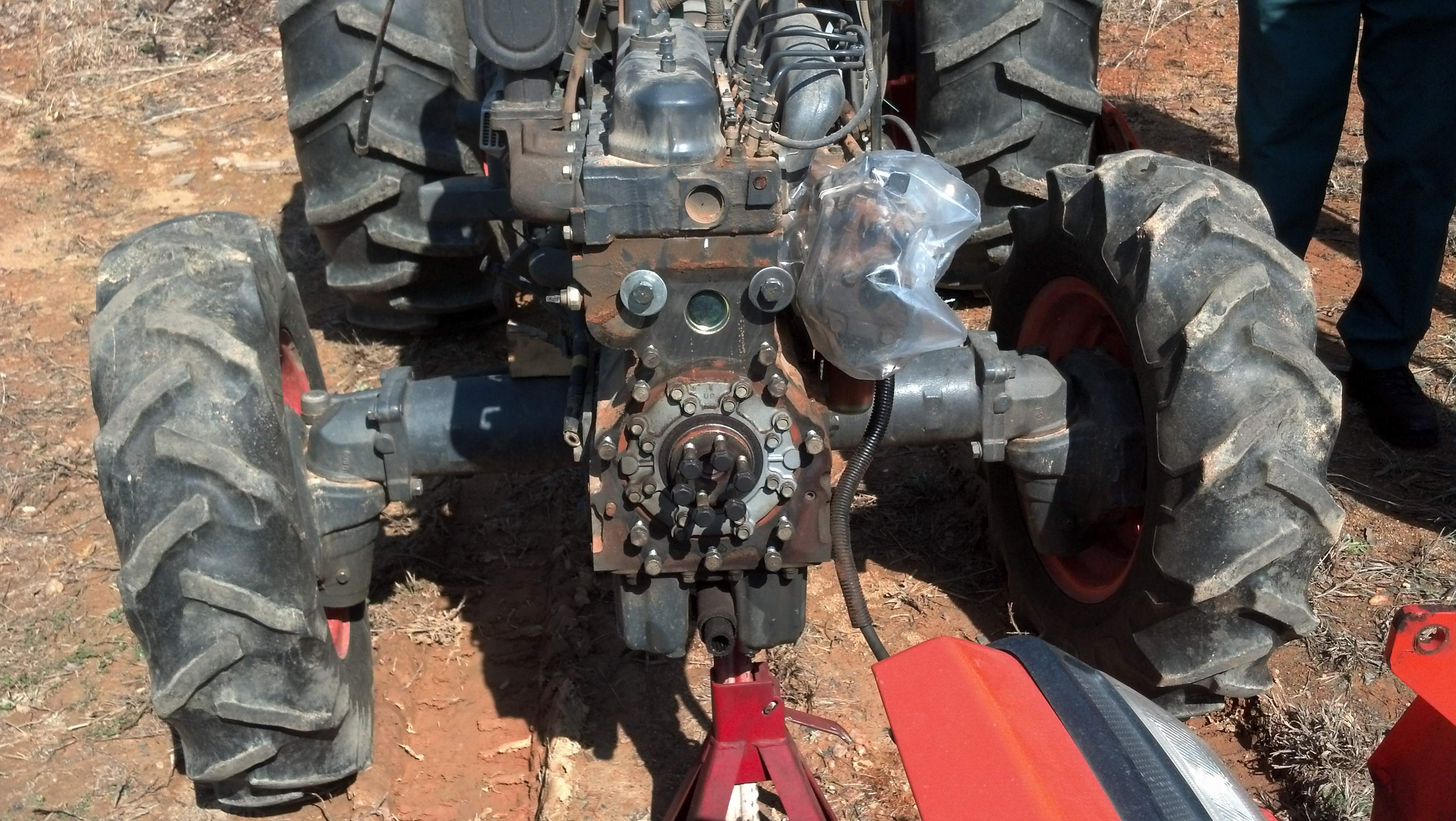

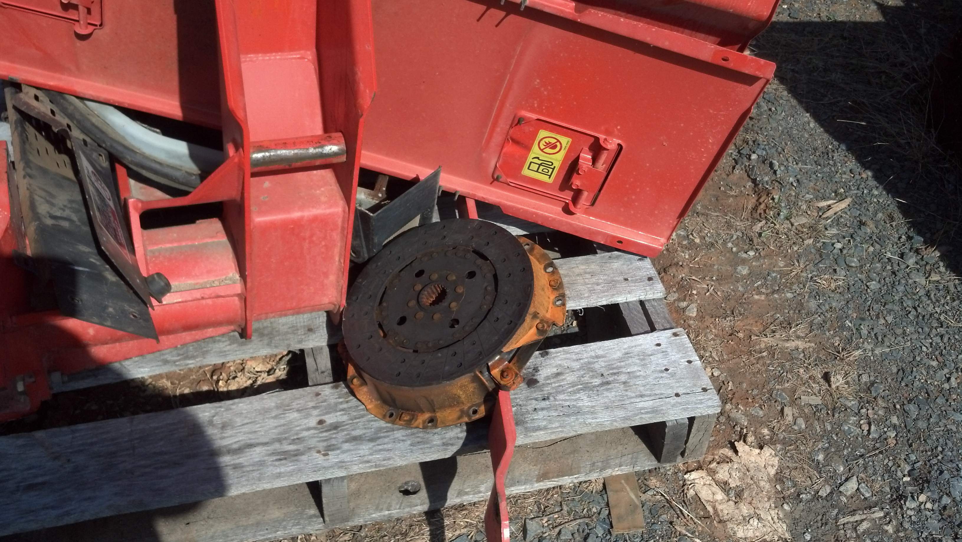

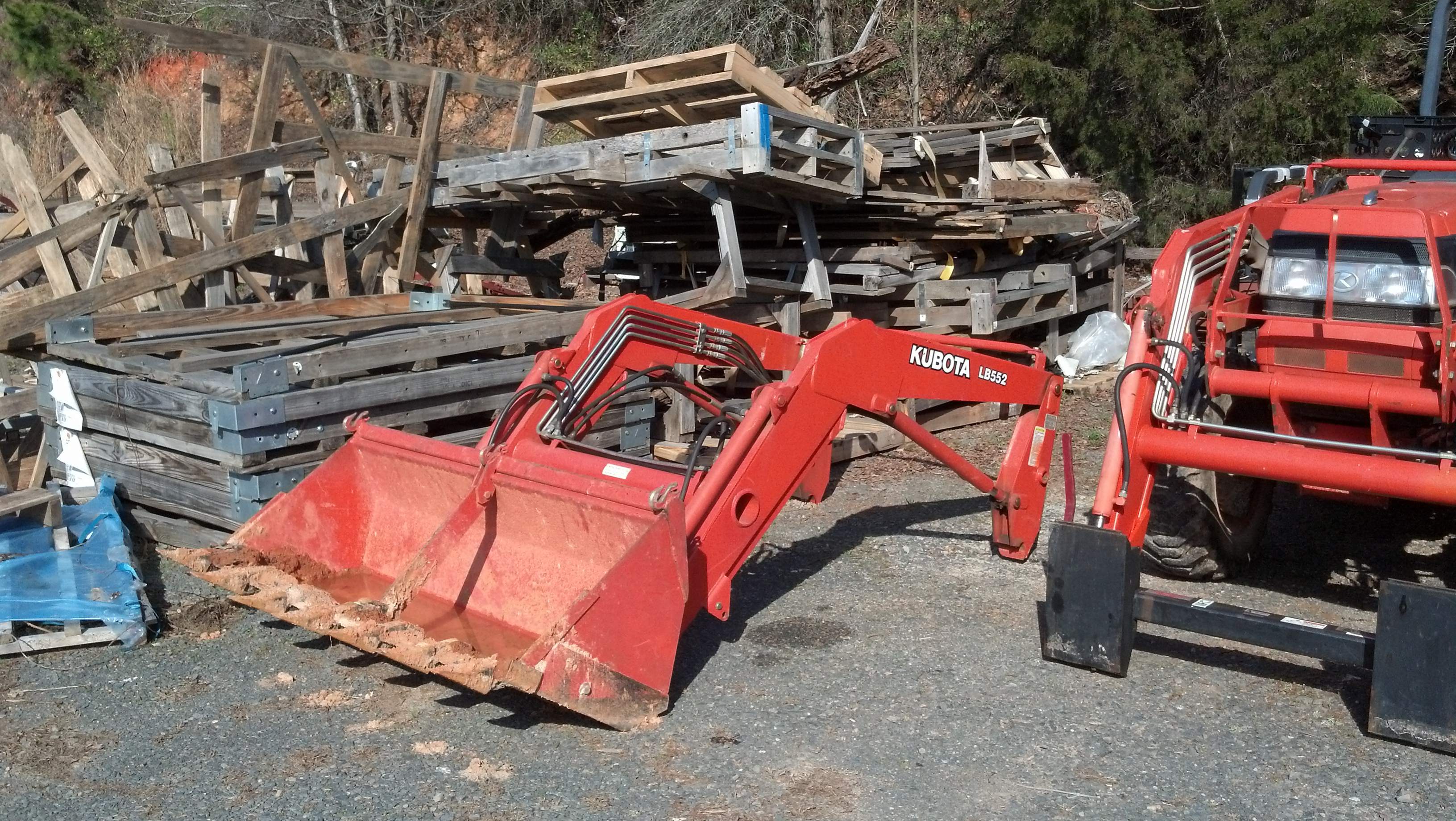

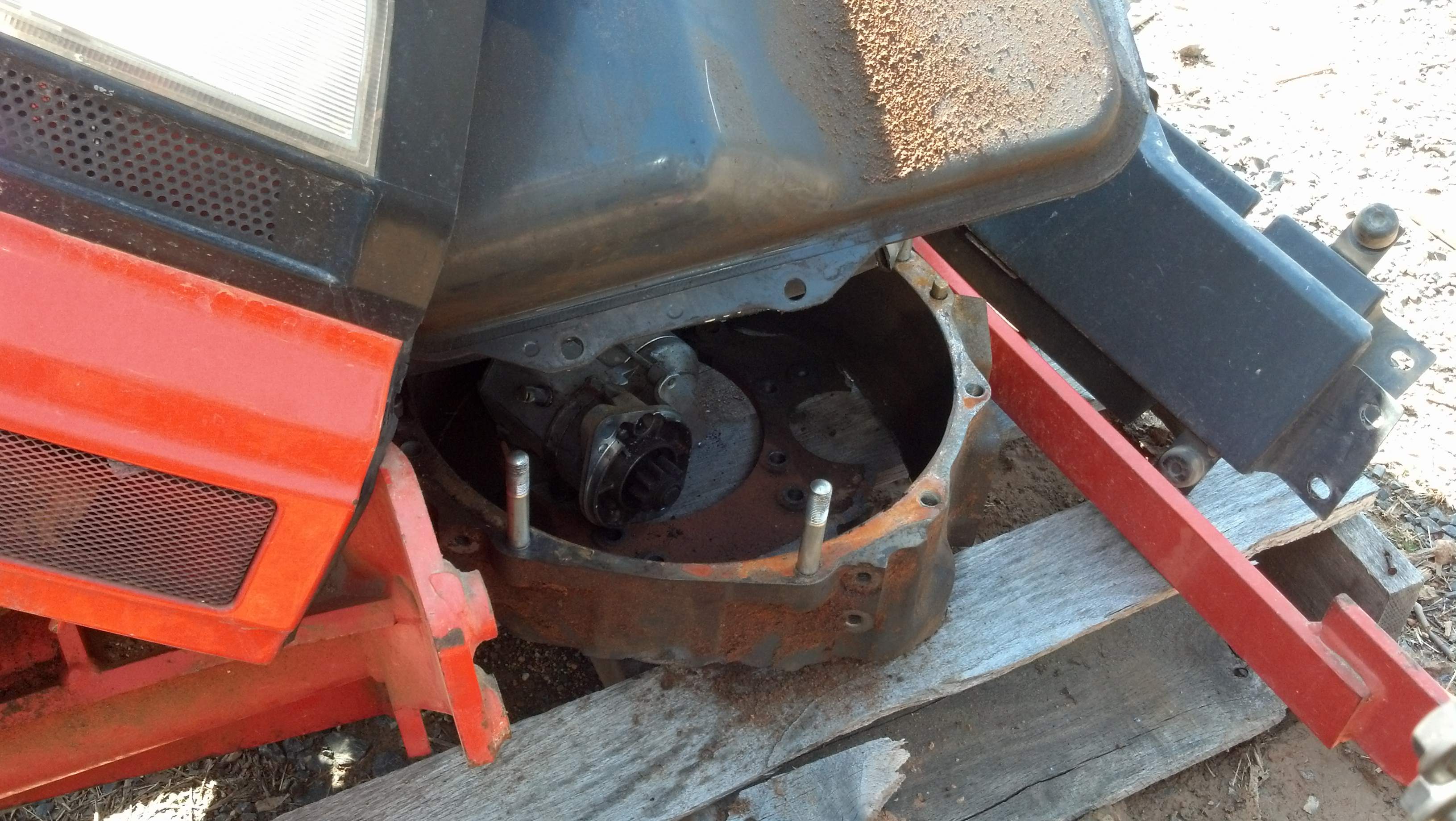

The dealer called and said he had the tractor split, so we paid a visit Saturday. The service manager was not there, but we got a look at the tractor.
It is not as bad as we first thought.
The loader mounting brackets bolt to the hogshead. That appears to be the only broken casting (first picture). I thought the transmission case was broken, but it is only the hogshead.
The front drive shaft suffered collateral damage and I'm sure other parts will need replacing, like possibly the clutch and pressure plate, but most of what we saw appears to have gotten by unscathed.
The plan now is to repair the tractor and purchase a loader made for an L4310. I doubt being able to find an LA682 Kubota, so it will probably be an aftermarket ...possibly a Woods?
Anyone in need of a good used LB552 loader?

The dealer found a NOS LA682 loader. There are actually two of them available in the US; well, one now. Kubota recommended a different valve assembly, not sure why unless the flow rate is different, but the bucket on the LB552 will work on the LA682.
