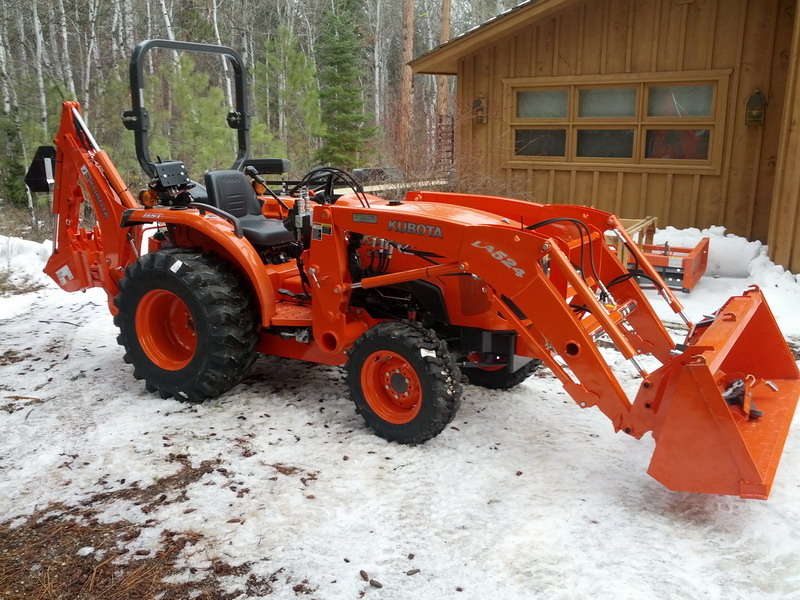

I want a small utility tractor with FEL and Backhoe, have no need just want. I looked at the 10xx JD and the BX25d and they seem a little small for me. I am 6'5 275lbs so I need something that will be comfortable. I have read all day on different posts and my head already hurts. I do not want a monster machine as I want to park it in the garage.
I Also want to add a front Snow Blower and more than likely Forks to move Pellets and other stuff that come on pallets (1/2 ton although a ton would be bonus)
In reading the b2920 looked interesting as did the JD 2520 (God I hope I got those numbers correct). I like the Kubota because you use the same seat for the Backhoe and tractor so I assume it would be shorter then the JD. I am open to any other tractor if anyone has another suggestion.
I thought about buying used and just got even more confused.
Is there a thread somewhere for people like me who also want the Backhoe option? I read several but they all talk about FEL and MMM - WHAT is mmm? Is it a mid mount mower?
One more question - what is the better tractor to add a Backhoe to?
PLEASE keep me under 30K for Tractor, FEL, Backhoe, Snowblower and forks.

Any tractor with a backhoe,make sure it has a sub-frame and not a three point hitch mount.My son-in-law is about your size and operates a B7800 with a hoe,quite a tight fit.I can run it(and I'm 50lb lighter and five in.shorter) but its not comfortable.B7800 is about the size of B2620-B2920.All the Kubotas as far as I know are sub-frame mounted.
MMM is mid mount mower.You may want to look at the standard L series,Kubota.I.E L3800-L4600.Not familar with other brands ,I'm sure some one will chime in on Kioti,JD,Massey ect.

On Kubota USA site;I built a L3800,4wd,FEL,HD bucket,R4's,HST transmission,Back hoe.....list for $32,000 should be able to buy for less than $30,000.

I'm about your size, and ended up with an L3200. There's 'enough' space in the seat, but my size 12s sometimes get tangled up in the pedals when entering/exiting. I wouldn't go smaller. Be sure and check Barlows for price; Night and day compared to our local dealer.

I'm more familiar with John Deeres but I think you may want to go for at least a 2720 or maybe even lower 3xxx series if you'd like to lift 1000 lbs with forks. As I always tell people, think carefully about the backhoe. Everyone wants one but how much will you use it? For specific jobs you can rent either a bigger backhoe or a small mini-excavator a lot of times for the cost of a backhoe. The big backhoe will do a lot more than a CUT mounted one and a mini-excavator will do a small job much easier. Also, on most machines, a backhoe is not something you can take off or put on in minutes like a blade or loader.

In the Kubota line up, based on your size, an L series, MX Series or lower end M will come closer than a BX series for comfort. Maybe a higher hp B series. I felt like a cartoon when I got on the BX series tractors at the dealer.
I am not familiar with other makes as far as size goes. It does sound like you need to be in a compact tractor rather than a subcompact. I have a Kubota MX5100. It has plenty of leg and foot room and the seat is high enough that elbows and knees don't knock.
The advice on the backhoe practicality by KennyG is worth considering. We have a 250 acre cattle farm and for the number of times we have needed a backhoe we couldn't justify the expense. We have spent less than $1,000 for backhoe services in the last 25 years (not counting septic tank installation etc which we wouldn't do anyway).
