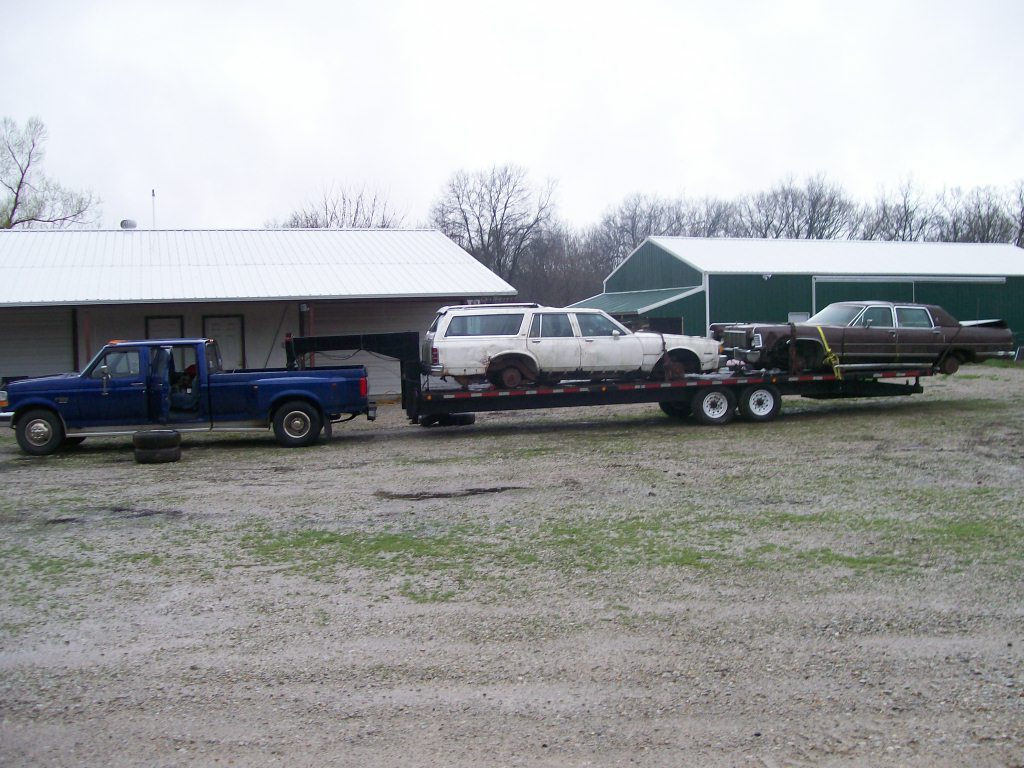

I have now checked out Corn Pro, Moritz, PJ, Titan, and Mustang deck over trailers. Anyone have any others they thing are as good or better quality for same or less money?
/ Dove tail option help #30
Check out Rolls Rite.com they are built here in Marianna, FL and I know they have some dealers in Ohio. They are custom trailer builders and can/will build whatever you want/need.
Stu
/ Dove tail option help #31
I got a BetterBuilt last year and think the quality might just be a tick above Cornpro for the same money. They are out of Alabama. Above that it boils down to features.
I saw an Appalachian over at the fab shop last week and realized there is a huge difference in some trailers. This was a GN 14K and mine was parked right beside so comparison was easy. The list of short cuts and lesser material would fill a page. Guy there said he wouldn't even think of putting my tractor on the Appalachian.
/ Dove tail option help #32
Not asking you to fill up a page, but what were some of the major shortcuts/poorer materials you noticed? What do you think the price difference between your trailer and the Appalachian would have been? My neighbor purchased an Appalachian tri-axle about two years ago and says he is satisfied with it, but I did notice some rust starting.
#33
WKPOOR:
What size trailer is that?
/ Dove tail option help #34

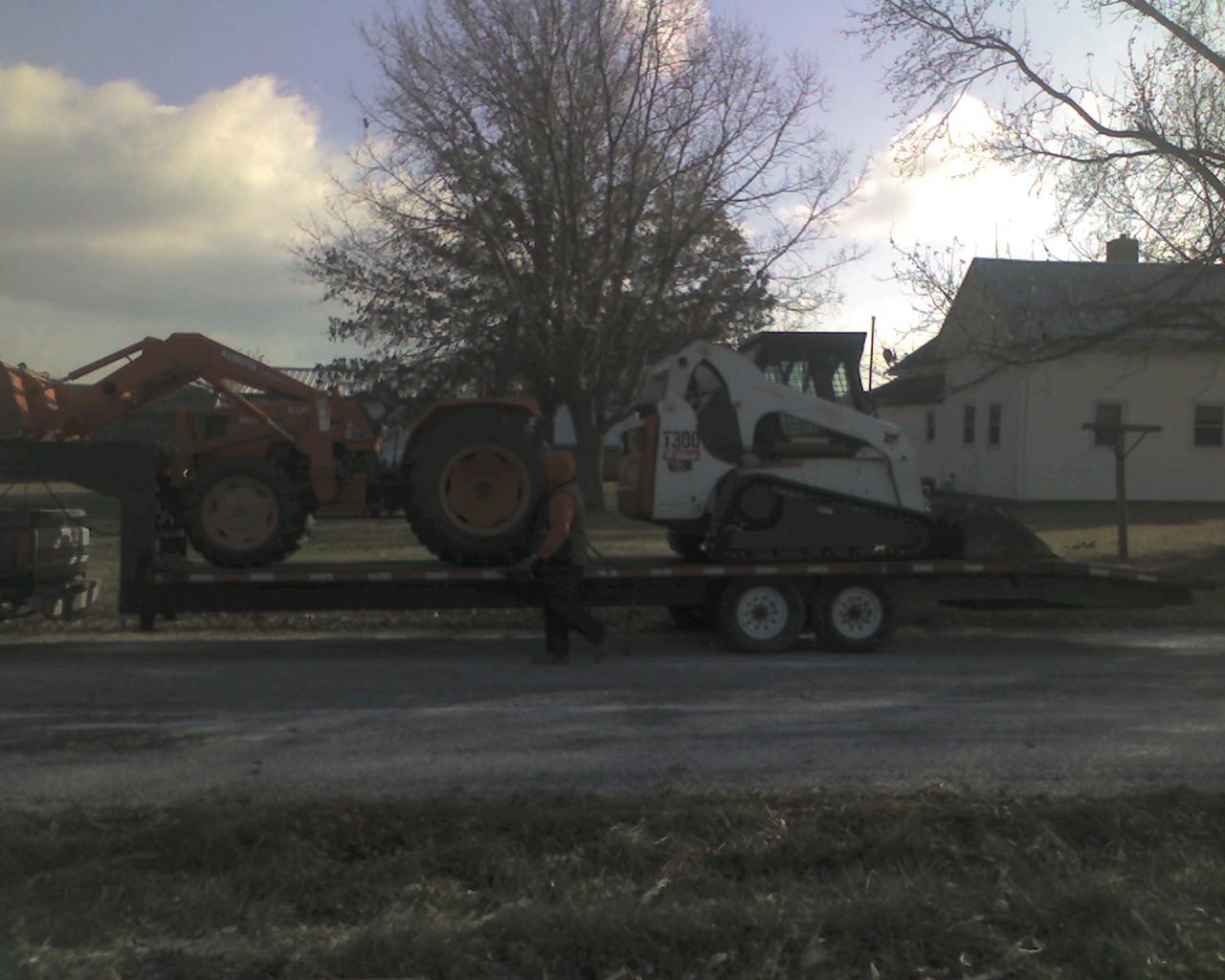

Well lets see....Appalacian had C channel instead of I beam, cross members were further part, sides where angle iron instead C channel, Dove and ramps had way fewer cross angles, whole framework in the GN area was downsized material from what I usually see.
The BetterBuilt uses 10" I beams and the way they do the front is just plain massive. That is a 20+4 with enclosed tool box in front and LED's for $6500.00.
I added the roller and winch. Trailer weighs 4300lbs. Wiring is real nice too.

The roller is so the winch cable doesn't drag on the edge of the trailer when he is pulling something onto the trailer. Otherwise with time he will fray/damage the cable.
I have a winch on my tilt bed trailer and therefore the roller is not necessary.
