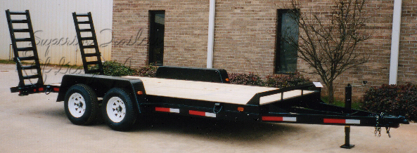

Hey Jim,
I have since sold that trailer and now have 12 dump trailer.
I haven't tried to load the tractor with the mower yet, BUT I'm pretty sure it would hand up due to the height and the crest angle.
That being said, My current ramps and the ones from my 16 " old trailer are standard " equipment" trailer ramps. 3" C channel with 2" angle stock every 9" for treads. 12-16" wide, They can hook on or be hinged....
Most are 5- 6 feet long...I lengthened them to 8'
Here is a stock picture from superior trailes showing the ramps...
Or try these....
Folding Tractor Ramps
I have a set for my motorcycles but with a 3000# rating I have used them to overlap the trailer ramps to increase length and decrease angles
Let me know if you have any other questions...
