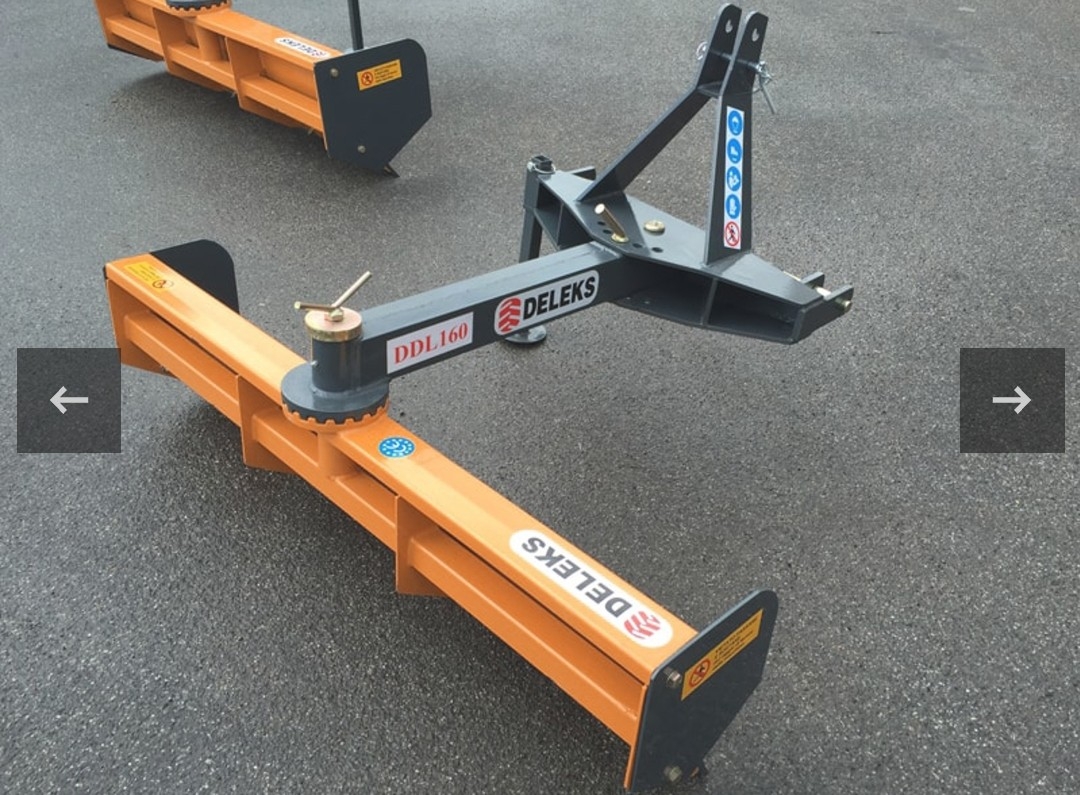

I know it *says* it's 15mm thick, but
I can't quite believe it. I'd go with 10mm max.
Product link: SUPER LIGHT TRACTOR POLIDOZERS - Zeppelin Maquinaria
The unit which states it's for 18-25HP is 1.2m wide (4') and weighs 70kg. Super light.
   / Dozer blade/polisher
#13
   / Dozer blade/polisher #14
Shows 1.2-1.8 for a guide on my HP, the picture was used for reference only.....
The 1.8 is 84kg, which tells me that the increase is almost all in the blade and not the rest of the structure.
I suppose if you're polishing already-loose dirt it may work. I think if you were using it and it caught on a root or mostly-buried rock it would bend.
There's also a 1.8 (ESPOL2550Z) which is 240kg, which honestly doesn't sound heavy-duty either, but it's at least normal-light-duty.

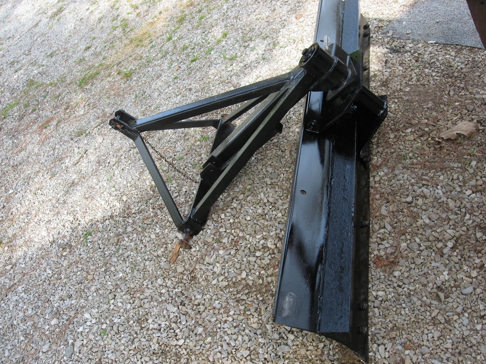

Here's what a better rear braced rear blade looks like. It also has offset and angle.
