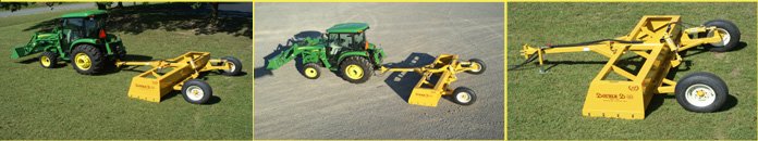

An old John Deere A with one of this style 8 ft. scraper moved lots of dirt faster than a dozer blade could have.
Double D Series Box Blades and drag scrapers
