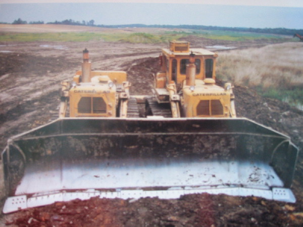

The Komatsu D575 Suer dozer is bigger that the Cat D11R. However my understanding is that it only runs for a week before it breaks down for two.
The D11R is 850 net horsepower, up from 770 in the D11N. This finally surpassed the DD9H (the two D9's front to back or side by side).
JT
/ DOZER #43
I hear ya. 575 is really hard to haul I understand. They have to take the tracks off I think.
The D11 just needs the blade and cab removed and your ready to go.
