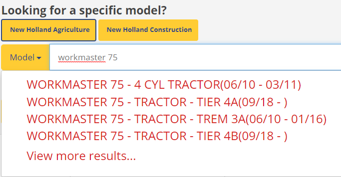

I have the newest model Workmaster 75. Production started 09/2018, mine is a 2019 model. It uses DOC, so no regen was a big part of the decision to buy a NH. There is no mention in the operator's manual of emissions systems or how to operate the tractor to meet the needs of the DOC system. PTO speed for mine is 2000 RPMs. Even when not using the PTO I run it at 2000 RPMs. I know what the MPH is for the gear combinations I use at 2000 RPMs and that seems to be good for loader work. I doubt a plugged DOC filter will be an issue for me in my lifetime.
I did test drive and get quotes for the equivalent JD, MF, and Kubota models when I bought the WM75. The WM75 came in at the lowest price and I like the dealership, 4 Brothers in Terrell, Texas. No regen and being partial to the NH brand, my decision was not difficult. I paid $46,000 for 2 hats and they threw in the tractor.
