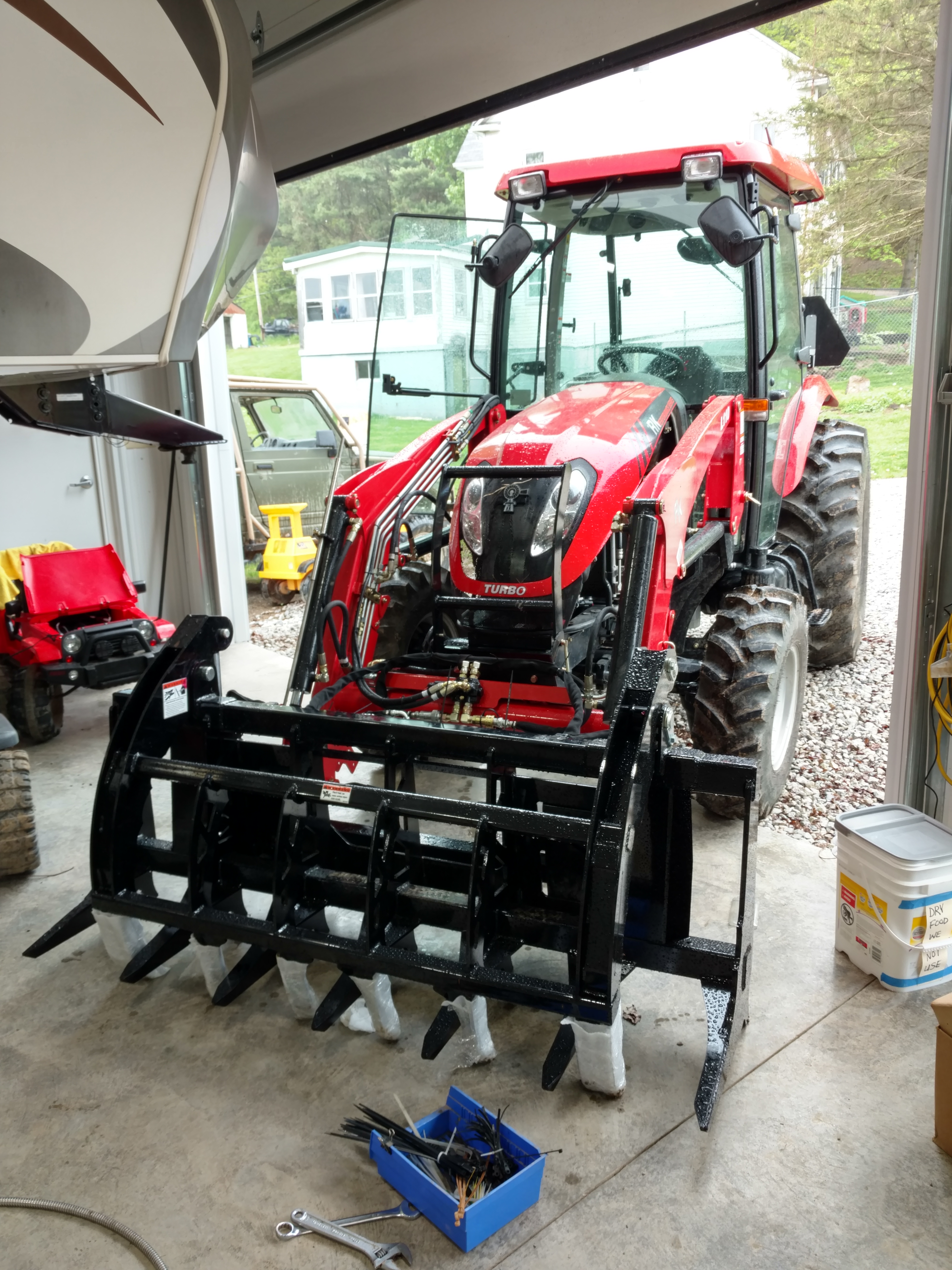

It is a true 3rd function. The joysticks on the 37 and 55s come standard wired with a switch on the handle. The raise/lower and bucket tilt operate the same and the switch moves the 3rd function, in this case squeeze/open the grapple.
No, it is a diverter valve. Hold the button(it is not a switch) and use the curl/side-to-side function on the joystick to operate the "3rd function." Not that that is a bad thing. I have one. It works great. Purchased the granite grapple through RK. I love it. I love the tractor. Can't beat the price for this level of quality. I have no need for a true 3rd function, diverter is fantastic. View attachment rkt.jpg
