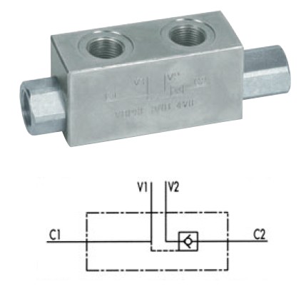

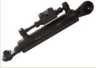

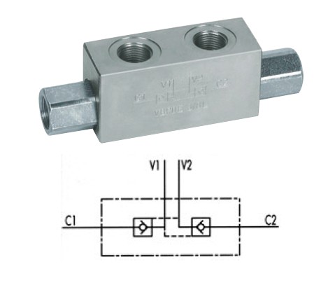

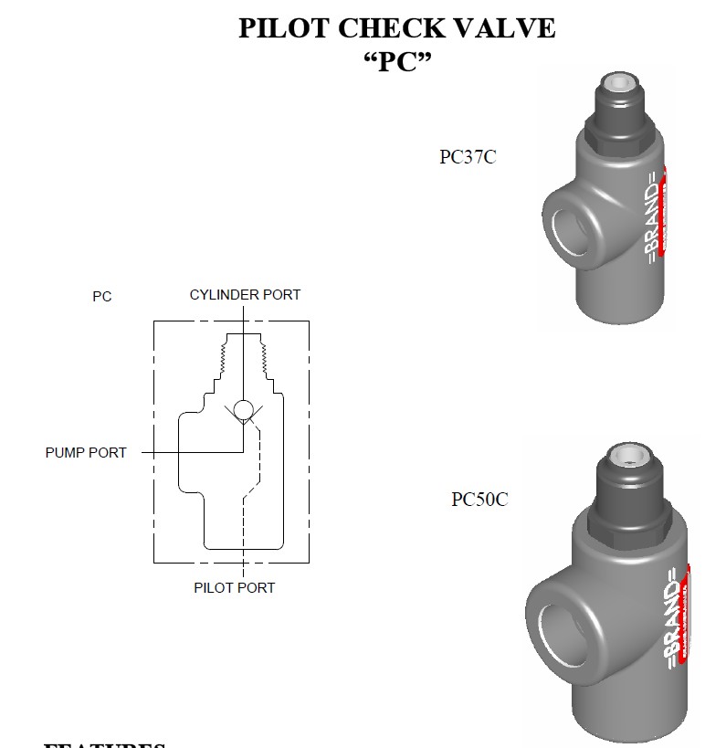

Ok, but on the Brand PC valve you pointed out (photo one) the pilot port would still have get cracking pressure from the other end of the cylinder, so it would have to be teed into the capped side of the cylinder. Right?
If so, then the single piloted check in photo two would do exactly the same thing, although because the pilot fluid's path is internal, the valve and its external plumbing would still look like the usual top link DPOCV setup (photos three and four). However, the valve itself should naturally be somewhat cheaper than the double version, and only one end of the cylinder would be locked. Correct?
Sorry for the high density of my brain cells on this subject. I've worked in electronics for 50 years, so I can do that in my sleep, but I've only played with hydraulics for a few weeks, and it's like first year algebra to me. :laughing:
This one will do the same as the Brand one....I like this one better...
