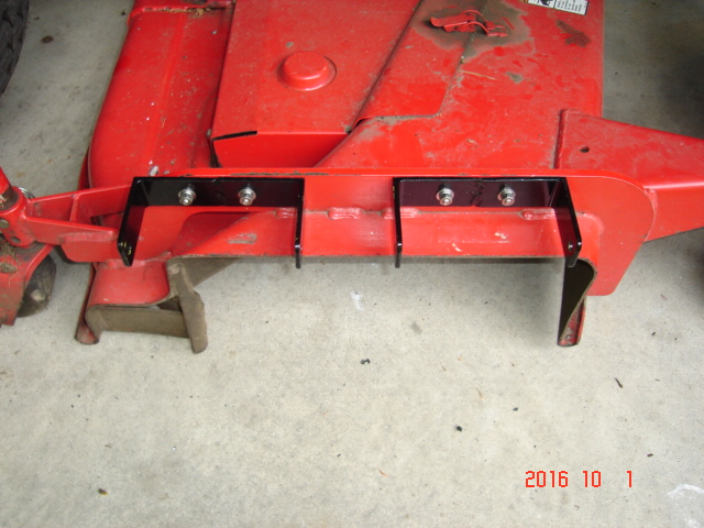

Some years ago I simply removed the flapper-damper thing on the MMM so I could fit the tractor/MMM into my narrow parking space, so I didn't have to deal with that at all. Took some time to cut the plastic MMM attachment piece so it would fit my deck, but that came out OK, too. I just leave the two mounting brackets on all the time, which used the existing flapper mounting holes; each bracket was made from two 90-degree steel pieces welded together.
