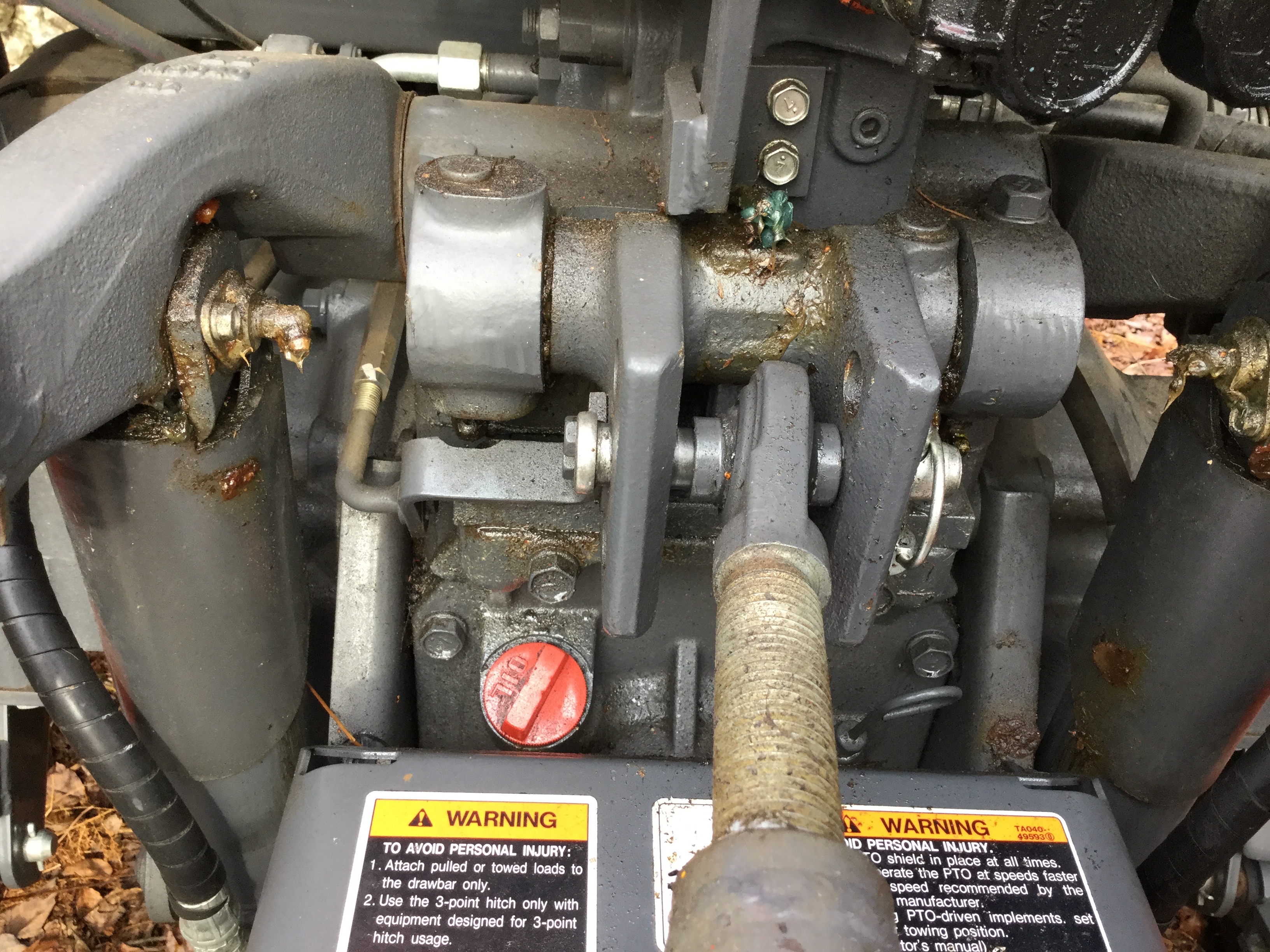

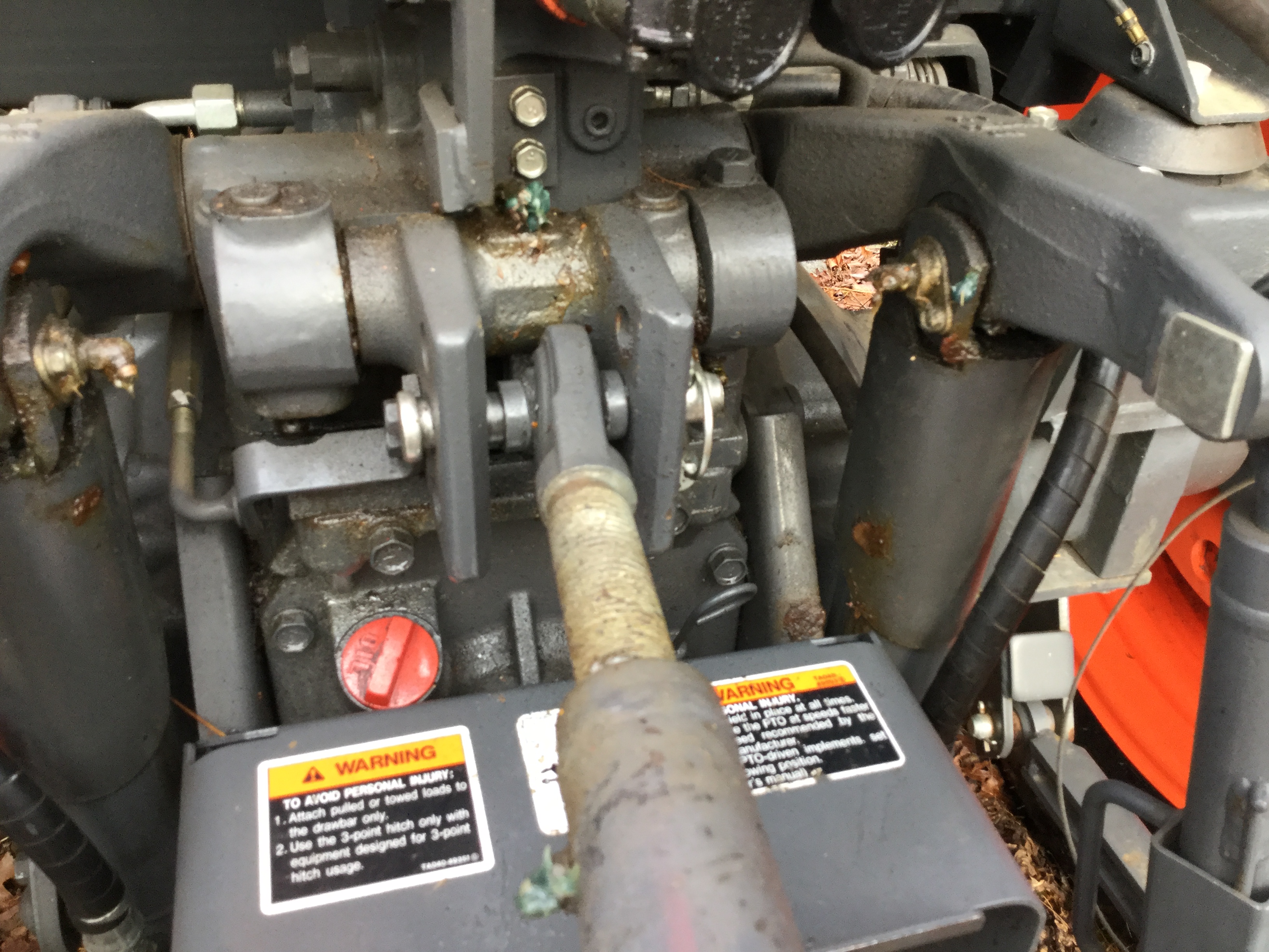

I've got my m7040 with a Wood 3496, without feet, on the back.in MD for the Winter. Only had the opportunity to use it twice this year to clear snow. I've got a good run of blacktop. My neighbor has gravel. My last go I did only mine and notice I did a pretty good job of scalping a few high spots. Not really what I wanted to do. If I would have been doing the gravel I think he would have gotten a bad grading job along with clearing the snow. Not the desired outcome. I've got the top link of the hitch on the middle hole.
Any suggestion in positioning on the hitch...should I move to top hole to get better feedback?....and use of draft, if applicable, would greatly help speed up the trial and error phase I'm in right now.
As always, thanks for the help in advance.

I'm not sure that snow will put a big enough load on the system to be able to take advantage of the draft control. I guess set it to be as sensitive as it can be and try it out. Typically the top pin location allows the implement to be raised basically level instead of in an arc.
You probably should read your operators manual to understand exactly how YOUR hitch works. All hitches are not the same and do not have the same geometry.

I have no first hand experience with draft control, but I always thought it was used for heavy ground engagement like plowing and box blade use. When my driveway was gravel I spun the blade around and lowered if all the way down with satisfactory results. On my current driveway (500' paved) I pull the blade forward as intended with it lowered all of the way (floating).

What do you mean by "get better feedback"? I think the only feedback you're going to get is if your neighbor complains. :D
Here's an interesting discussion on top link attachment holes and draft control. http://www.tractorbynet.com/forums/owning-operating/71760-top-link-attach-hole.html
I didn't read the whole thing. And I'm not an expert. But my 2 cents are:
Draft control is really for ground engaging equipment, like plows. Not really applicable for snow blades.
I think the top link attachment holes are more to adjust the "range/sensitivity" of forces that the draft control sensor experiences rather than to level attachments. (Note that the top link connection is probably not "fixed" mounted to the tractor but probably goes into a mechanical arm (draft control). Chances are if you look at the top link holes, you can see they basically magnify or reduce the leverage that the tractor's top link exerts on the draft control sensor. Sort of like a low/med/high range connection into the draft control sensor. So if you're going to try to use it on a snow blade, I think you'd use the most sensitive hole.
That being said, which hole you choose effects the angle of your attachment. But adjusting the length of the top link has more of an impact.
How you adjust the length of the top link will determine the angle of the blade as it contacts the ground. This angle may determine how aggressive the blade is and what happens when you catch an immovable object (will it slide/pop over it or will it catch and bend blade or stall tractor?)

Moving between the hole definitely changes the angle of the blade quite noticeably. On the blacktop I want to 'float' without any additional down pressure. The blade is quite heavy and simply pulling it along should work fine. What I don't want is the effect I get on the bucket when. Putting too much into it lifting the front wheels off the ground. I'm good with a 1000 pounds dragging on the drive, but don't want an additional 5000 pounds on it.
/ Draft control using back blade to plow snow #8
Oh, from the above picture, I guess the bottom hole is the most sensitive input into the draft control.
Are you sure you can exert down-pressure with your 3 pth? I suspect not. Most tractor's 3 pth's can only lift and will float up when lowered (i.e. they can't exert a down pressure).

With your tractor, the ONLY down pressure is the weight of the blade and hitch arms. There is no down pressure, as can be exerted with the loader. The hitch arms can always float up until they have reached the upper limit of their travel.

3PT Hitch always floats. Some of the cuts have downpressure kits but thats it. I don't think draft control is going to do what you want it to. Get some skid shoes until the driveway freezes or offer to rake gravel in the springtime!

Thanks guys. Skidshoe kit for the backblade it is. Appreciate all of the feedback.
