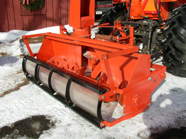

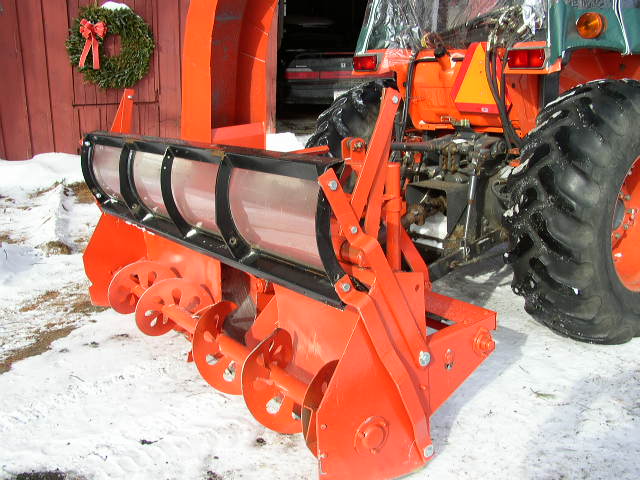

Well it didn't snow here in December or January so the modification of the snowblower has continued. The drag blade moves up out of the way now and operation is hydraulic. Also added a linkage to turn the chute. We finally got some snow to test it on - it works!
Here are pics showing the blade on the blower, and the neat job it does in front of garage doors.

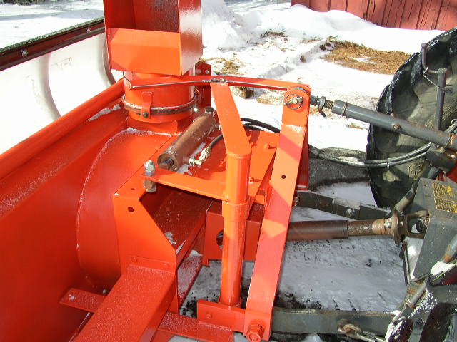

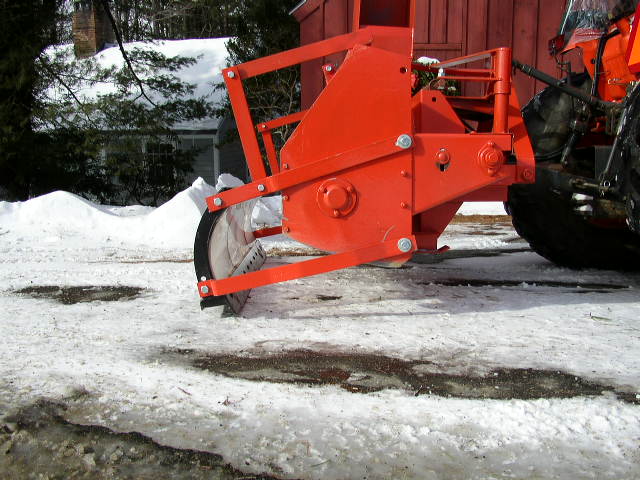

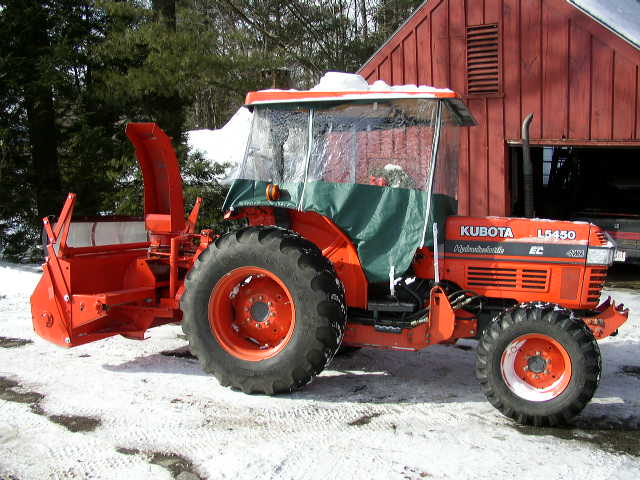

Here are some more pictures of the project. This blower is 35 years old at least (see pics at the top of this thread taken in November)- but we took advantage of the warm days in January and sandblasted & painted it - looks new now. The drag blade linkage was fun to figure out - did it in AutoCad, using dimensions from cylinders I got cheap on eBay. The control valve (also eBay) has a float spool so the blade can follow the ground independent of the blower. Linkage arms are 3/8" x 2" steel. Using a single cylinder and a crank tube keeps the blade level with the blower. It's strong enough to lift the blower with the blade - but it's best to lift the blower with the 3ph, and let the blade just float. The chute turner is like the ones on Farm King blowers - a curved swing arm with cable wrapped around the chute - simple and effective. Cost-wise, I'm in this whole project for less than 10% of a new blower with this feature. (I'm considering my time as play time)
It can snow all it wants to now. :cool:

In answer to a PM question on the hydraulics - I plumbed it with hoses and fittings from Discount Hydraulic Hose. The tractor has a 13gpm pump - I wanted a control valve with large (3/4") in-and-out ports so the power-beyond system to the 3ph would be free-flowing. On eBay I found a Cross BA 2-spool loader valve with power-beyond sleeve and a float detent on one spool. The control valve's inlet and power-beyond hoses connect in place of the FEL hoses (when the loader is removed) or can connect to include the loader when its mounted. The cylinders are piped with 1/4" hoses and fittings which dissipate some of the hydraulic energy - makes blade and chute motion less abrupt. (Thanks to Mad_Referee for confirming this would work) One last feature, the linkage is designed so with cylinders at full stroke there is no force on it. This is so the huge hydraulic forces don't tear it apart.
