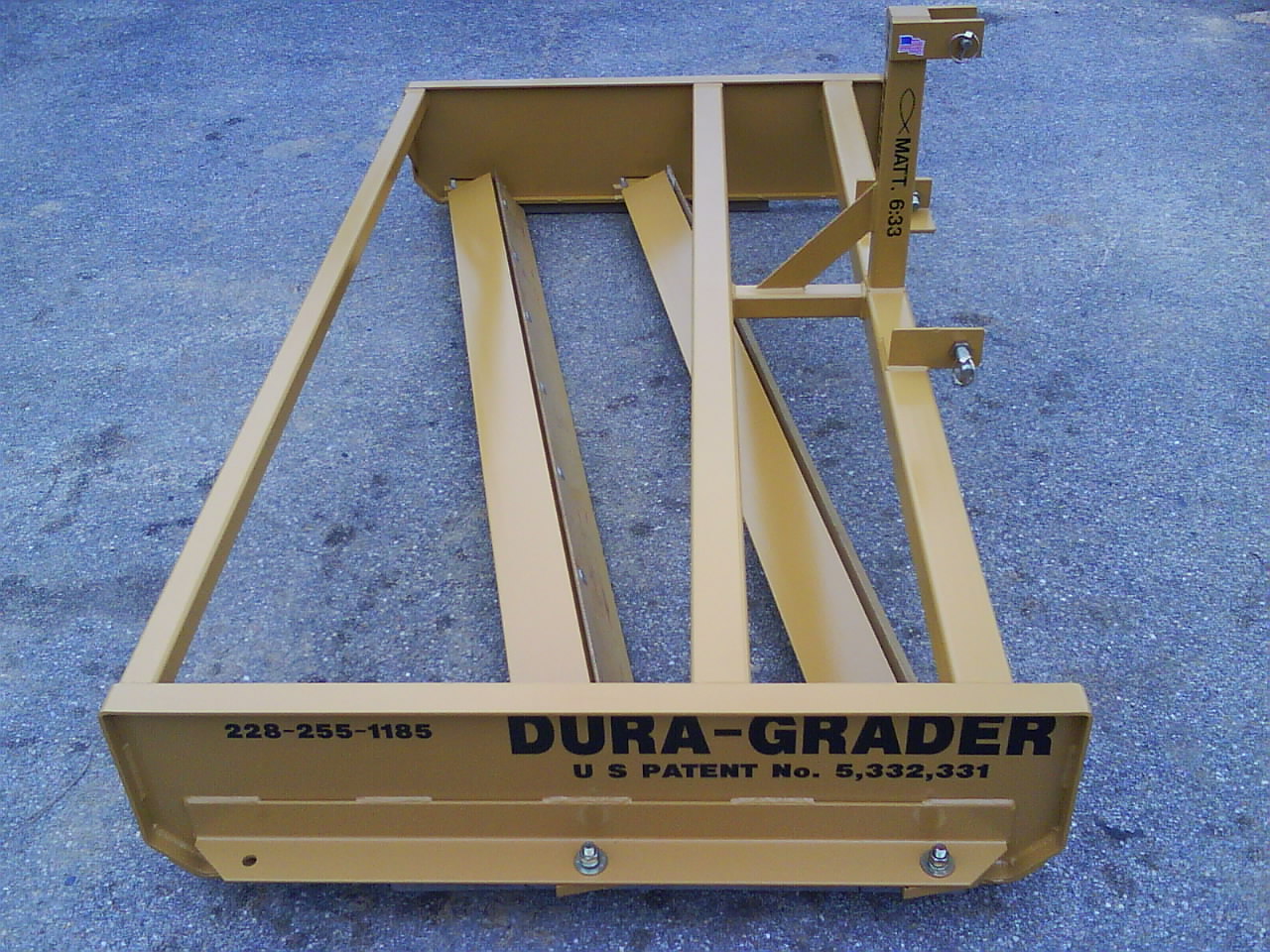

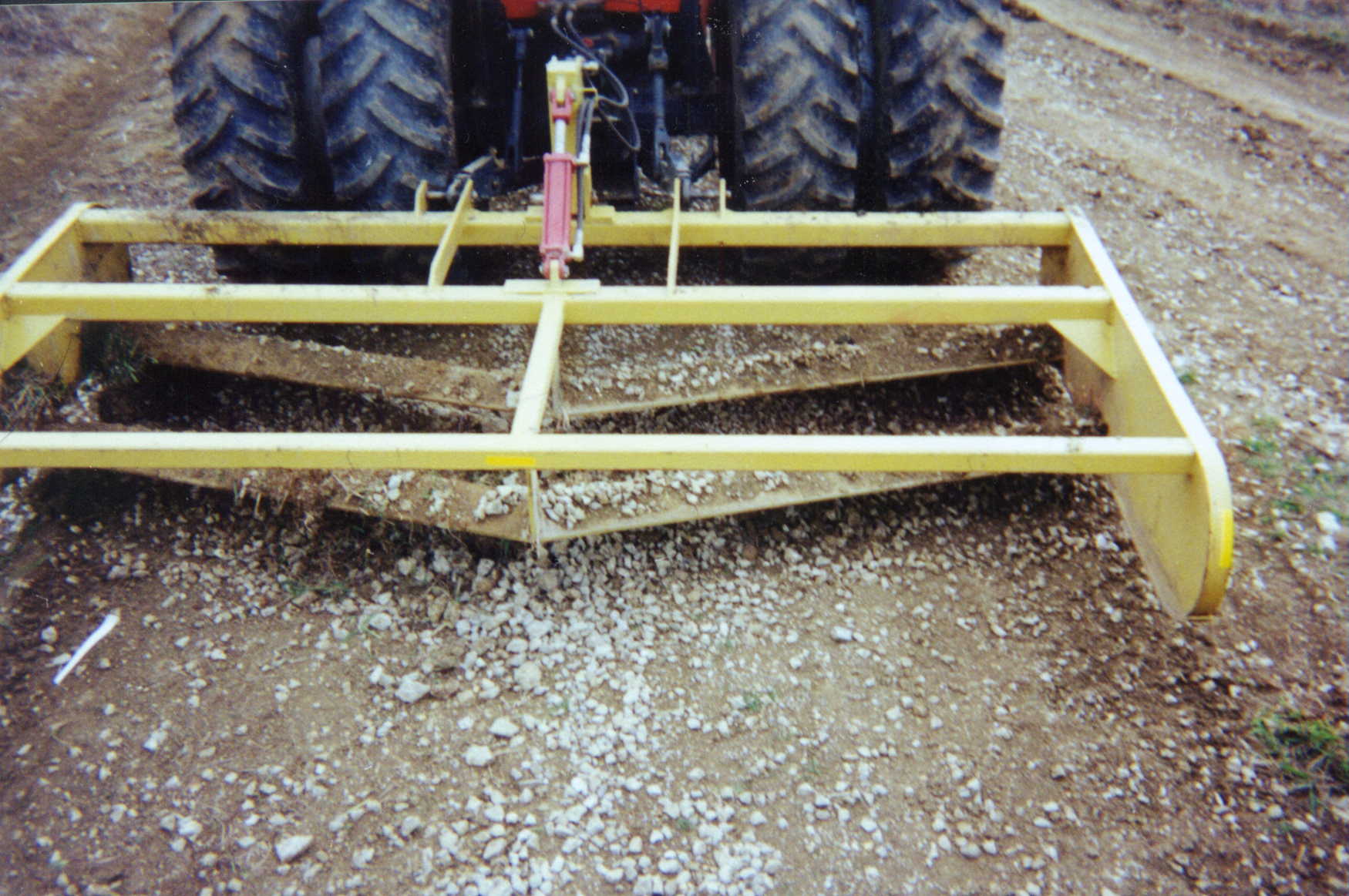

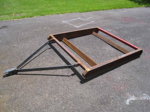

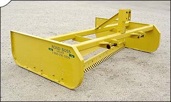

Just some more pictures for your consideration.

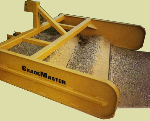

Just some more graders.
