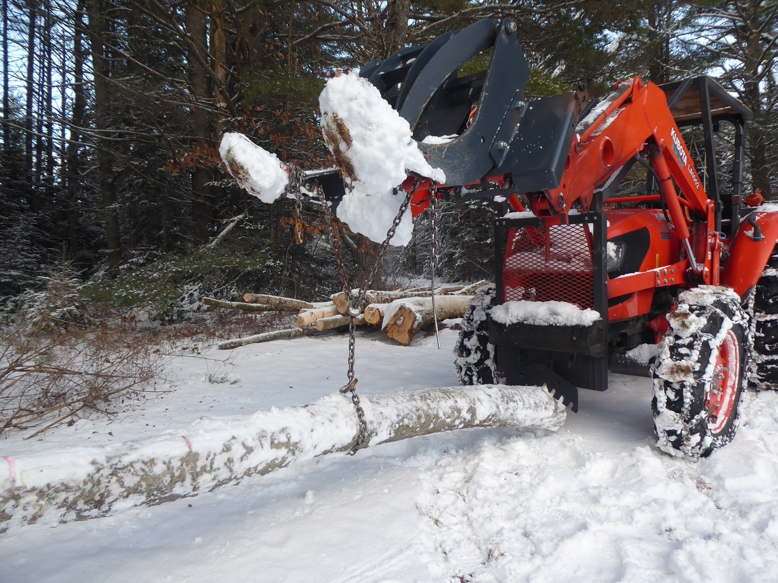

In my case I plan on two 8' panels to span 6'. Each panel will have 6 - 6X6 and 7 - 2X4 to make up about 4' wide. It will be eastern hemlock or southern yellow pine and weigh less than 1000 lbs - probably around 800 with green lumber less with dry. I will place it like this.

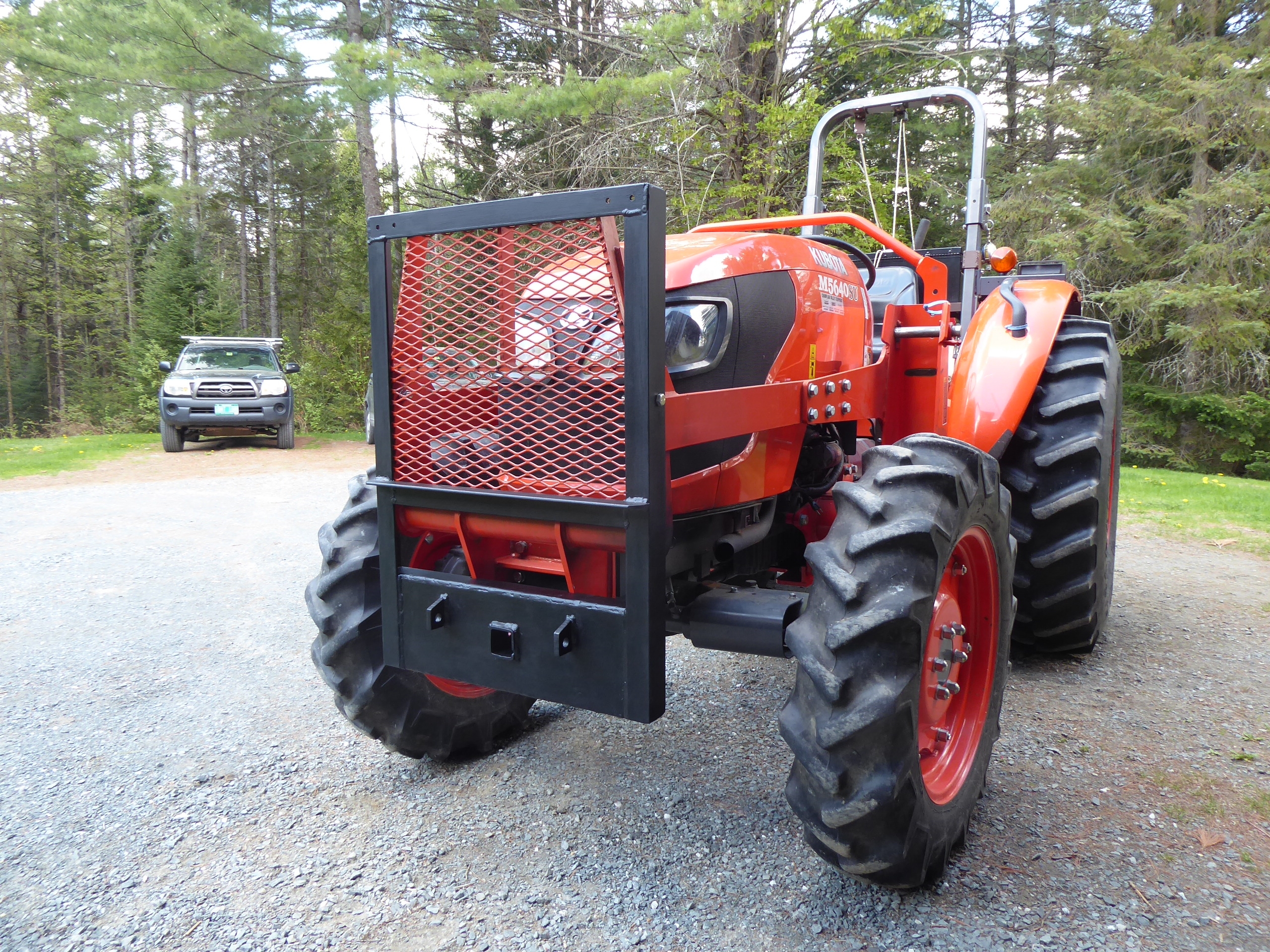

In this picture, you've got that V plate under the grill guard to hold the log in place, but how do you plan to anchor a 4' wide panel?
You mean on the abutment ??

Sorry, no, I mean how will you anchor the 4' wide panel when you lift it with your FEL so it can't swing back into your radiator, etc?
Id you mean anchor the panel to the tractor ? Maybe the V will work. If not I'll take it off and there are 2 shackle lugs right there that I can use. I'm sure I can make something work.

Side to side movement of the panel during transport could rip a tire sidewall.

Yes sir it could.
