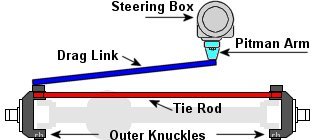

I own a John Deere "LA". Does the drag link attach from the steering box to a front steering spindle and the tie rod connect from spindle to spindle?
I need to change either the drag link ends or the tie rod ends. Could they be called the same, according to who is talking? I was brought up on a tobacco farm, but never thought about it.
Thanks, BillyG
   / Drag Link/Tie-Rod Installation Tip #4
The way I learned it, the tie rod goes from side to side, "tieing " the wheels together for steering. The drag link can run front to rear or side to side, but connects the steering gearbox to one spindle or to the tie rod.
Bruce
PS: learned on an LA, too. :)

Appreciate the words of wisdom. You would be surprised at the number of people I've asked and they would scratch their head and wonder. Now maybe I'll get the right parts when I order.
Many thanks, BillyG
