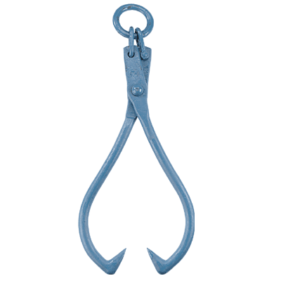

Find a friend with cutting torches. Get some steel bar and weld to an L shape one side 12" one side 5". On the top of the (12") L have a hole for a shackle. On the 5" side cut to a point with the inside of the L being the knife side. Make a pair of these.
Now with the two Ls turn the insides towards each other. Connect together with a shackle so the Ls scissor together.
Hammer the spiked Ls into the log, attach chain and drag away.
TIP. Use a shackle on the drawbar to drag a log. If you use the 3pt hitch BECARFUL, if you lift the 3pt you can change your center of gravity.
Bluegrass, Pick It Up!
   / Dragging Trees #17
TheBoman,
That description sounds interesting, but it lost me. Do you have a picture?
Patrick
   / Dragging Trees #18
Are you creating skidding tongs? Like the attachment?
Rich S.
