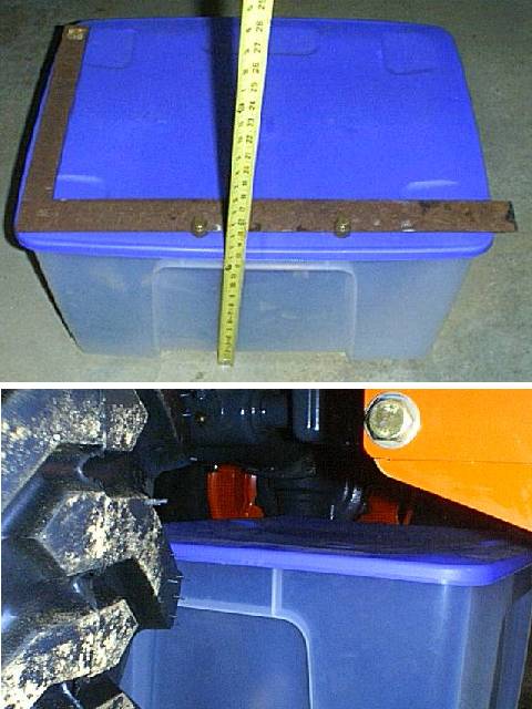

Junk, here I stand beside myself corrected,
the container measures 24long x18wide x12high,
it slips right under the BH90 subframe and allows about 5" for hands and tools to get at the engine and tranny plugs. The pics are mediocre 'cause the camera was a gift.
Martin

Thanks for the suggestions! I did find several models on the Northern Tool website but really did not want to spend that much. I'm going to try the storage bin idea. That has to be a very cost efficient solution.
   / drain 11.5 gallons of transmission fluid into what #16
I think that I will give that container consideration. I just hope that the wife doesn't miss it when it comes time to use it again. This discussion reminds me of a similar one a year and a half ago discussing a turkey roaster pan.. /forums/images/graemlins/grin.gif /forums/images/graemlins/grin.gif /forums/images/graemlins/grin.gif
