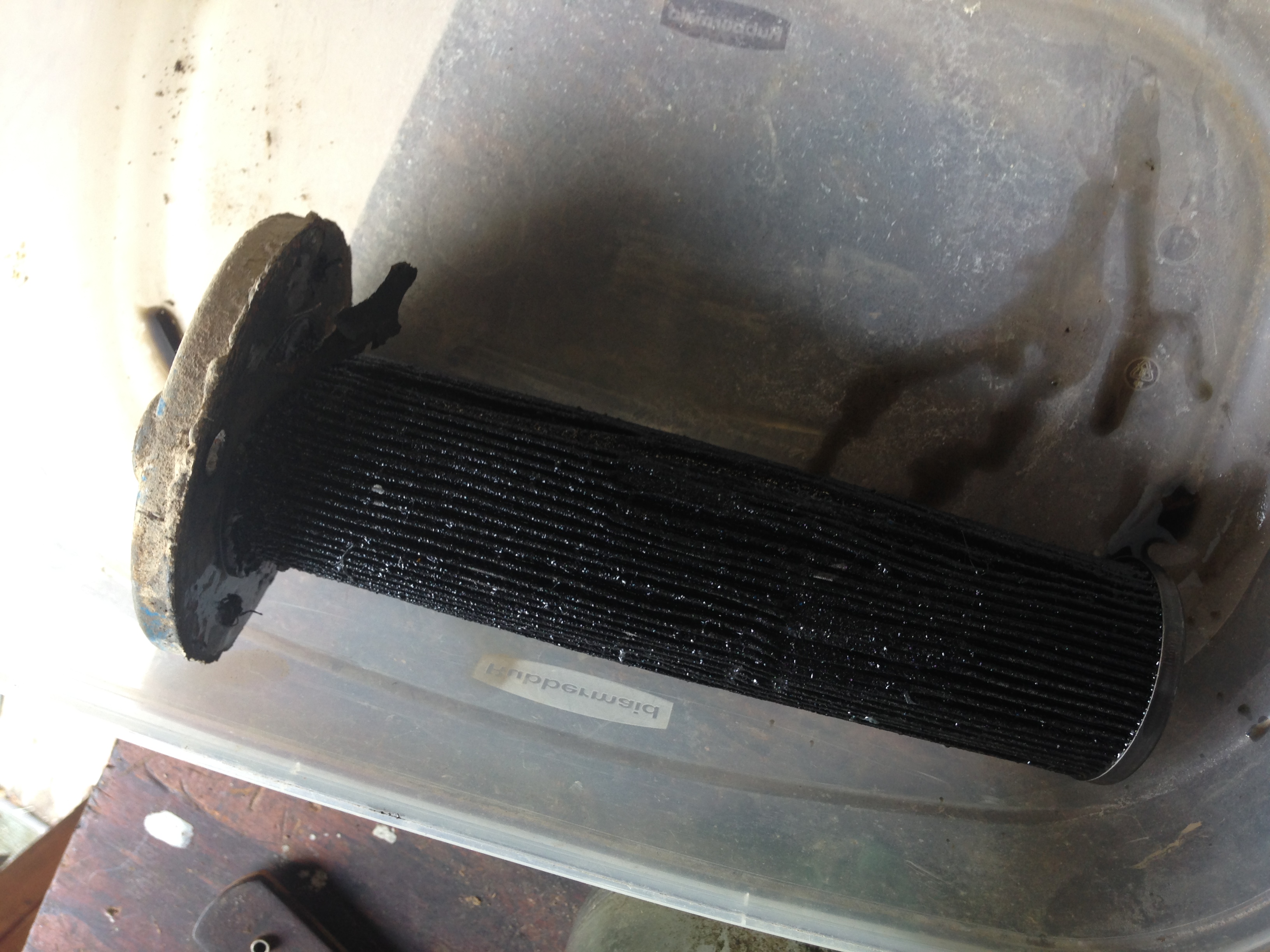

i have a ford 1700 4x4 tractor,i want to drain my hydraulics,there is a bolt under the axle that holds the oil,but i dont think its use to drain the hydraulics,there is one for the transmition,i hate to take it off and its not the hydraulics,does anybody have a picture that would help me?

On 99% of tractors the transmission is the hydraulic sump. So hydraulic fluid is the transmission fluid. Often drains in multiple places to get various low spots like final drives on the rear axle in addition to the main drain.

my hydraulic not picking up,very slow then it stops,now it wont pick up,i'm hoping its my screen my question is i have two drain plugs,one under the transmission and one under the rear axle,thought it was another tank jus t for hydraulics,first time doing this,wanted to be sure not to mess up,i know about the screen just wanted to see if thats my problem,never took it off. its takes a impact to get this off

The description fits the symptoms of a partially blocked suction screen. You should not need an Impact Gun to remove the Suction screen on any tractor.:eek:
Drain both Trans and Rear axle. Inspect the oil for water ('Creamy/Milky' colour?) and 'Glitter'. Also, check the screen for metal debris .

have to use a impact just to loosing the bolt not all the way,drain the oil,the oil looks pretty clean haven't remove the screen yet,i will give u a update,

The oil dribbling in the bottom of your container is a pretty ugly colour. So is the screen. How clean did you get it?

soak it in gas for a while took a soft brush rub it back and forth until i can see thru it,blew it off with air,let it dry and repeat the process,very clean,just went got 5.8 gal of 303 oil,made sure i don't have any leaks crank it up let it run for 5 min idle,and still the same cannot raise my bushog or anything,do i have to bleed the air out or something because i don't know

No. pretty much self-bleeding. How's the steering or FEL (if fitted) operation?

steering is fine,i let it run or idle for 10 min,,,still no lift,maybe its the pump?
/ drain plug for hydraulics #14
Could be. Going by the colour of the oil and filter, I'm sorry to say, I think you might need local specialist assistance.

I repeat: Your oil is a bad colour - So your pump may, indeed, be in poor shape.

If you put a new pump into a contaminated system you probably just wasted a new pump. Lots of lines, passages, cylinders & motors for contaminated fluid to hide in. Contaminants are liquid sandpaper & will destroy the tight tolerances in a pump & other parts in no time.

i put 6 gal of 303 oil in the tractor,travel about a mile,came back empty it all out,checked on the screen which is still clear of any trash,then i put,5.8 gal of 303 oil took it for a ride again,put the tractor in a deep ditch,head first,made sure the oil is going toward the pump,now it works fine,pump is ok,maybe it had lot of air in the pipe,anyway it working
