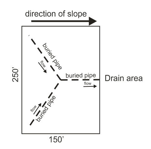

Dig a trench, lay 4" corigated pipe in the trench, soild pipe for the main pipe then you put in several Y's of perferated 4" pipe leading into the main pipe (solid pipe) which leads to your watering hole. Then cover the pipe in gravel, and fill the rest in with dirt. This may be hard to picture. Sorry, it's hard to explain on the internet.
Stefan
   / Drainage Problem/Watering Solution #7
Just found this drawing. It should clarify my last post a little bit. It doesn't have to be built to that scale. It could be larger or smaller, it also could have more "Y's".
