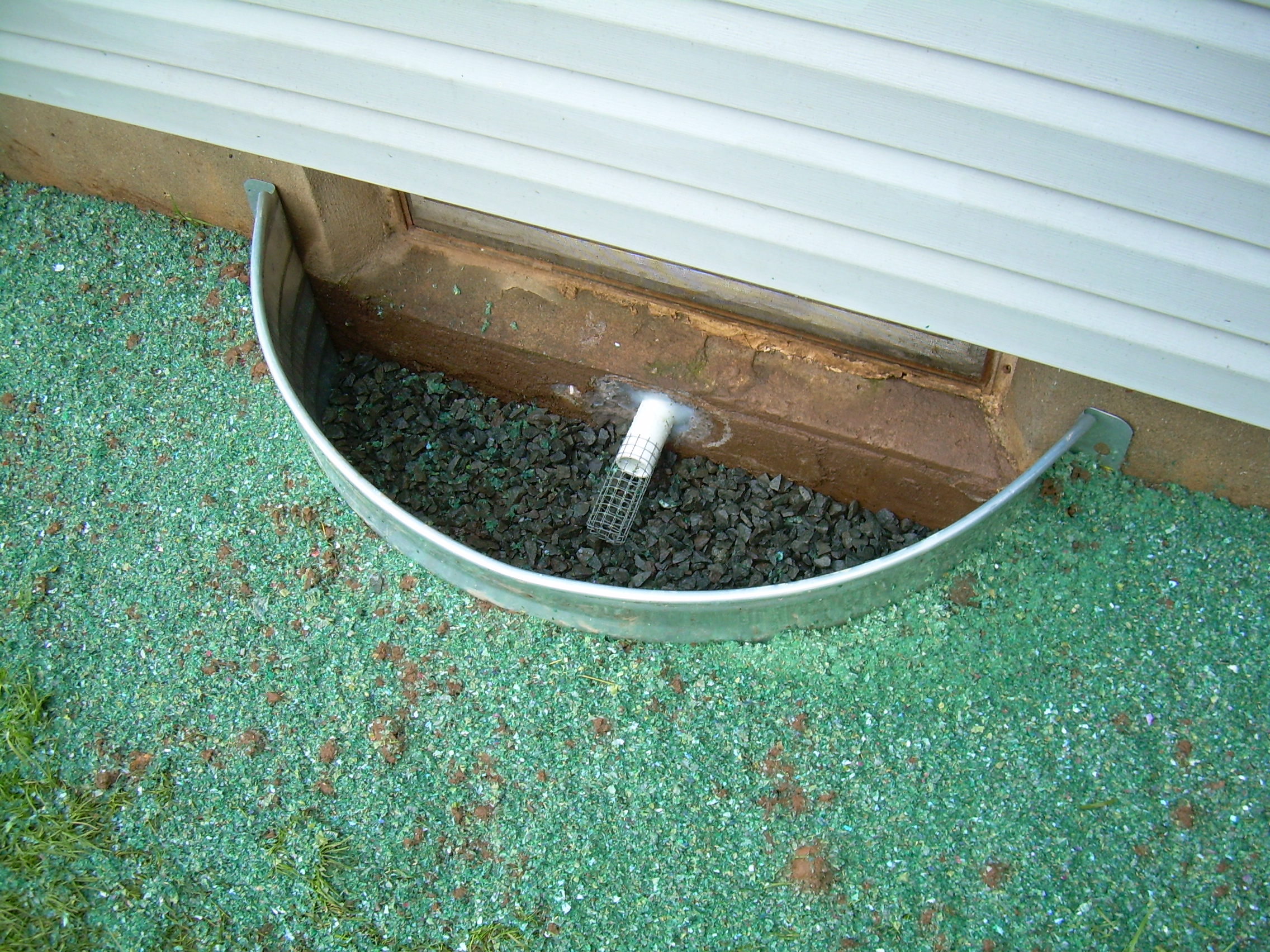

DON'T put your down spouts and foundation drain in the same pipe. You are asking for trouble. Keep them separate.
Good advise,
To Bolster the point, here's a direct quote from a proposal I just wrote this past week for a condo association.
  • Alternative, would be to install gravity drains in each of the window wells, tied into the existing underground roof leader drainage system. This approach would not allow for a written guarantee and in fact could potentially cause even more flooding than previously occurred in basement. If the existing underground storm drainage system backed up, caused by excess runoff from the roofs and parking areas, water would flow in reverse and surge into the window wells.
All parties need to be aware of this, as contractor assumes no liability for such an incidence. Storm drainage system backups are a common occurrence and as such we would not recommend this approach due to the increased flood risk exposure.
Ideally basement drainage systems are kept isolated from all other storm water drainage systems, due to the threat of storm water backup as mentioned above.
Cost, $
End qoute
I gave them this option cause that's how another contractor bid the job and they wanted my price to do the same way.​
This same contractor did another units window wells the same way and it it failed twice so far, each time he did additional work, he charged them for it :confused2:​
I normally do what I call a window well overflow drain that ties into the existing interior sub-floor footing pipe. It's the only time we intentionally direct exterior water to the inside, but in most cases it is the only option. We give a written guarantee and never had one fail.​
JB.​
Now that would be the a bad irrigation system! Knowing some, they may just ask to throw a check valve in under the window sill in you pitcure.. :mad:
We had another downpour yesterday and I can certainly attest if it was configured as your client asked I would have gotten back pressure into the drain tile... As is, I've still got to take care of outlet downstream grade, I had the drain tile outlet fill with dirty water and fill with mud at the end. The 4" PVC pipe outlet worked great again so I'm done with that with the exception of backfill.
