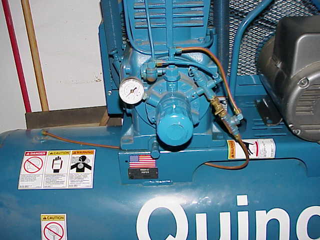

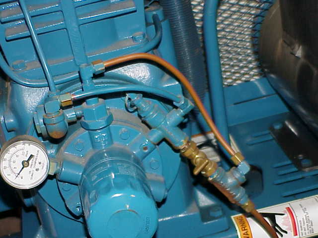

Here is a picture of my Quincy QT25 compressor. As you will note, there are a couple of copper lines. The copper line with the twist valve in it, causes the compressor motor to run continuously without shutting off when you turn it. When the compressor brings the tank to the shut off point, the compressor disengages but continues to spin the flywheel. This is for faster recovery. It is a feature that I rarely use. Which line would I cut? Do you have any idea, because I don't.... thanks Junk....

another view......

Junkman, one of those copper tubes must be the unloader but I have no idea which one. My compressor is similar to the one in the write-up so I had no problem figuring mine out. If you have a parts diagram of your compressor you might have more luck finding the unloader line. On mine, if the unloader line is broken the compressor will always run.
