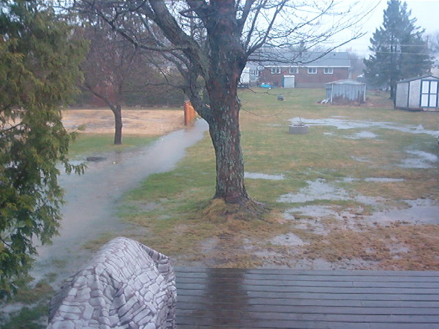

i have a spot inbetween my property and the neighbours that just holds water for days/weeks after a rain or spring thaw.. i'd like to pipe it out to the ditch at the road, total length about 200 ft from far end of water prblm to ditch where i can let it dump, i was thinking of using that black drainage pipe with the holes just on the top side, laying that in a trench to the ditch and backfilling with stone..heres a pic of the mess after about 2 inches of rain in 2days..this is as bad as it will ever get and goes down considerably within hours of the rain quiting...the pic shows the water i want to drain...this is the backyard i want to drain it to a ditch in the front which is about 100 ft from the near side of the puddle, overall its about 200 ft to the far side of puddle to the ditch..any suggestions, no tractors or mobile equipment its going to be 200ft trench done with a banjo!

yes front ditch is lower, trench will have to be sloped accordingly

no the front ditch is at the road(suburbia) once its there it will flow away and be outa my property, my idea was to run the pipe right down the low spot where the water is sitting, then backfill it with gravel, then level it all out with topsoil
/ draining ditch.. #6
The way the pipe with holes is designed to be used, the holes go down. The pipe collects water, but really doesn't lead it anywhere.
Use the holey pipe in the area of the puddle, then use solid pipe to transfer the water to the disposal ditch.
Latest geotech thinking is that the white, solid PVC pipe, type SRD 35 is the best for this kind of application. It comes in both solid and holey versions.

I can't see the whole area from your picture, but the area looks pretty flat and a good candidate for a mini water way. I have made longer than 200 ft. water ways with nothing more than a tiller and garden rake. Transit would be nice to shoot grade, but the next rain will tell where the hi spots are.

For OP's situation, if there is one low point in that flooded spot, one surface drain with solid pipe to the drainage ditch would be all that needed. Would be much less work, no need for perf pipe and crushed stone.
From the pic, looks like a surface drain would take care of most of that pond.

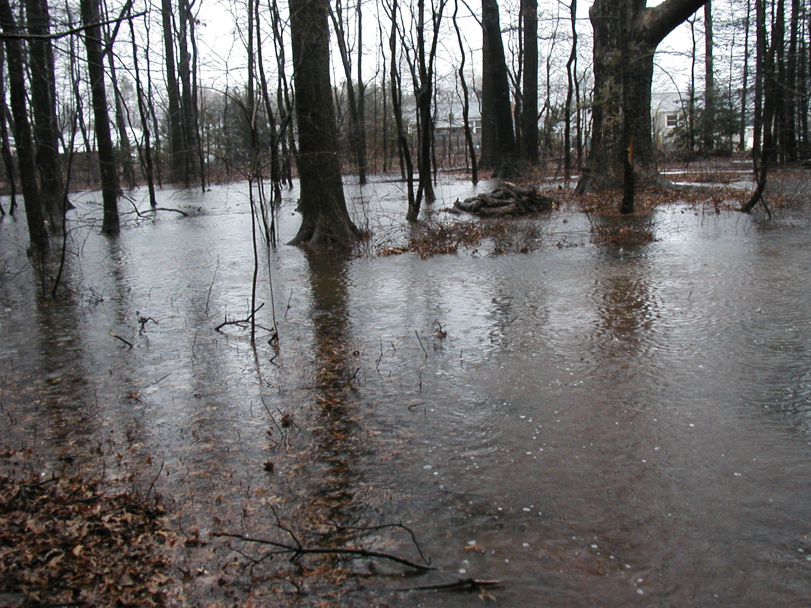

I did a long one in my own back lot, thru 2 neighbors lots. Almost 500 feet with only about 10 inches to work with. No pipe just a surface swale.
I did use a tripod level (transit) and got it as close as I could with my box blade, but with such a slight percentage of pitch, I had to wait for a few good rains to fine tune it.
Now no more flooding, just a 5 foot wide channel of water.
JB.
