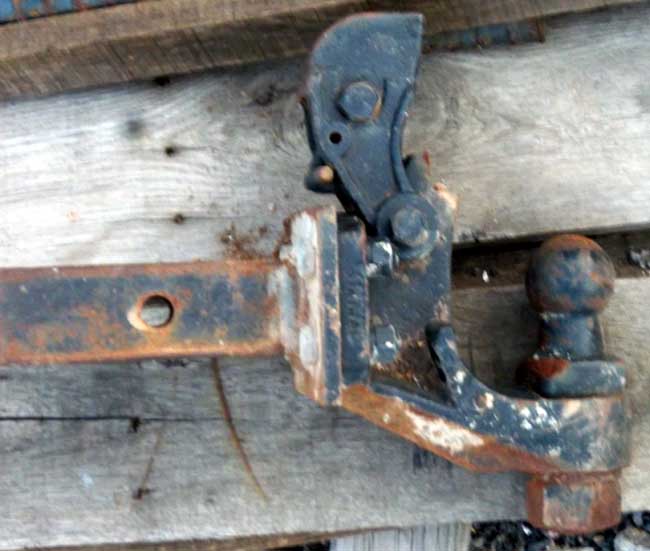

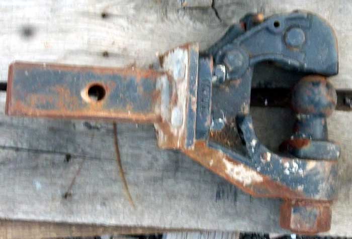

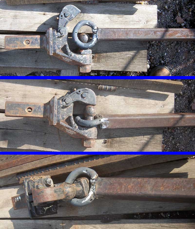

But Pintle hitches are easy to buy, just costly. In the pictures of the Pintle and home made eye, about to be used on a sheep's foot. They are also made without the ball option, I think the cost a little less.
Look and you can see the 4 bolts that hold the actual hitch. Just make up a bracket to bolt it to and attaches to your draw bar.

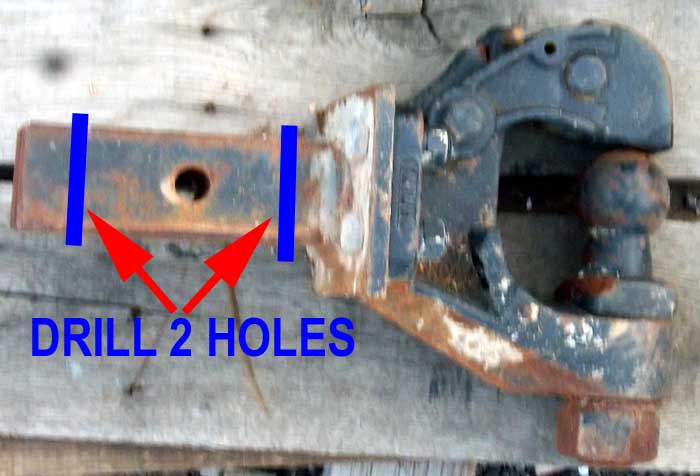

Your draw bar should have several holes in it. Just drill 2 holes in the pintle mount and bolt it down. See Picture
Even though your implement weights 5,000 pounds, it will never take any where close to that to pull it. 2,- 1/2" bolts will be more than strong enough.
Unless you are going straight UP:D:laughing:

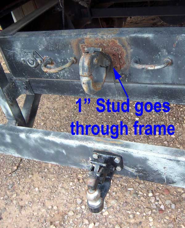

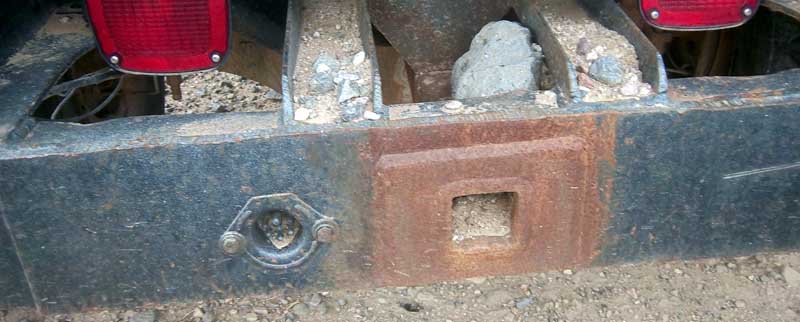

Also shown are the pintles on my trucks. One on the dump truck would lift a 747. The 2 on the flat bed not as strong. Lower one just bolts through square tubing. Top pintle is real heavy duty, but the mount area not reinforced.
