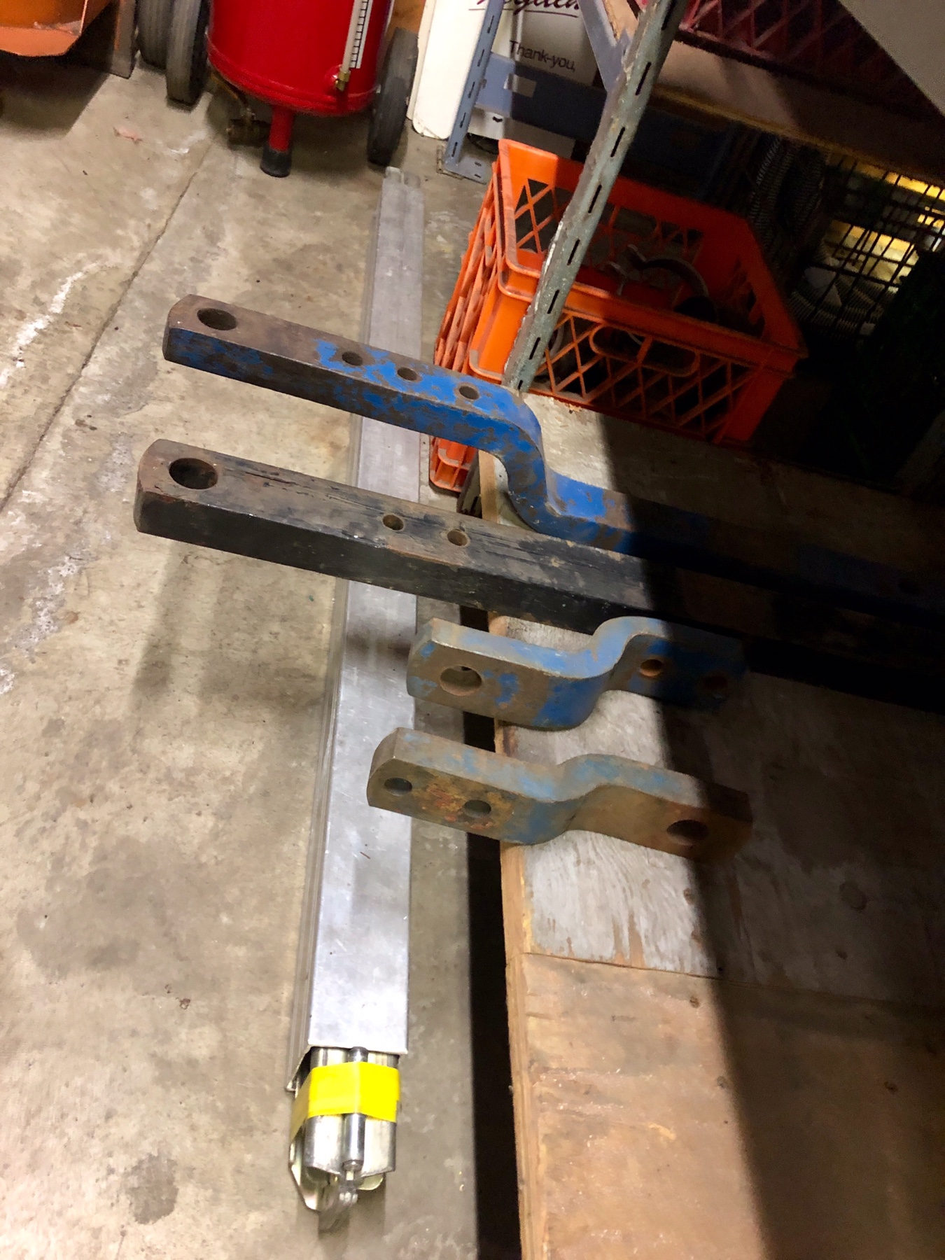

I’m not at all familiar with Kubotas. When you say “fixed” drawbar are you referring to the swinging drawbar attached under your rear axle? If so it will be either straight or offset (up or down)
If it straight, you can bolt on an offset clevis end to lower (or raise) your hitch point.
Theses are a few of my Ford swinging drawbars and offsets I have on my shelf atm.

Thanks for everyone's help. Yes, the drawbar is straight, and Big Barn's offset drawbars would probably help if there was a fit for this tractor.

Those offset drawbars, if I could get one about 4 inches lower would be the ticket.

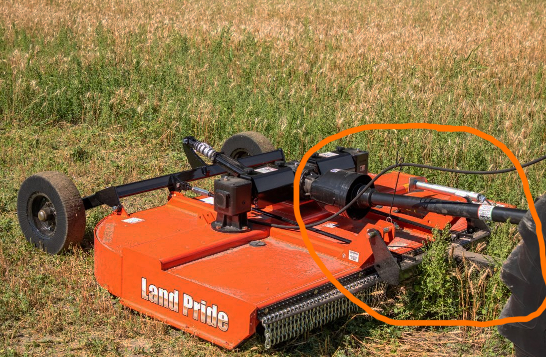

I don't think I described it very well, but it's the tongue of the cutter, a large 4x4 steel structure that goes from the tractor's draw bar to the deck of the cutter. It's very cumbersome (NOT like the one in this picture) and doesn't give the driveshaft much clearance at all. Then when I encounter certain slopes, it's in clearance trouble.
I attached a picture of a different brand and now I'm wondering the same thing I've wondered before... did they install the tongue part upside down when they put mine together? The picture of the LandPride here looks like my tongue piece, but inverted... hmm.
Also the rig in my picture doesn't look like there's much difference in gap between this tractor's draw bar and PTO... compared to mine. Hmm.
Now I'm really scratching my head, fellas. (I feel like the gullible kid people played a joke on and I can't see it.)
You can sure see here, if this tongue was upside down, there wouldn't be much room between the shaft and the bar...

The cutter pictured does not need the 3point to raise the front, it has a leveling bar that connects the rear loft wheels with the front hitch, as the wheels are raised or lowered it pivot the front hitch up or down so the deck stays level throughout the travel range.

Now I'm REALLY thinking my tow piece (tongue) is mounted upside down on my cutter, because it would look exactly like the one in this picture of it were inverted. Boy, do I feel dumb.
