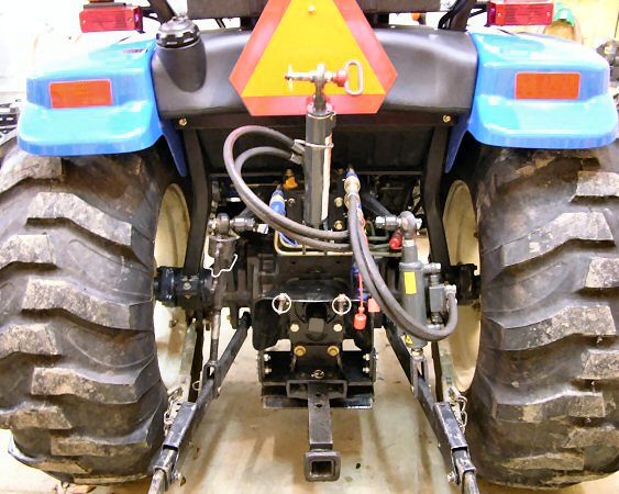

Mark, I don't know of any that you can just go buy, and now I've forgotten who it was who posted the pictures of his, but with just a little welding, you can certainly make one that works very well. Maybe the guy who posted the pictures will see this thread and respond.
Well, I did a quick search (like I should have done in the first place) and found it was Sheepman's design that I had in mind; a very good design you can see in his photos here.
/ Drawbar and 2" receiver
Bird,
That's exactly what I'm looking for, just needed that picture to make me see what I really wanted to do. I do weld so I should be able to make up something pretty easy.

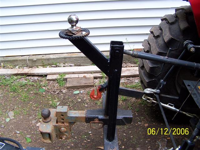

Pineridge posted a pic of his receiver welded to the drawbar but I dont know how to link you to it. If you look up his posts or pics you'll find it. Its not hard to do if you can weld or know someone who can. Just pick up a 2" receiver and have it welded to your drawbar. I chose to make a 3 pt. attachment for my receiver as shown.

OK I'll bite. What's the deal with the ball mounted on top of what looks like a bicycle chain ring?
/ Drawbar and 2" receiver #14
Mark, that top ball is for pulling a gooseneck trailer.
/ Drawbar and 2" receiver #15
Mark,
Bird is right. I use the top ball for moving a gooseneck trailer around the yard. The gear you see is just a spacer to support the trailer. (Actually its an old chevy timing chain gear I had laying in the parts box.)

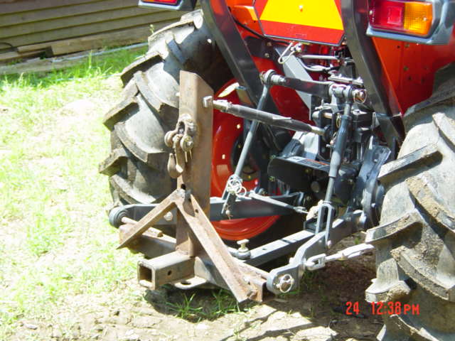

Here's a picture of mine after I finished welding it. It's Kubota Orange now, and I primarilly use it for skidding logs, but it's the best thing around to move trailers in tight quarters.
It was a hitch for a Ford Van before. I just cut the frame mounts off both sides & welded a mast on (with a clevis & grab hook).

Adiredneck, That's a good looking unit!:)
