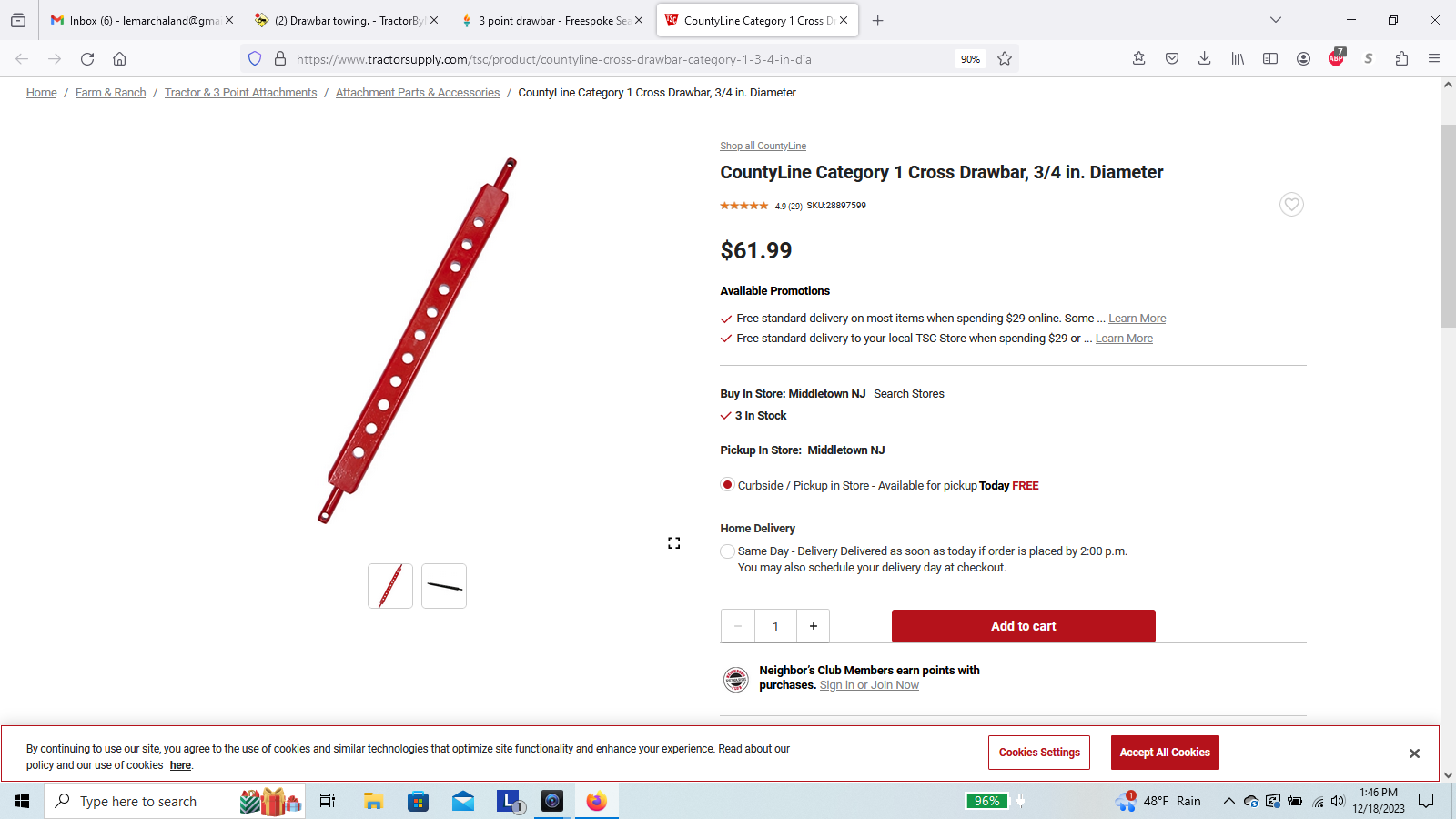

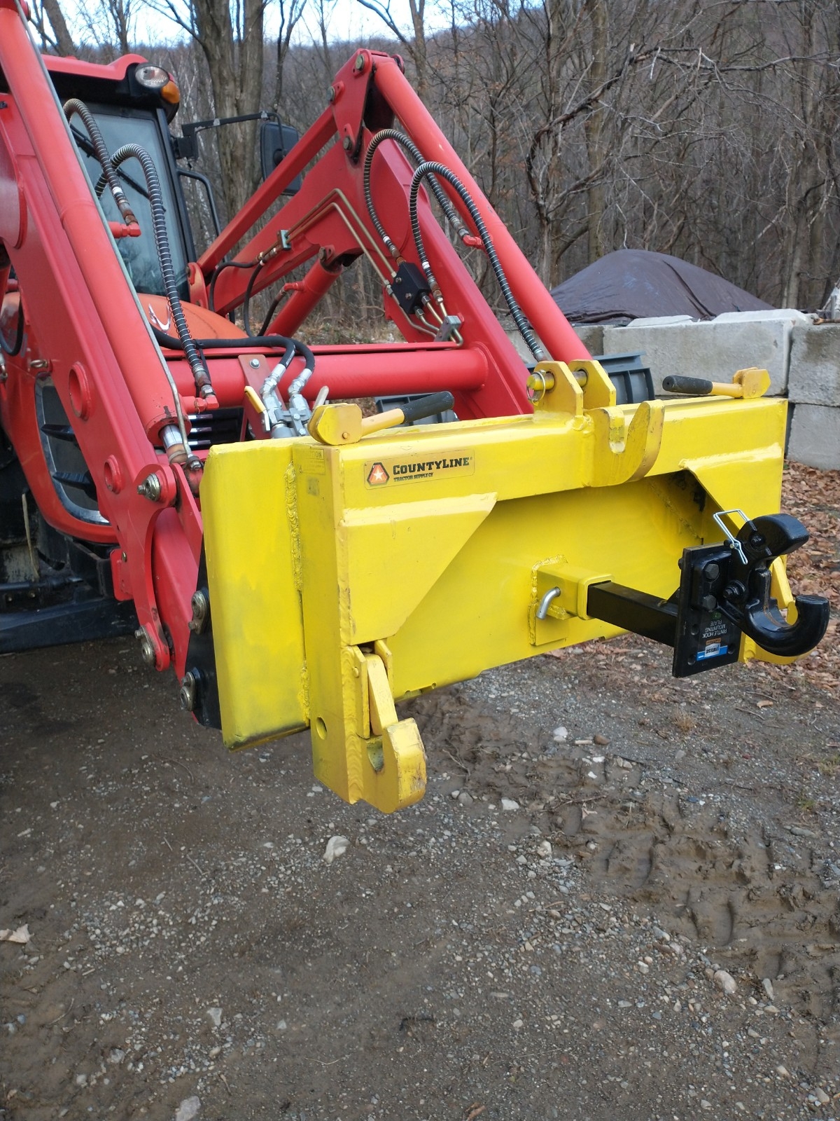

Sold my BX 25 "starter" tractor and upgraded to new L6060 with cat 1 3 pt drawbar hitch supplied by dealer. Tnought I was getting a cat 2 drawbar atrachment. The cat 1 has eleven 3/4 inch holes. I want to attach both 2 inch and 2 5/16 balls for moving wood chipper, splitter, empty flatbed trailer ( approx 3000 lbs with no load ). Tractor rear wheels are loaded. 2 inch ball is available with 3/4 shaft but smallest 2 5/16 ball comes in 1 inch shaft and up. So, can I drill one of the holes up to 1 inch or will I weaken the drawbar significantly? Are there other options, perhaps a way to attach a 2 inch hitch receiver to this drawbar? I have front pallet forks that I could possibly weld a receiver hitch to. Appreciate all thoughts, comments. Thank you.

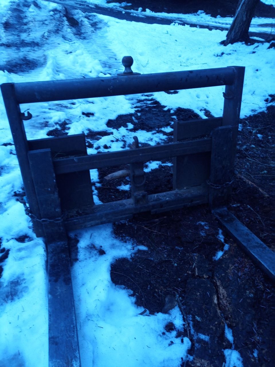

If you were willing to weld a receiver to one of your pallet forks, just burn a hole through the end of one of them, instead, and bolt your ball through that when you need it.

If it is for temporary moving of a trailer, get 1 of the End holes bored out to 1-1/16". Leave the 2-5/16 Ball in place.

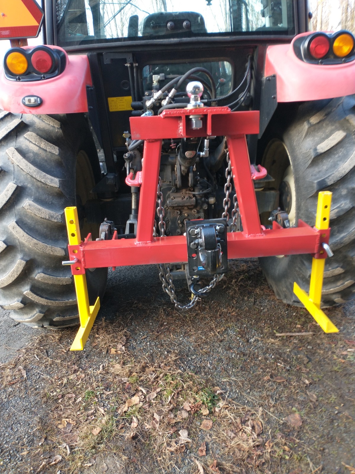

I pull a 30-foot gooseneck trailer that weighs 6,000lbs empty with both my L4060 and MX6000 tractors, using the simple 3-point hitch attachment pictured earlier in this thread. That attachment uses the lower arms and upper link so the hitch cannot spin around, with the GN ball on the top. Like the unit pictured, it also has the 2" receiver and the bale spear holes. Mine is extremely heavy duty and works very well. The trailer behind the tractor usually gets loaded to about 10,000 lbs. I stay off hills as the trailer brakes won't work with the tractor. There's no worry of the 3 point going up too far because using the gooseneck you are almost using all of the upward travel anyway. The nice thing with this attachment is you can back right under a trailer and lift the ball into the trailer.

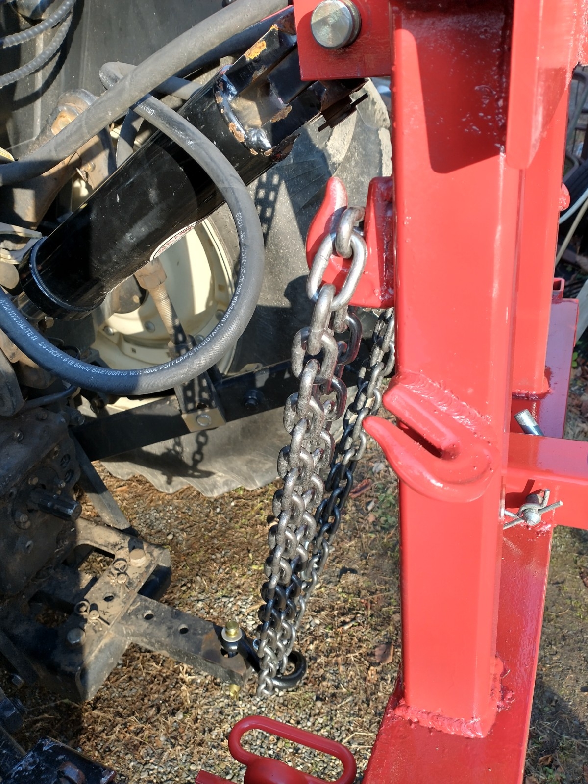

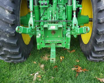

I am guessing that you are referring to this type of "drawbar"
The lower bar in this picture is the actual drawbar.
When using a pull point attached to the 3 point just be aware that there is NO hold down force in the 3 point assembly.
While 3 point hitches are handy and versatile they do require one step often over looked, a chain or other travel limiting device needs to be used to prevent trailer loading from lifting the drawbars and raming things into undesired locations such as fender and fuel tanks.
In this picture at the bottom of the picture you can see the clevis attached to the tractors drawbar and to hooks in the hitch to limit upward movement.
another view showing the chains getting tight at the top of the 3 point lift

What would you like to know. It was my second design for a three point trailer hitch.
My first was just a ball for a qooseneck on a quick hitch and we would wrap a chain around and down to the drawbar for safety
This was the second build for handling most all trailers, the yellow legs are just pined so they are easy to remove or repin with the base higher in the air. They can be removed or left on as desired and they also help hold the hitch up for hooking up to the tractor with or without a trailer attached.

There is no limiter built into the tractors 3 point to stop the arms from lifting from an external source. The hydraulics will only lift so far but the arms can usually be forced past that point easily.
My experience with 3 point moving trailer…level ground ok or back down the hill. I almost ended up dead. If it weren’t for the tail of the trailer digging in when the trailer pushed the 3 point to the top of its travel, broke the ball and started up over the tires (towards me) I wouldn’t be here to write this. It happens fast beware.
Which is why I always recommend a chain from the hitch down to a solid part of the tractor to prevent the three point from being lifted past it's design height.
