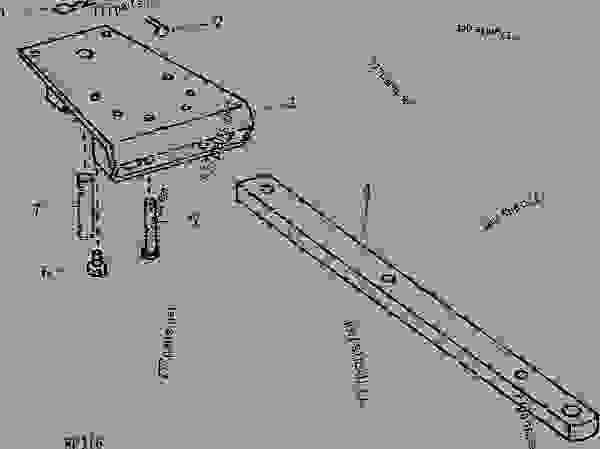

Looking for a drawbar. No longer available as original equipment. Nothing on ebay. Could perhaps make one myself but don't know the material, dimensions or tempering. If anyone knows of where to get one or where I might find specs, it would be appreciated.

Looks like a straight bar with 4 holes per 777parts.net | 404 - Page Cannot Be Found

I saw that one too, but it didn't match the configuration I was expecting.
Perhaps someone out there knows if there is a cross reference for other drawbars?

Just measured mine. It's 29" long(total) and 2" wide x 1 1/4" thick
The pin that holds it is 3/4" or a hair less.
Didn't take the ball off,but I would guess the hitch hole is over 1"
   / Drawbar for 1986 John Deere 1050. Part # CH14119.
Thanks very much. Any reason to suspect it might be hardened? Also, just to be sure, the bar is dead straight with no step and has four holes?
   / Drawbar for 1986 John Deere 1050. Part # CH14119. #6
Yes ,dead straight,4 holes,don't know why it has 2 small holes? Probably just good steel?
I see one on ebay under "Drawbar,Johndeere T29898" that would work.It's too long,but if you used the 3rd hole for the pin,it would be about the right length.

Many (most?) are hardened.

Thanks for all of your help. Turns out that the T29898 item number is the same size (except for length) as the CH14119. You would think the John Deere folks would be able to tell me that! And it was a good $70 cheaper than what I had seen for other parts similar.
