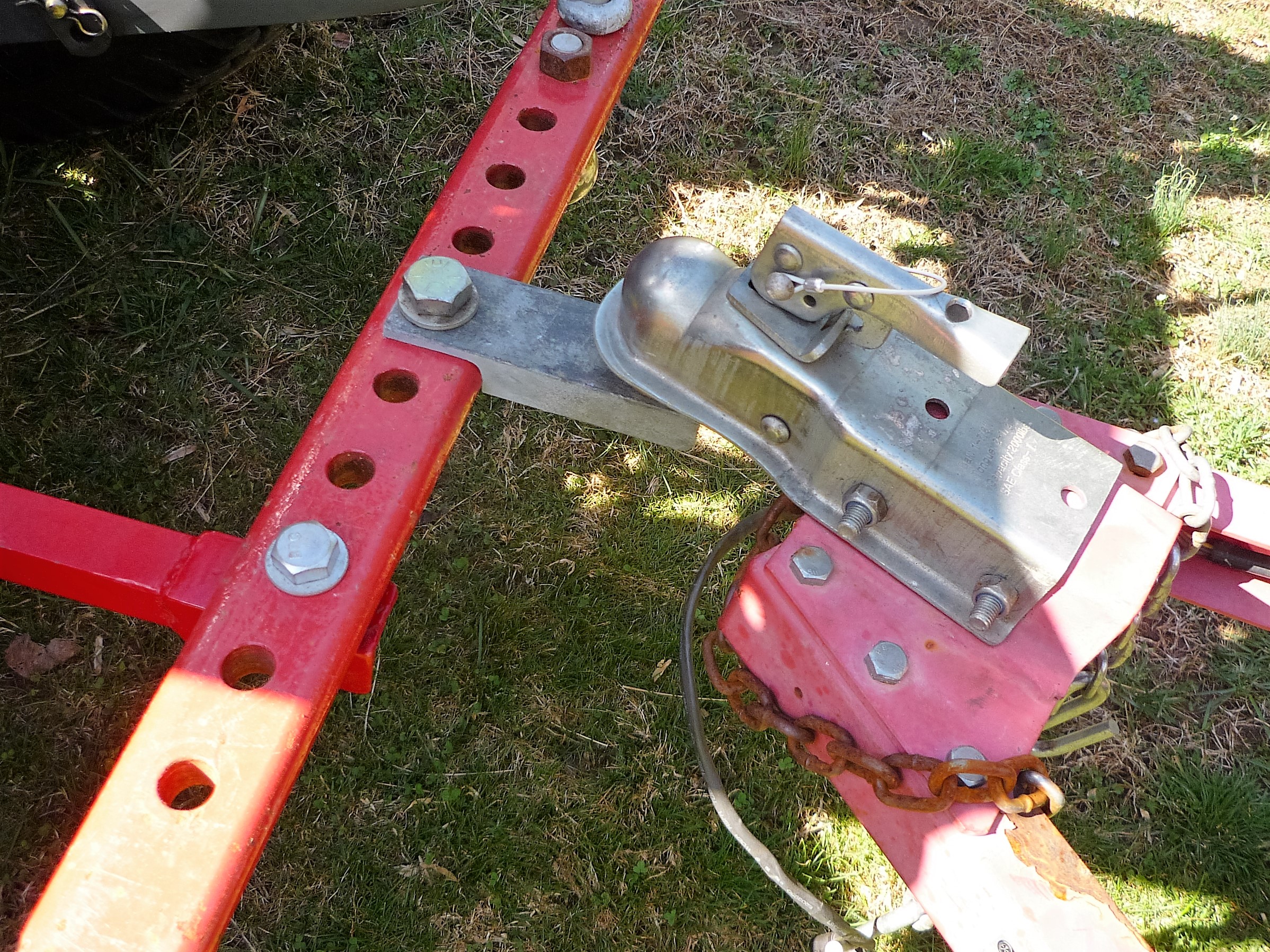

I got tired of being limited in how angled I could turn my trailer, due to the trailer itself hitting the drawbar, and rather than try to raise up the ball itself, I just set it back, giving clearance. I wouldn't do this for an on-the-road hitch, but for a tractor, it seems fine. Problem solved.

I welded a square tube receiver on the drawbar part and a 2 and 5/16 on top of the top link position. one trip down the drive and I can pull the hitch I want off a truck and be ready to move whatever.
