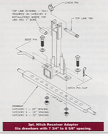

I built something similar to this and like it. The receiver came from Grizzly and the rest was out of the scrap pile.
Even with the toplink style, you still need to adjust it through the range of motion. I have a pretty good feel where that is for the various trailers so I just set it before connecting.

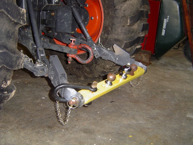

At the top of the page is Pat's ezmover that bolts to the draw bar and the top link. The price seems reasonable but I am pretty cheap so I made one for my tractor. I made several tools that fit the hitch. Spot sprayer, clevis hook for pulling stuff and trailer ball. I guess that I am not pretty but I am cheap. big dan

Redbug said:
I stumbled across a post by BrianCd with his ingenious answer to a drawbar lock. I did the same as he did. Besides you can use the "U" bolt for other uses as well...I attached a couple pics on my tractor...
Credit goes to Brian for a smart common sense answer...Here's Brian's thread...
http://www.tractorbynet.com/forums/...bar-lock-solution.html?highlight=drawbar+lock
From the look of the first picture it appears the clevis could just swivel back and become unlocked?
I have the standard draw bar lock, the only problem is you have to use a couple of bolts so it slows you down a little.
/ drawbar lock #15
Jb4310,
Yes, you are right. It could swivel back and come unlocked. However, what I did was weld a small dimple on the top of the arm to act as a stop. If you look close at my second pic, you can see the dimple sticking up. What Brain did was attach a bungee cord to the clevis and the arm to keep it from swivelling back, also. He did not have a welder...

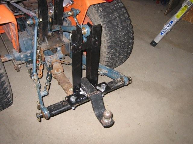

The Old Hippy has the right idea. The drawbar lock will work to a point but sooner or later you will either raise the bar and bend the trailer hitch innards (like when trying to load something on the trailer) or you will hook onto a trailer that has enough weight to bend your lock. With the 3pth toplink style and receiver you can swap out your your ball for a small work platform, winch, hoisting hook etc, just by pulling the reciever pin. I made a whole dedicated bar assembly out of 3" channel and some angle iron, complete with hooks to carry chain and a spot to load on cast iron counterweights. All from my scrap bin, except for the 8" receiver tube and the "pin ends".
If your gonna make something, do it once, right...even if you have to pay to have it welded up it shouldn't be as much as an EZY mover.

I decided to go with the toplink version. I didn't want to spend money on it since I had plenty of scrap around so here is what I came up with. Might not be as pretty as some as the others, but it will serve its purpose.

Looks good to me, pretty nice scrap. How do people live that don't have welders? big dan
/ drawbar lock #19
dvan, that's what I had pictured in my mind.
The part from TSC is designed to work with the larger draw bars. Mine is smaller and therefore has some slop in it. When towing my trailer the ball bounces back and forward slightly. I'm going to return it and then print a photo of dvan's and go to my friendly neighborhood welder. :)
