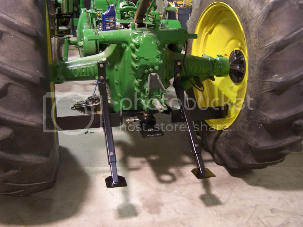

If you ever get to a tractor pull, notice those tractors have "wheels bars" attached to the backs of the axle to prevent that which you are worried about.:

I’d hate to trust those bars to prevent a backflip!

they might just sink in the mud and you would still go over
Depends on his terrain. Bottom plates could always be made larger for softer ground.
Ya think he'd rather have nothing as opposed to these?
   / Drawbar pulling question #39
Exactly what they're made for.
I guess one would have to see them in action to be secure with their workings.
