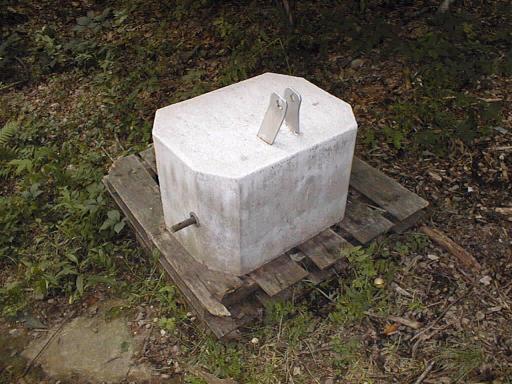

Folks,
This is my first post in own/operate as I just got my BX2200 yesterday. I have the FEL and may need additional back weight. Others have suggested the 3 pt hitch box or scraper blade but I really don't have a use for them.
I seem to recall a post where someone put free weight plates on their drawbar. Seems like a simple and cheap solution. Except I am not sure what a drawbar is. I looked at NorthernTool and they I am guessing that the drawbar goes between the two sidebars on the 3 pt hitch. Is this correct? And also has anybody used this method? Thanks for the help.
Phil
   / DrawbarQuestion for BX2200 #2
Phil, this is one of those cases in which there are two "drawbars" and I think they need a new name for one of them.
<font color="blueclass=small">( drawbar goes between the two sidebars on the 3 pt hitch. Is this correct? )</font>
That's correct, and that one is generally referred to as just a "drawbar".
Then there's the drawbar that is usually attached below the differential housing and sticks straight out the back for pulling trailers and other implements. It's usually referred to as a "swinging drawbar" presumably because on some (but not all) tractors it can be swung off center to either side and locked in position.
The one between the two lower links is the one you want to hang your weights on.

   / DrawbarQuestion for BX2200 #5
I made a weight similar to the ones I posted for use when backhoe is removed. (Do not know the original posters name of the pictures. but thanks) I used a 22 gallon rectangle plastic storage bucket with a 7/8" rod 27" long. Two 1/4" x 3" x 18" long plates with 7/8 hole on one end and 3/4 on the other. With 3ph on tractor and arms all the way down put bucket on two 2x4 to keep it off ground. This will ensure you will not be dragging it if you put 3ph on lowest setting, it also will give a low center of gravity. Then position it were you want it and mark for 7/8 holes. Cut holes and slide bar in one side and put 1/4 plates on bar then slide thru other side of box. Attach to 3ph and attach top link to 1/4 plates to hold in place then center everything and tie it in place with some string. Put some wire screen in bucket to hold concrete together. Move 3ph up and down to check for clearance so that nothing will hit or bind, you only get one shot at this. I also put a 2X4 frame around outside top of bucket to keep it from bulging the bucket out that’s a lot of weight pushing on the sides. I used 5 80# bags to fill bucket that would give you a 400# weight. Let set for a day and either cut the bucket off or leave it on. You should be able to make this project for about $30.00. to remove lift up weight and set it back down on something a little taller than the 2x4s to relieve weight tension on arms. Maybe you can find an orange bucket.

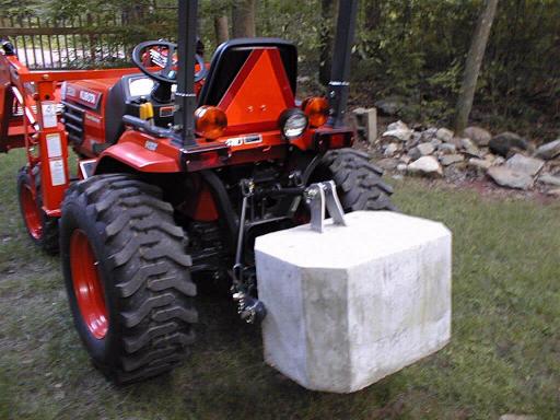

   / DrawbarQuestion for BX2200 #6
This is the other picture

   / DrawbarQuestion for BX2200 #7
If you don't want to make something, you can buy a JD or Kubota weight box that fits on the 3pt. Probably around 150 bucks.
I got a JD one thrown in with an implement I purchased from my dealer.
You'll definitely want some counter weight while doing loader work, otherwise your back-end will get light.
A lot of people say hang a box blade or other implement off the back. I prefer the weight box (homemade or purchased) myself. It has a smaller profile than a blade - so you don't have to be worrying about swinging the blade into something.
Folks,
Thanks for all the help. I still like the simplicity of the free weights on a drawbar if I can get it to work. Steven, your weight is fantastic. Thanks for the pics and description. I maye tackle that once it warms up around here.
