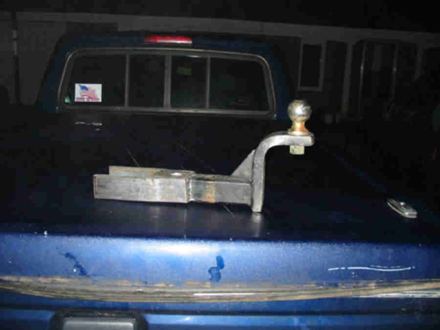

I have heard these stories before as well and they all make sense to me. Thus, I just built, though I have not used it yet, a hitch like the attached photo. If you look at the chains you will notice that they will prevent the load from riding up on a quick stop. You are still using the drawbar, in this case with a receiver bolted to it. Seems like a good safe compromise to me.
Kevin

Here's a good way to fabricate a combo trailer ball and drawbar hitch. Dennis made this one to fit his machine. I'd post mine, but his looks better !
