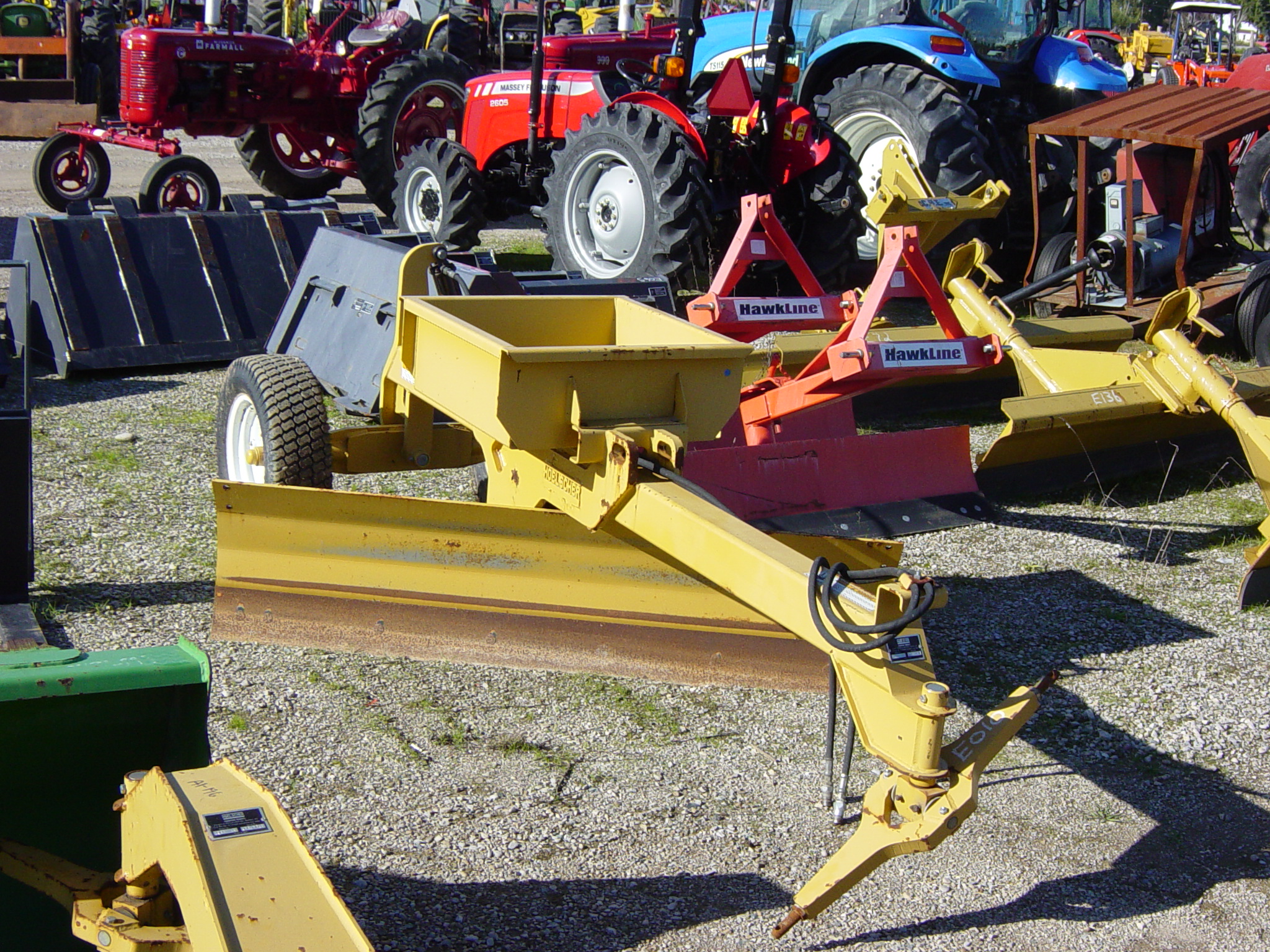

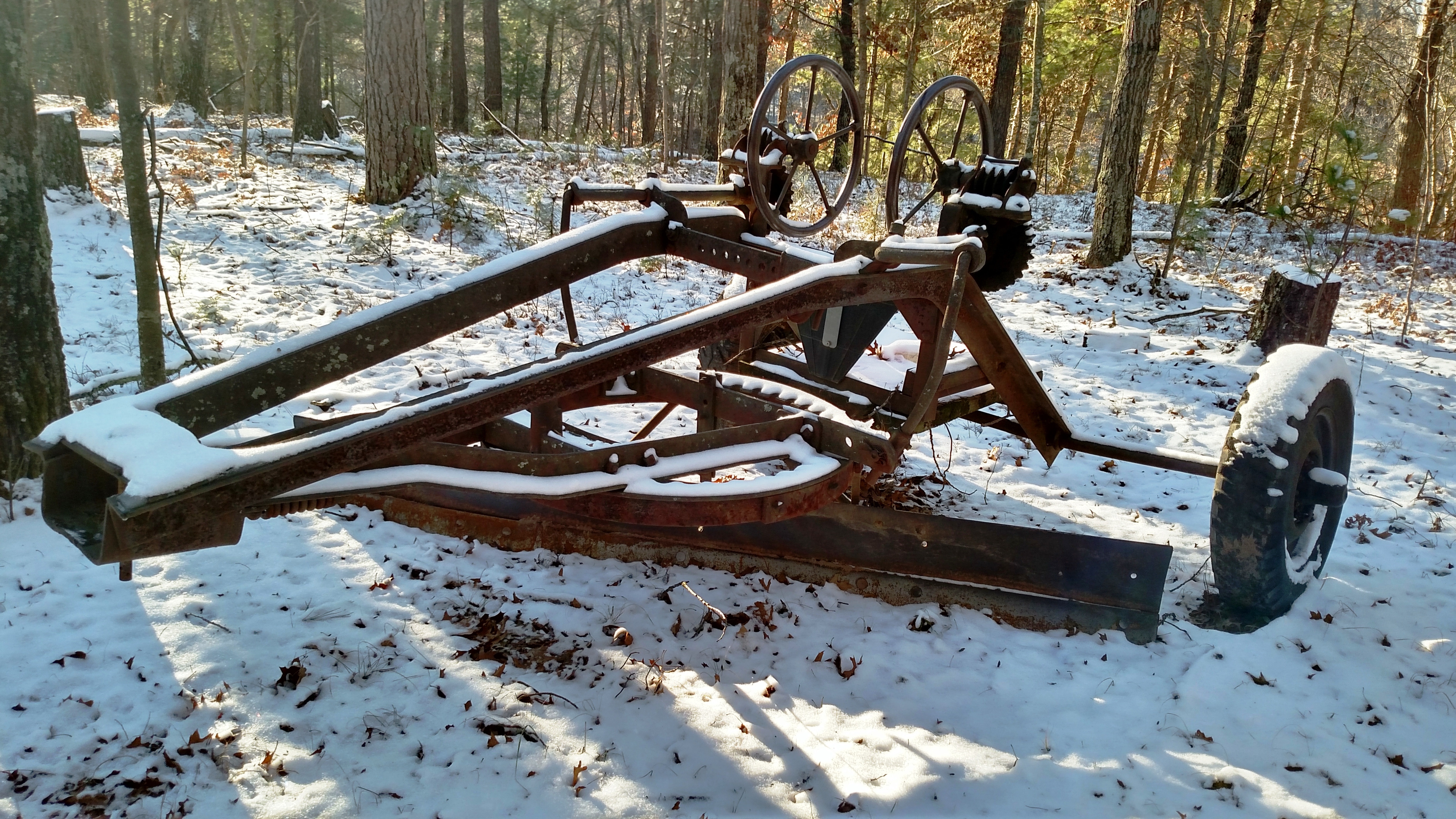

If your only doing this once in a while, just build a adjustable gauge wheel for your blade, as for the adjustable moldboard angle on the hygrade some have it as a option , but I don't think it would be a factor for you not to have it in loss gravel.

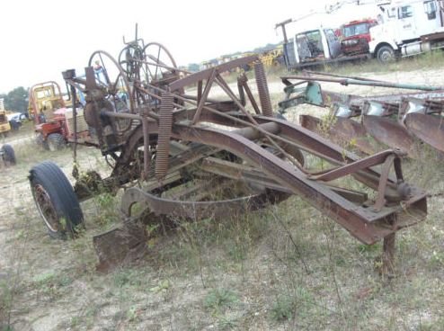

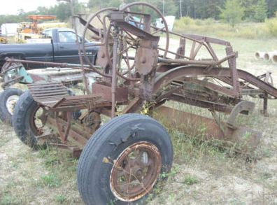

Man up and build an Adams No. 8 copy using a retired NH, JD, or NI hay rake.AdamsNo8-1.JPGAdamsNo8-2.JPG

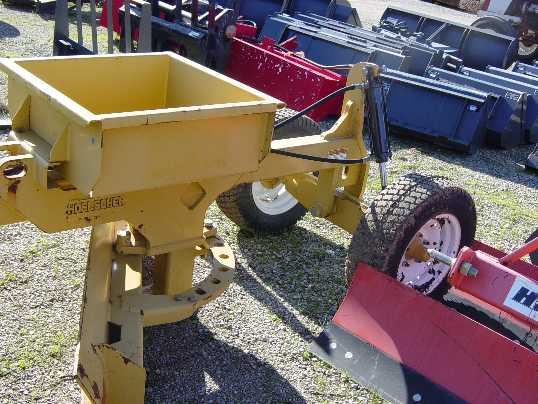

I like either option
1 - tail wheel
Or Option 3 - Trailing 3 point for interchangeable Implements. A rear axle from a FWD car and re-worked truck frame would do. You could model it after this.
