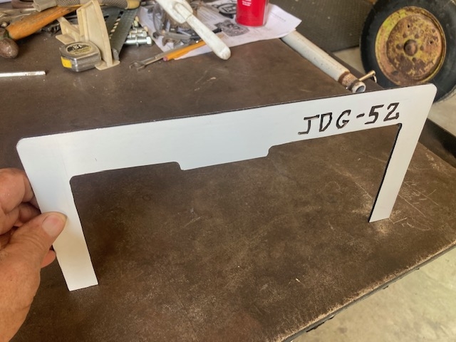

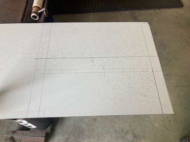

Over the weekend, I transferred the measurements to a 1/8" section of Plastic/Aluminum composite material. Using a jigsaw, I cut out the larger area. I then performed more precise cuts using a bandsaw.
It worked out well. (y)
