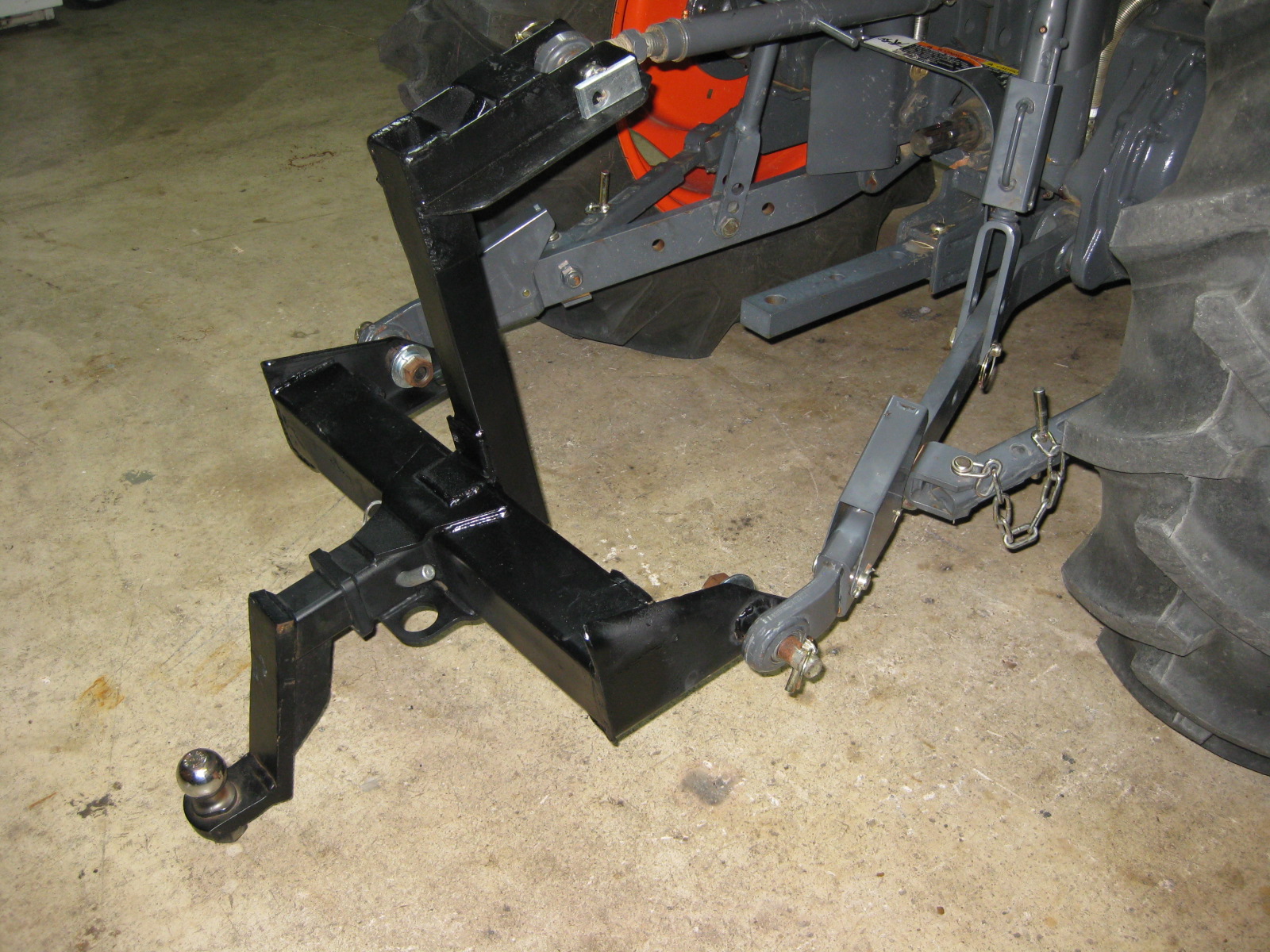

Thanks for the replies everyone. Sorry for posting on Kubota ops forum, but its something for the Kubota I thought to put it here? I am lazy and I have made a hitch moving trailers and I needed to drill some exact holes and didn't want to plasma cut them and dang if I could not find a sharp bit out of the entire bunch I had:mad: Want to make an arm to latch the trailer hitch to the ball WITHOUT getting off the tractor:D
