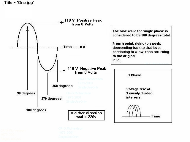

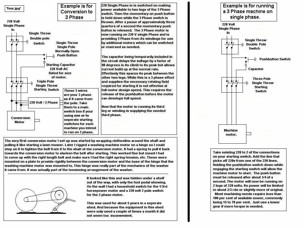

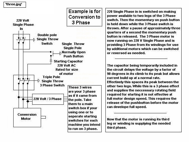

Dullpain,
THANKS for that simple ilucid illustration and explanation on how to. I knew that you could, but have never understood the principles behind it. Until now. Thanks.
Here in Poland we have 3 phase coming into almost every house. They use it for water pumps and other things. In my main panel box I have 3 phase 380 volt. 220 volt 50 hz x 3. But I have always been curious about 3 phase in the States and now I understand more. Thanks again.
Mike

/ Drill Press electrical question... #23

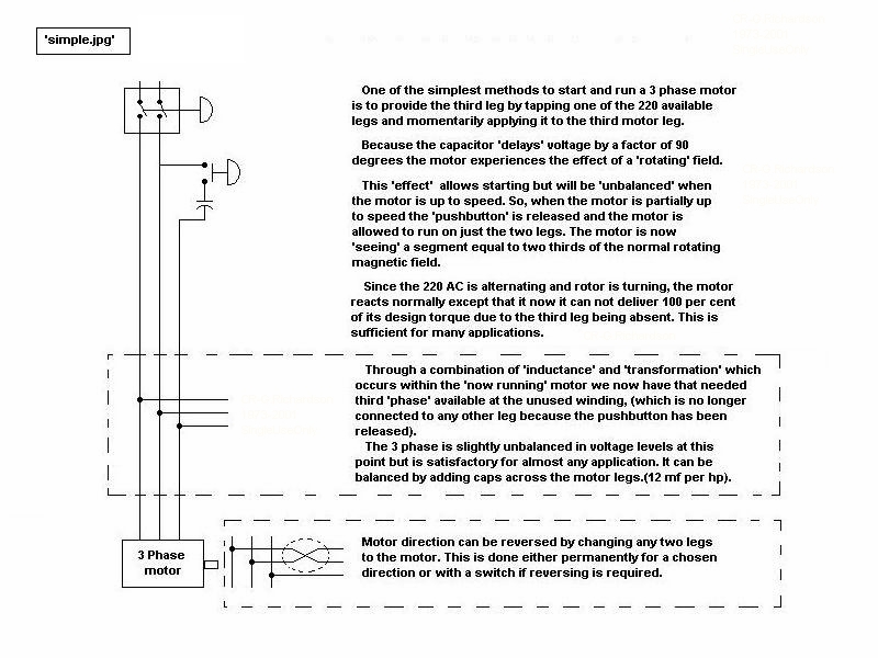

I did not see anyone explain this so if it was I aplogize. Motors need some kind of twisting force to start turning. Generating plants all generate 3ph power. Alternating current with a voltage curve that looks like a Sine wave, going from plus voltage to minus voltage at 60 cycles that 60 times a second. 50 cycles in Europe. To simplify the explaination there are 3 windings in the generator with the Sine waves for each starting 120 degrees apart , When this set of 3 waves ( voltage aside for the moment) is made available at a motor, the magnetic fields created by the windings in the motor create the torque to spind the motor. This is why 3 pase motors are very simple have very high starting torque and can be reversed by switching any two windings. Single phase is created by a transformer on the utility pole one phase to ground. The secondary windings create two waves but they are 180 degrees apart. No starting torque NON. Single phase motors
need some other method of creating starting torque. A third winding disconnected by a centrifical switch after start up or a capacitor etc. So a 3 ph motor cannot run on 220 single phase as it is. However if you can provide a starting twist they will run on 220 1PH. They are various method to do this all already mentioned.
For 3 ph voltage can be almost anything as long as the motoe windings are matched to the supply. 1PH is , as far as I know in the US 110 or 220.
220 wiil run a 208 3ph motor no problem derated a little
/ Drill Press electrical question... #24
dqdave1 said:
3 phase motor will NOT work on single phase.

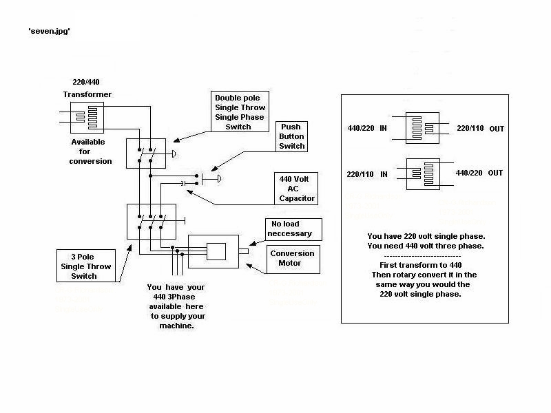

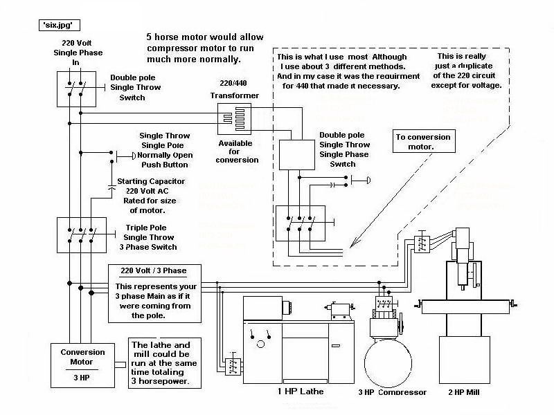

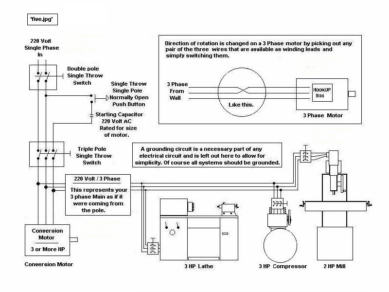

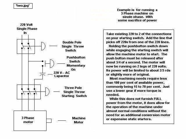

Yes it will, it just won't start. I run all my 3 phase machines off a three phase motor that I rope start to generate a third leg for the other machines.
/ Drill Press electrical question... #25
yup that works I used a washing machine motor , a vee belt and a timer to start my 3 ph motor. It becomes a rotary converter. The third phase is induced by the motor. I have never been sure of the phase angles but who cares ,it works. It behaves just like a 3 ph supply ,you can reverse motors and all. The only thing is not to use the induced phase for any control voltages like contactor coils etc. I need a spell checker

One of the problems with trotting down to Harbor Freight, besides spending USA dollars on Chinese crap, would be one thing that 3ph motors have that make them superior to single phase. That is being able to reverse directions while at speeds. So if you have a drum switch on your drillpress and the drill breaks thru but hangs up, a flip of the switch and it backs itself right out. Never have seen a single phase motor that can do that more than a couple times without damage.
David from jax
